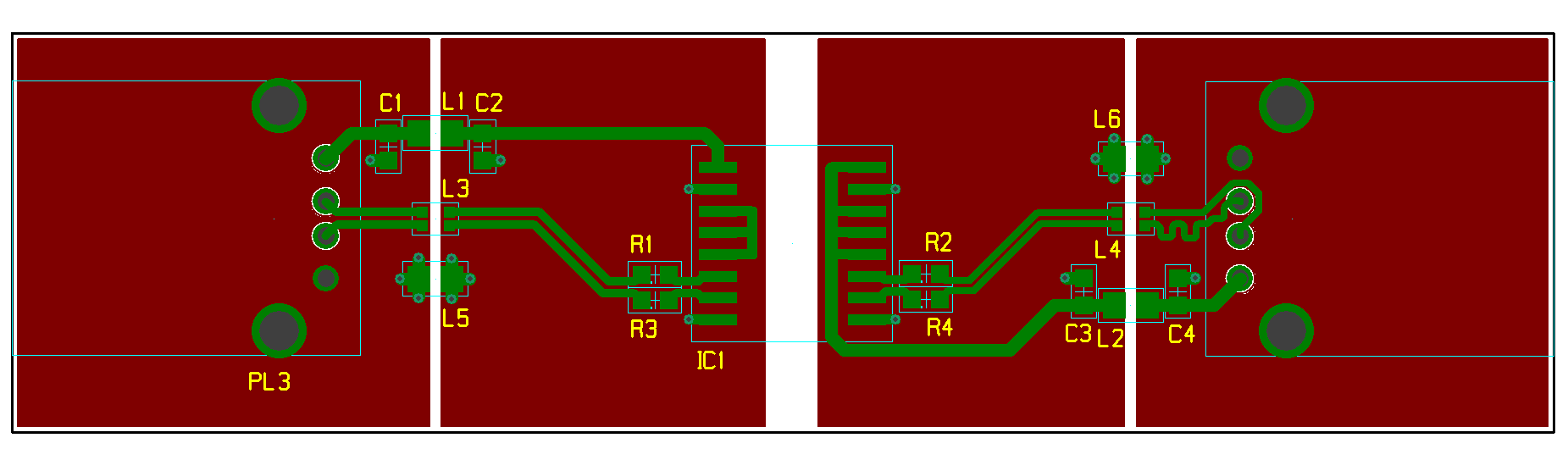

A picture, haven't done my own USB hub (done plenty of other peoples USB hubs though), but considering doing a complete USB hub design with LDO regulated 5V based on the SMSC USB2412 USB hub controller as used in some Audiophile USB hubs, they all have fancy names though so must be better than a hub LOL
This is just a basic design done for something, could use beefier caps and inductor for the 5Vs but as most of the noise is likely to be HF not strictly needed and wasn't for this application. One caveat is you have to be careful of to many CM chokes in the USB data lines can cause signal integrity problems, this is not such an issue when using a ADum device as you have a max speed of 12MHz so you can tailor the rise time to limit the high frequency spectrum and keep the knee frequency down adding further benefits of reduced ringing and overshoot due to minimising the harmonics in the digital USB square wave...

Curious that they got the pinout such that you need to incorporate trace length equalisation ?.....This is just a basic design done for something....
Dan.
Its a to b a crossover signal from one connector to the next for USB, a pain but its better to have differential signals length matched otherwise again signal integrity and system noise will increase....
Its also a simple two layer design so easy for people at home to play with, I do believe the PCB is less than 1.5mm to get the correct characteristic impedance for the USB lines.
