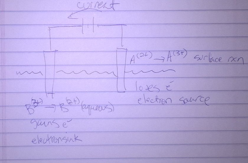

current flow requires a loop. That is what "circuit" means. A route for current to flow around. All the current leaving a Source MUST RETURN to that Source. That is a LOOP !

A battery, whether charging or discharging, is a normal circuit element and so fully subject to Kirchoff's laws. You push electrons into one terminal and the same number of electrons comes out of the other terminal; the circuit insists on that. You need to start from that fact, and then work out whatever electrochemistry is consistent with that. Don't try to start with the chemistry, as chemistry is fully subject to the laws of physics. You don't have isolated electrodes in a solution; you have two electrodes in a circuit.

There is always a return path, otherwise there is no current flow, just electrostatic waves if there is a potential difference between two points.
I'm not a chemist, much like I'm not an electrician.
But here goes.
Charge (or battery voltage) is an accumulation of opposite charges either side of a boundary. Those charges came from within the source (battery or capacitor) that was one half of the circuit. The charges initially moved to create the voltage/charge.
Connect an external circuit and the current will flow. It flows from the source and returns to the source. That flow and return is around the external circuit and the internal circuit. There's your loop/circuit.

I have a grasp now of the battery charge and discharge. What I am talking about is aqueous electrochemistry. Way off topic, I know, but might as well try again.
I have attached a picture of the setup in question as I understand it now. I mislabeled the ion charges but it makes no difference for the example. Please let me know where the loop is.
If there is no reaction at the right side electrode, charge conservation is not possible via the reasoning a few posts back about creating electrons
If you add a ground along with or instead of the right side electrode, the charge conservation problem still exists
