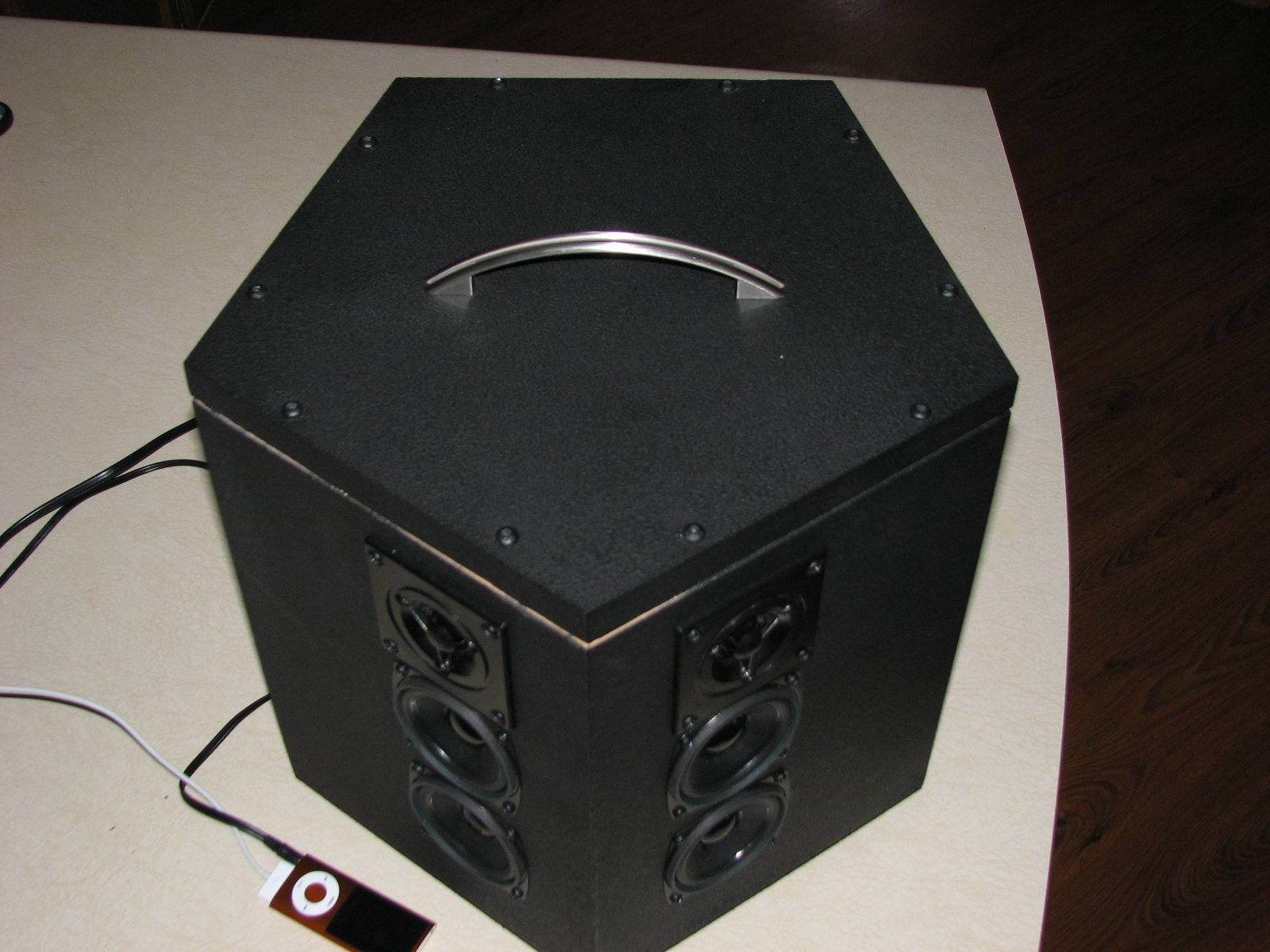

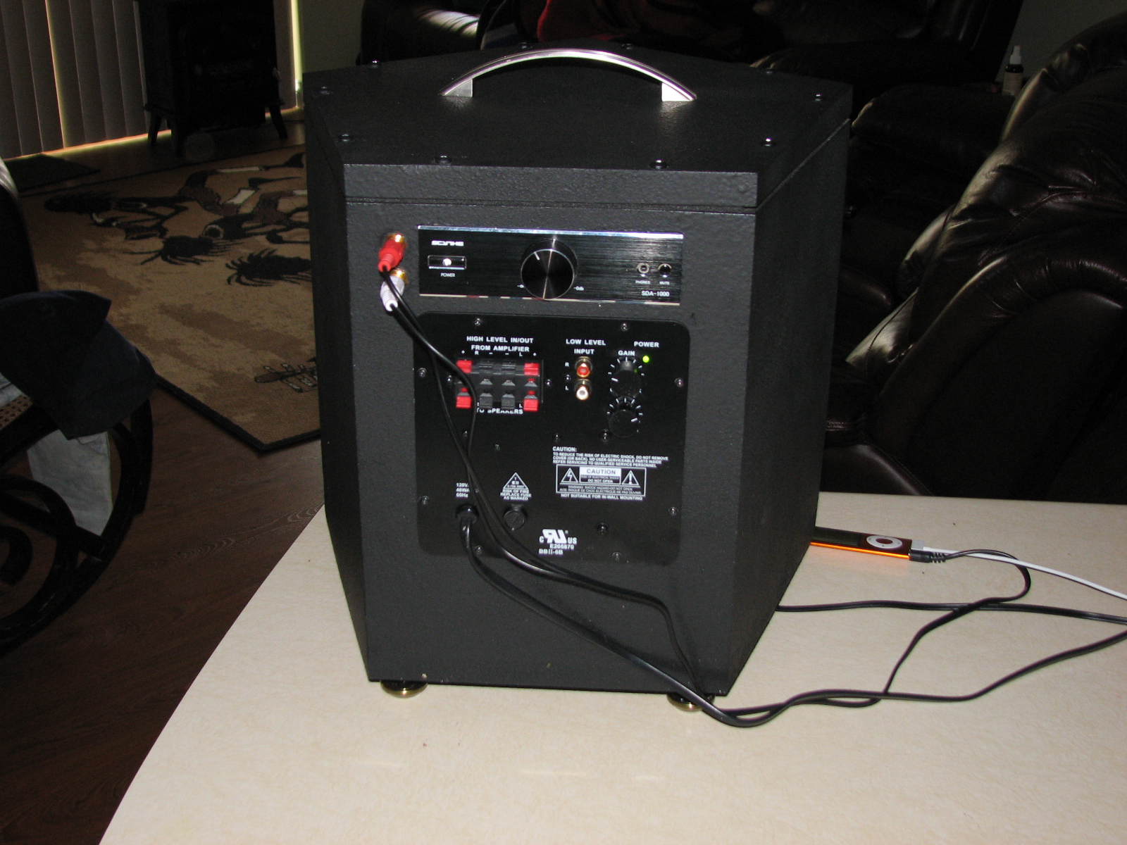

You saw my octagon boxes, here's the pentagons. I wouldn't think about using the good wood until I've done small mock ups with scrap. There's no reason or excuse for having bad mitre cuts. Sorry, no pics of the finished product, but close enough. It's not hard to do it right.
