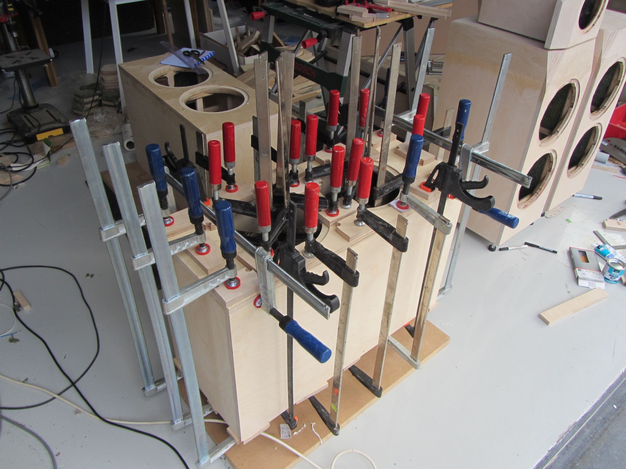

Oh yes, and CLAMPS! You can't have too many clamps!
I usually use just two. I use corner blocks so the clamps are only there to hold the wood while I fire in the brad nails. Makes for very fast construction.

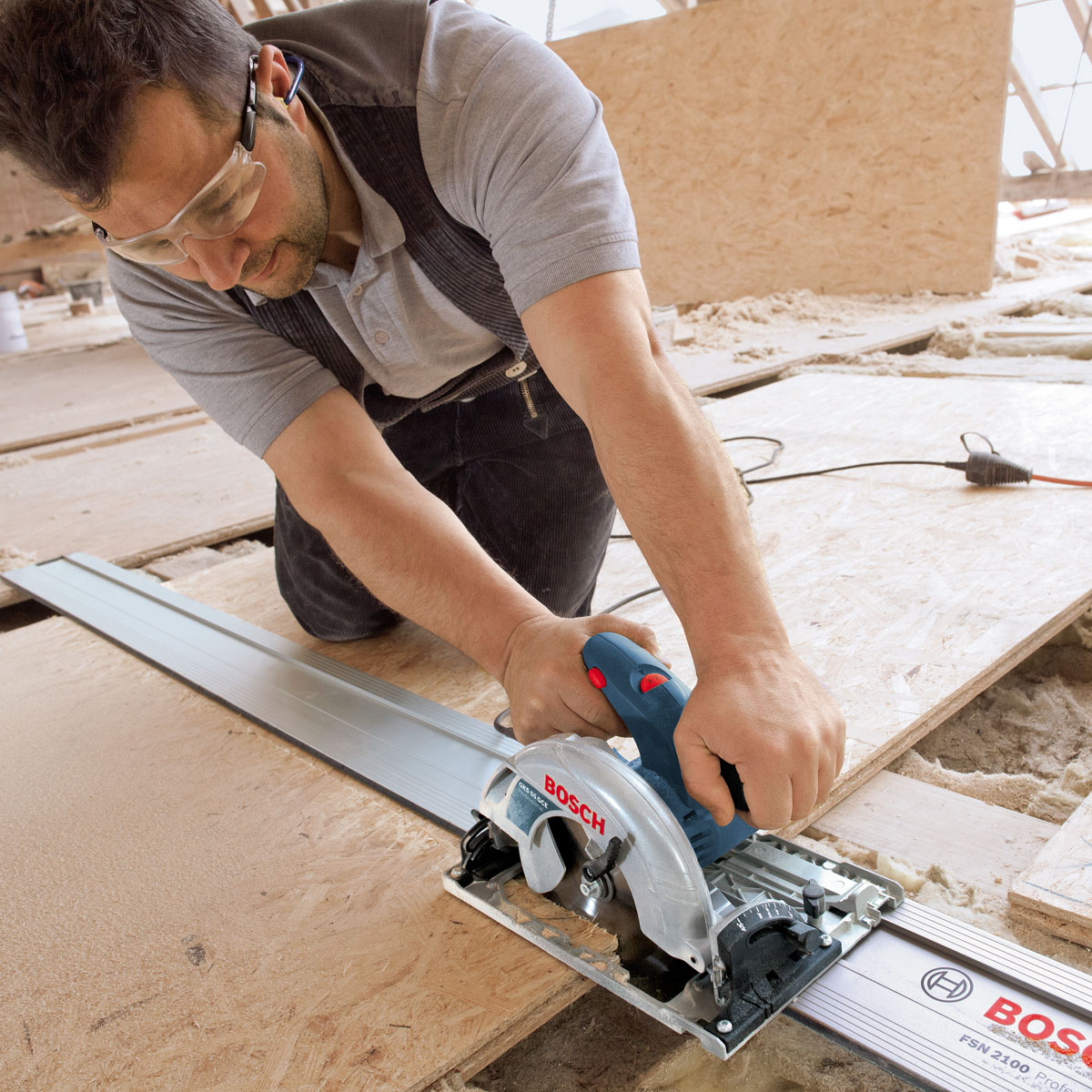

I find a professional circular saw with a rail system much better than a miter when sawing has to be precise.
With the circular saw and rail I get 0.5mm or better precision.

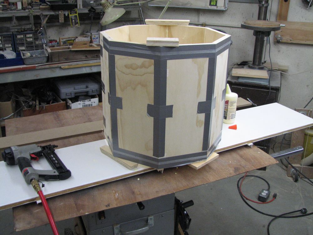

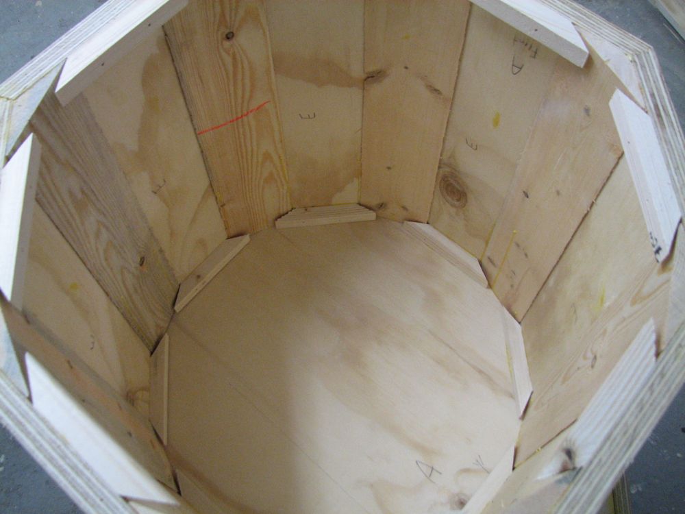

You guys will note my use of duct tape as 'hinges' and fiberglass tape as the clamps in post 46. You do what you have to, to make things work right? I then added the inside joint supports just for the fun of it. Those inside supports were some tough cuts on the saw. Had to bring out the rip blade and be creative. They started out as 2x4's.
Yep, by whatever means possible. It is surprising what will actually work, often using very little by way of resources. Especially money, the less the better. Or should I say, spently wisely.......at PoundLand DIY 🙂

Clamps?? A flat surface with peg holes and wedges at about fifteen degrees are all you need. If you need a special clamp a board with end stops and a pair of wedges will do.
I like the Jorgensen 3/4" pipe clamps. For large projects I have ten foot long pipes. But normally three footers. I find the 1/2" versions slip.
