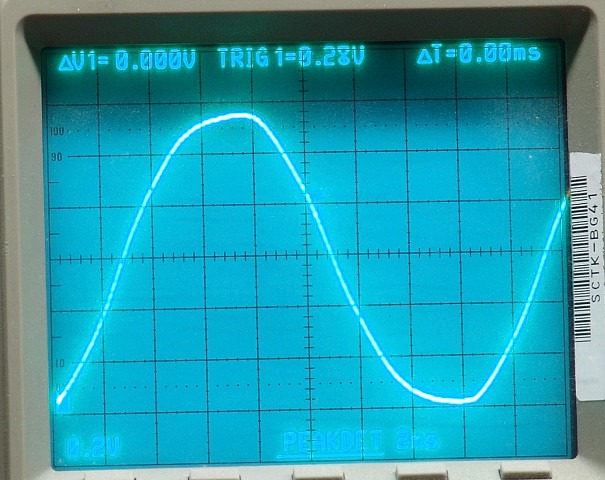

The line power in Florida varied from about 3% to over 10% in THD depending on the time of day and the outside temp. Worst case was about 6 PM on a hot summer day. Visible transformer saturation could be seen on the scope trace. The picture shows a 5% THD day.

In the case of the picture in post #25 the 6600 ohm P-P OPT is rated for "80 VA @ 42 Hz" (guitar amp use). It was putting out 2.26 watts @ 60 Hz and showed a THD of 5.something % (the picture is grossly out of focus, but looks like 5.2 or 5.5%). All of the saturation seen in the picture is the pole transformer in the backyard or others upstream from it. This was after FP&L had replaced the old steel cased pole transformer with one of the new plastic cased junkformers. We had better quality power before the swap which occurred because of a lightning strike.

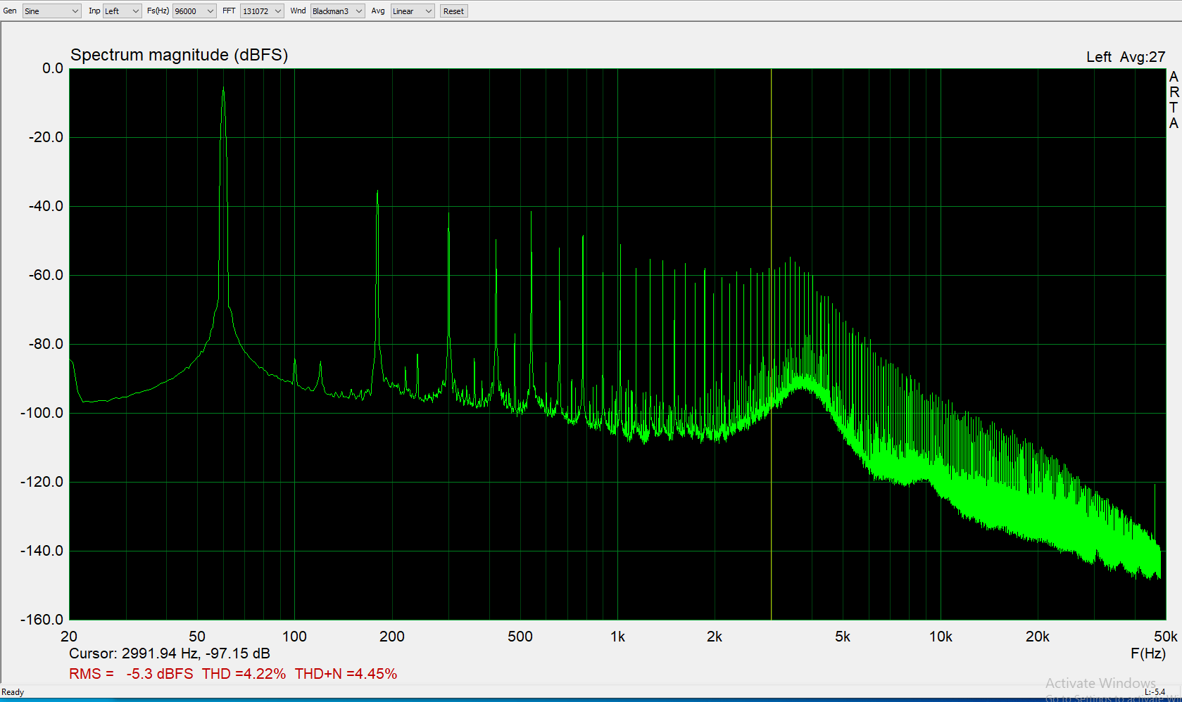

I spent some time chasing down the random odd frequency lines on the FFT spectrum a year or so ago. Some are from the line power, but most of them are from the PC and it's monitor as many lines moved when I swapped LCD monitors around. Several more lines come from the LED lighting, with the Walmart LED shop lights hanging over the workbench responsible for a 0.2% increase in THD on a quiet amp. (0.1% THD). The Comcast box (wired internet, router, landline phone, and WiFi internet) on top of the bench (the highest point in the basement) is also a significant contributor, as is the cordless phone plugged into the Comcast box.

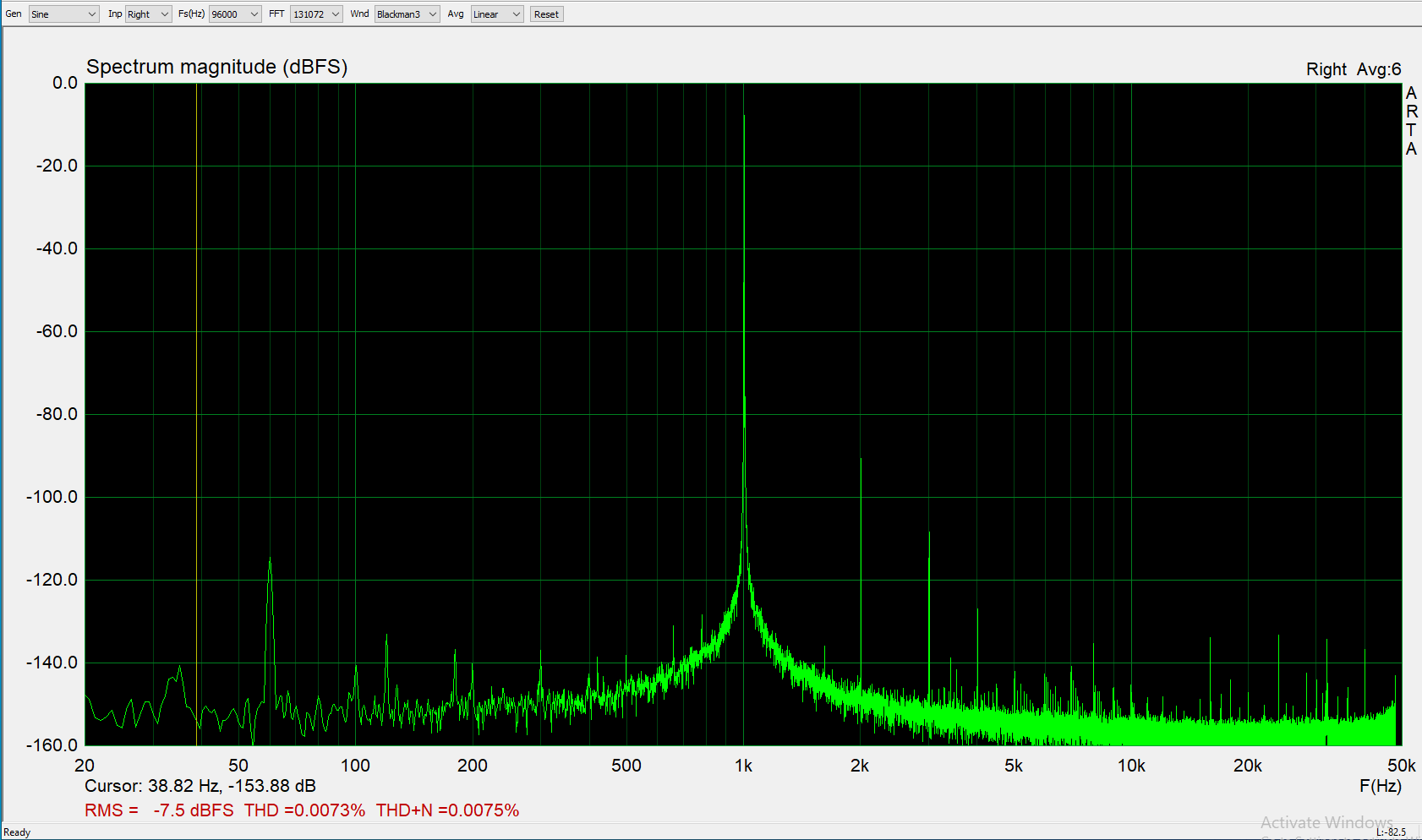

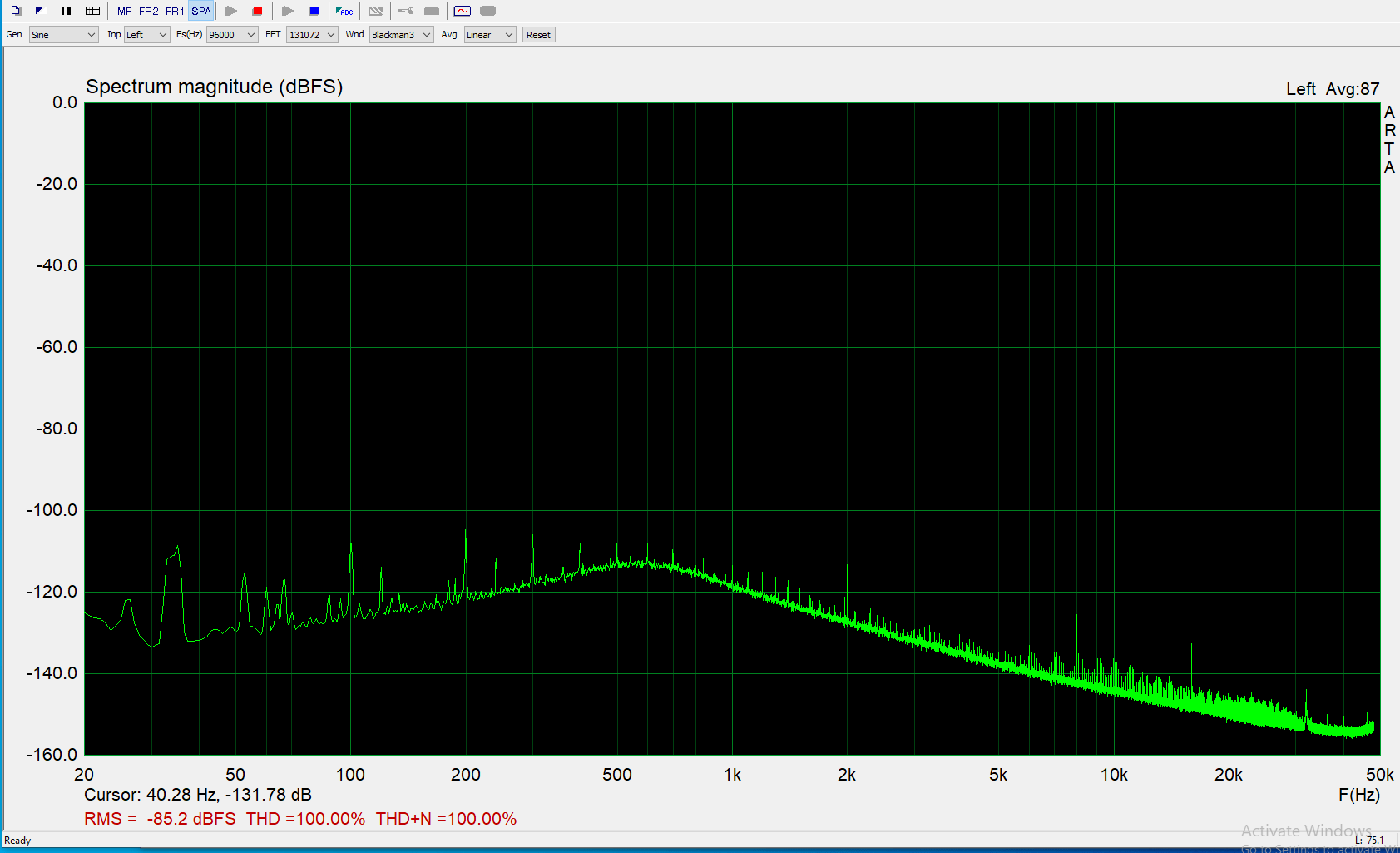

One of the issues I hgave been having is that almost all of my FFT scans are plagued with high levels of noise. I had a Viktors 1KHz low distortion oscillator in an aluminium box with a Notch filter, and saw high noise with it. So I built a new 35V power supply using UF4007 diodes instead of 1N4007s, and used a 2.2uF first cap followed by a 220Ohm resistor and then a 1000uF cap. This was followed by a LM317T regulator with 1000uF on the output. This looks reasonably quiet, but the oscillator output still has what I think is too much noise.

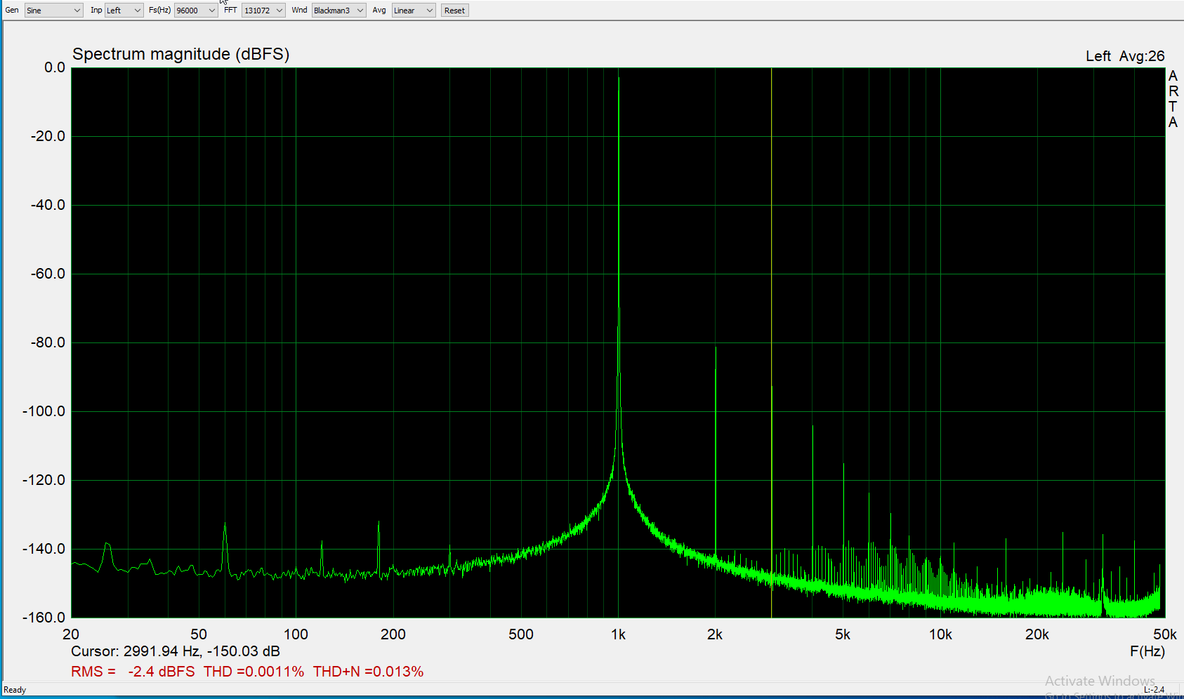

Beyond that, when I run the ASUS in loopback it looks good.
But every external oscillator I measure shows high distortion as the Viktors in the previous post, and the AkitikA, second attachment in this post.
I made an Akitika oscillator a few weeks ago and whilst I didn't see 2ppm distortion, I figured the 5ppm I did see was probably the residual of my dScopeIII test set. Looks like your test set is not locking well to an outside source. Have a look at the triggering. You may be triggering from the internal generator rather than the input signal.
As for mains RF interference. It's terrible, but I found low CPS (capacitance between primary and secondary) mains transformers block it. Flat tops and 3% distortion is entirely usual.

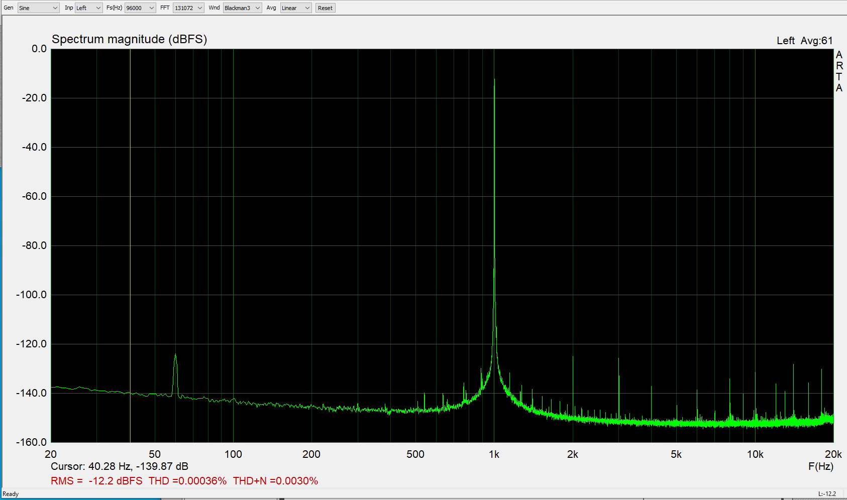

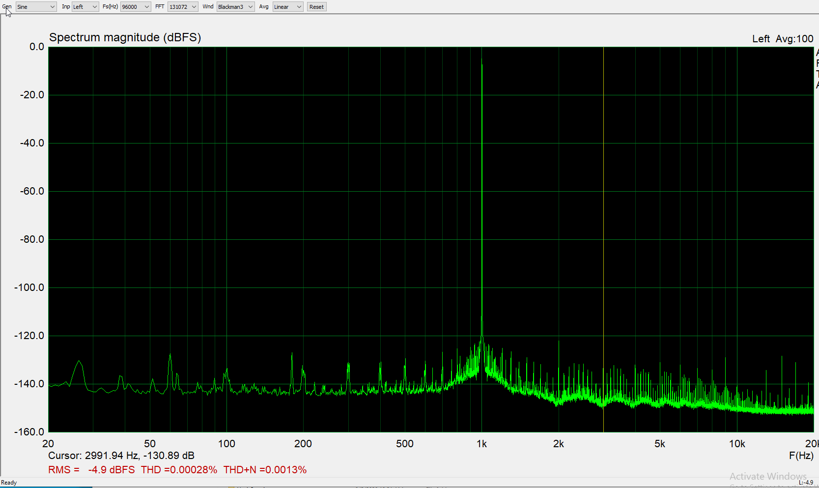

Today I un-installed the Asus Strix RAID DLX driver, and removed the card from the computer. I then located and installed a driver for the E-MU 0404 (finally found it stashed in with some old DVDs and CDs) and hooked it up. I then connected the Viktors Low Disstortion 1KHz oscillator to the Mic/Hi-Z/Line input and after some twittling of settings was able to get what I think is a reasonable scan with 0.9Vrms in to the E-MU0404 mic/line input.
As expected, the line noise is mostly gone.
The interesting thing is problem 2. I now show low THD in the expected range with the Viktors LNO.
Why would the internal sound cards (two models and three different cards) show low internal loopback distortion, but higher distortion when driven from an external source while a USB system does not? And how do I fix it?

TheGimp,
I have not followed all the posts in this thread, but . . .
Digital links like USB normally do Not have significant effects from ground loops, 1s are still 1s, and 0s are still 0s.
Significant ground loops with USB will cause All the data to be corrupt, and the system will fail.
Go or No-Go.
Analog signal connections (analog links), are always nearly so, or are always nearly not.
A low amplitude ground loop does not totally destroy the signal, just rides on the signal.
Spectrum analyzers and FFTs can show extremely low amplitude un-desired signals.
If you look under the rug, you will see dirt.
Does that sound like what you are observing in Post # 38?
I remember my first look at a spectrum analyzer screen, that was in 1971.
I have been looking at dirt ever since; it often was my primary job in manufacturing, engineering, marketing, and in technical support, now at home and at friends labs.
In the time domain, often the signal looks really clean, but in the spectral domain, we often see what keeps us awake at night.

1. High noise in measurements.
2. High distortion when using an external oscillator, where in soundcard loopback I do not see same high level of distortion (2nd and 3rd harmonics and higher).

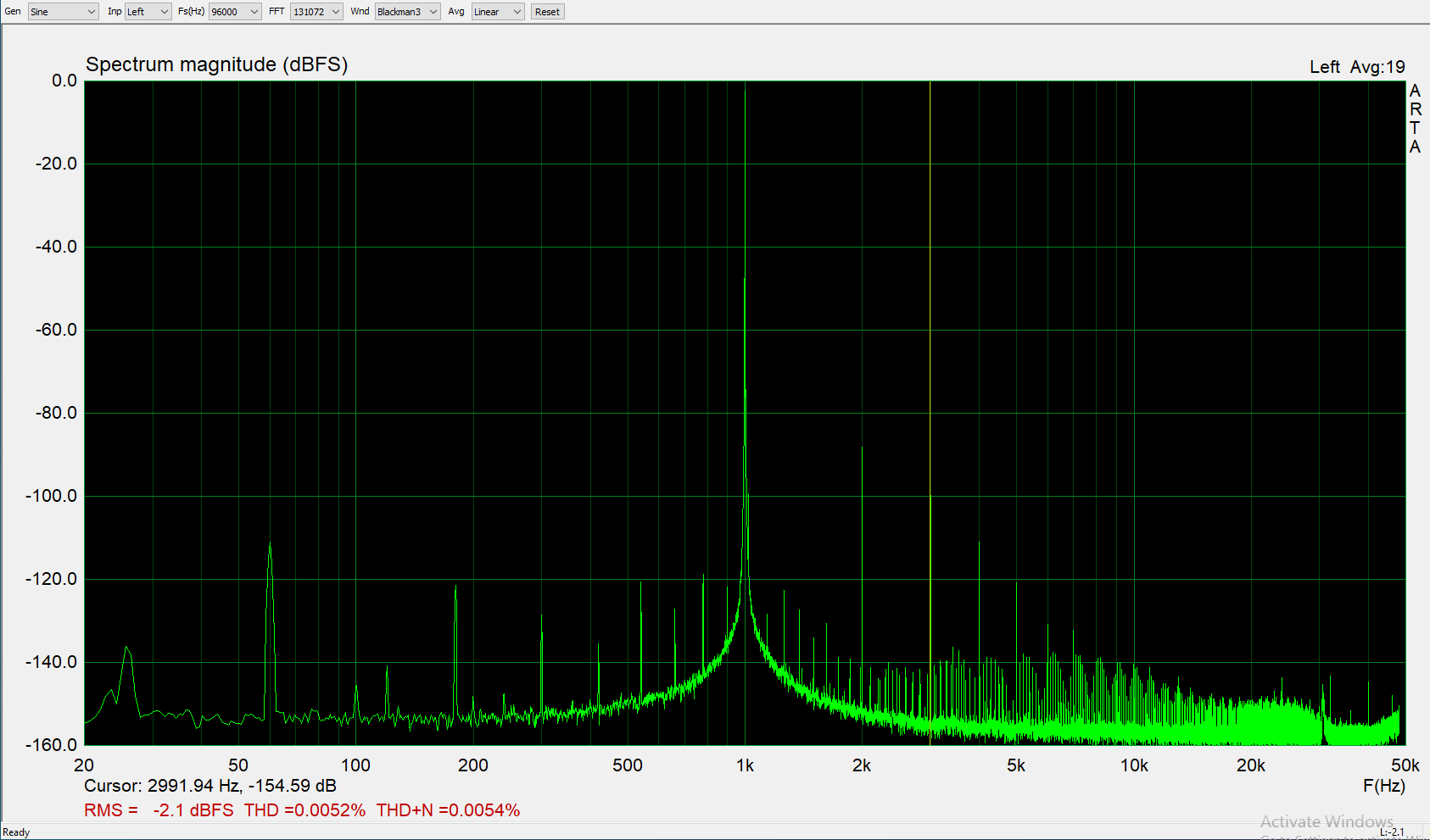

For 1. Here is a scan using the Strix RAID DLX in loopback showing 60Hz and harmonics somewhat below-120dBfs (Baseliine_Loopback.png). Not exactly clean but not terrible.
The second scan is an external Low Distortion Oscillator (Akitika) as the source.
Notice the high amount of 60Hz and moderate level of high harmonics. This source is run off batteries, so no conducted noise(?).
