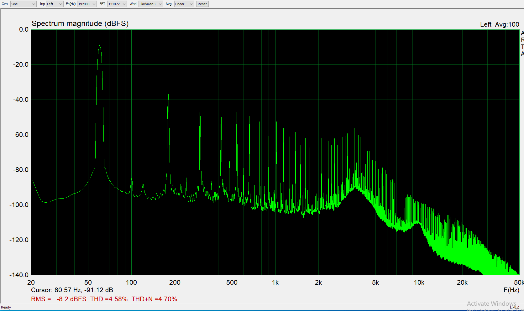

Next we see conducted line noise measured from a 2.5VAC seprp down transformer through a resistor divider to prevent over driving the input to the sound card.
I suspect the noise in post 40 are due to the internal switching power supplies in the computer. Not much can be done about that.
The second attachment is using the Viktors LDO driving the Strix Raid soundcard. Noise is terrible. Power is derived from a FWB followed by 1000ufCap and then a LM317 regulator. Isuspect ground loops are allowing noise into the system.

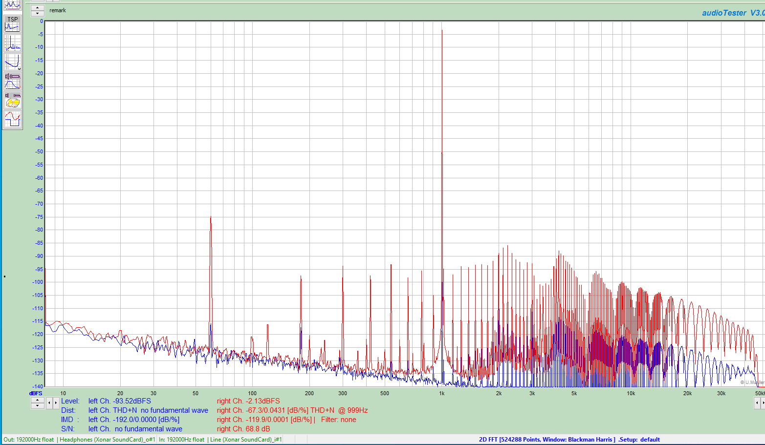

So I dug out an E-MU0404 to test with.

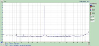

With the E-MU404 (USB) I get much cleaner scans. This is the same oscillator as the second scan in post 41 (different software program AudioTester 3D vs ARTA but different FFT programs show the same results).

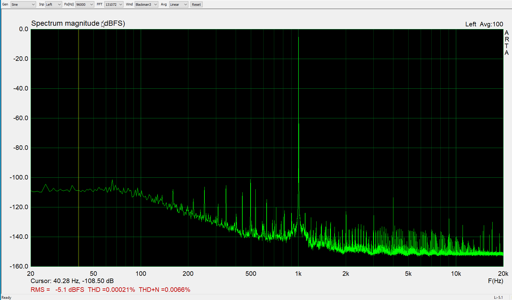

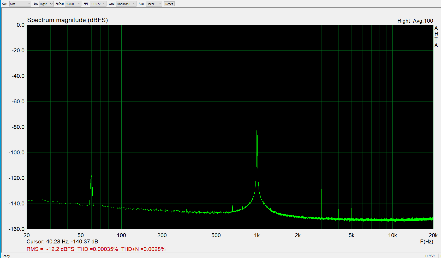

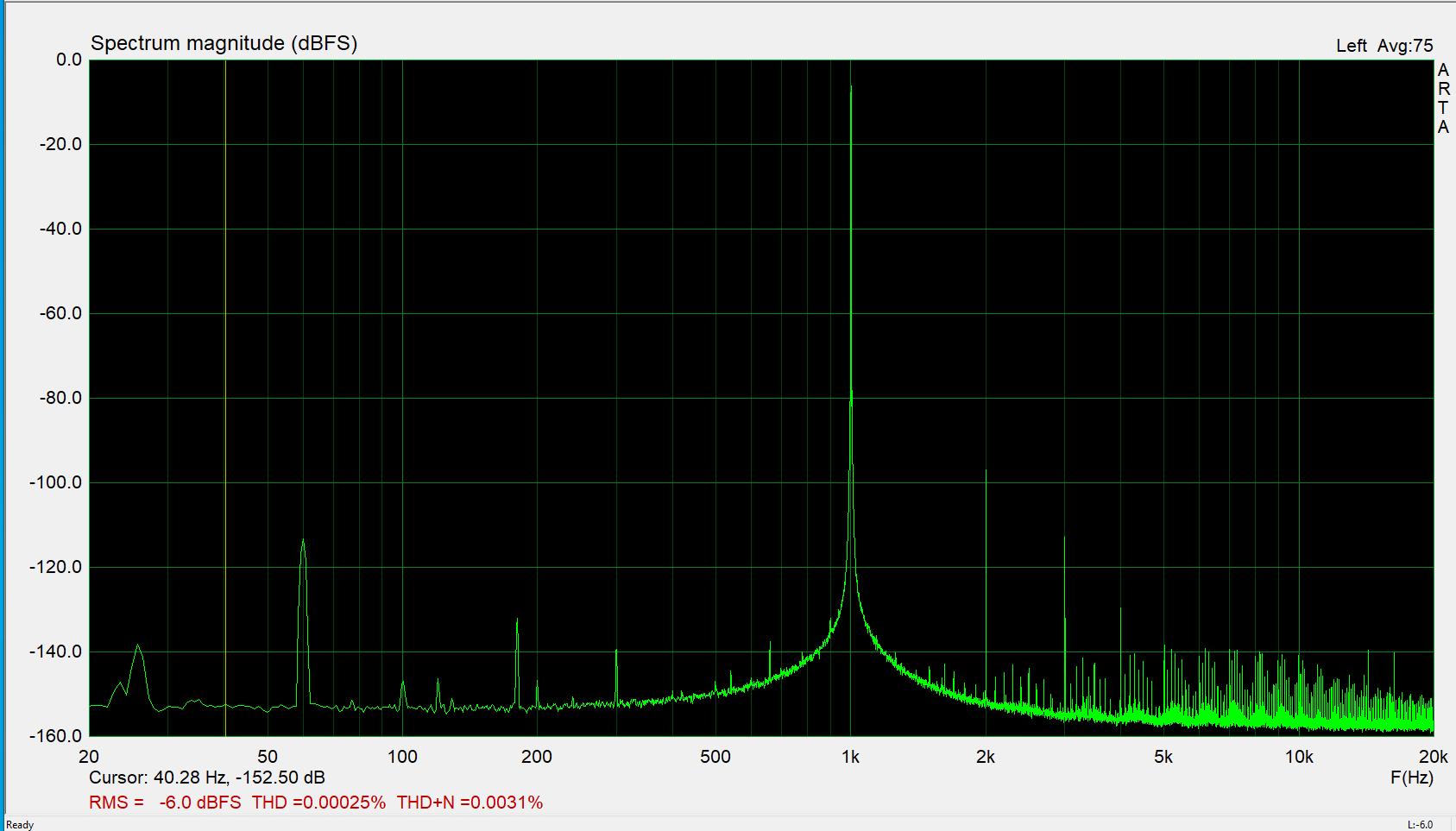

Looks like it is ground loop issues. I installed the STRIX sound card and re-ran the tests including loop-back which looks pretty clean except the LF noise floor.
First is loop-back, then Viktors LDO, and finally Viktors LDO removed from the aluminum enclosure (which broke the ground).
