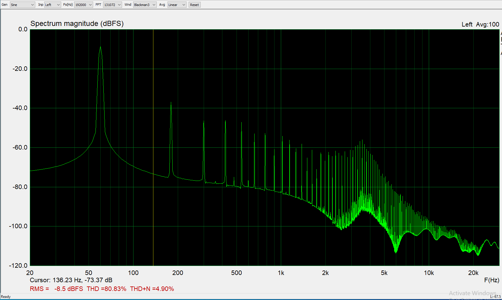

I have been plagued by what I felt was power line noise in my FFTs of amp circuits for some time.
Some have stated it was IMD, which to some degree it looked like, however I was convinced I had power issues greater than IMD.
To that end I am going to investigate power line noise from my mains, and power supply noise from simple SS rectified circuits which I was using to power a low noise (Victors) 1KHz oscillator which exhibited high background noise.

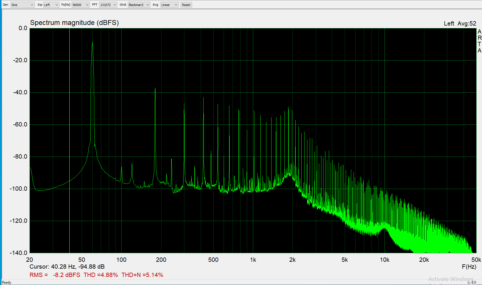

First up is a simple scan of powerline noise made using an FFT (ARTA) program, of the output of a 2.5VAC CT transformer (Triad F-6X) through a resistor divider (470R-470R) to prevent overloading the sound card front end.
Not a pretty sight, is it? This has been filtered (to some degree) by an isolation transformer which is used to separate my test circuits from the rest of the house system.
Next I will try using a line filter to clean up the mess.

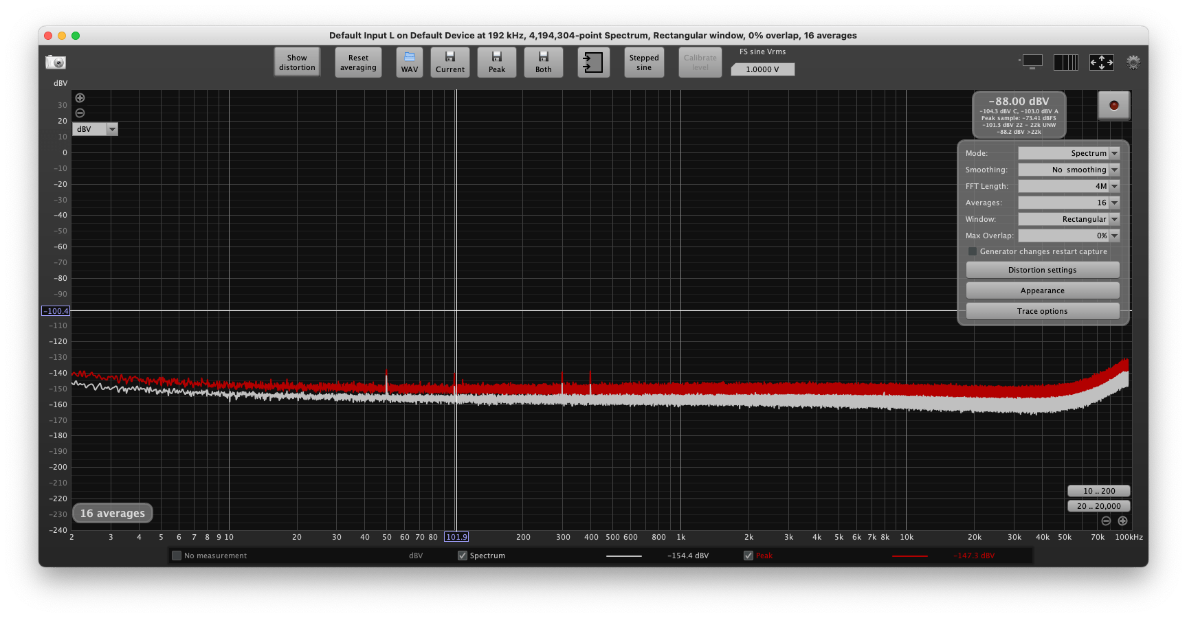

What does the scope show further up? (An alternative is go noise hunting with a tinysa).
I still get an annoying 50Hz mains spike which I suspect is through one of the bench supplies via the clock prototype. This project has made me a bit of a filter/noise junkie. Below - I used LT3080s on the input, with shunts, and with ferrites in pi filters (600R@25MHz and 20R@25MHz) but ground loop removal make a large difference (-27dB)

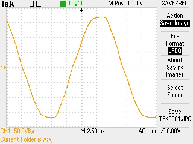

Other than my strong preference for using electrostatic shielded transformers (which isn't always easy to get) I have absolutely no power line filtering. Magnetic coupling with standard steel is sufficient filtering.
A good power supply could care less about the spectrums you have shown, and it doesn't need to be exotic, just designed with standard engineering principles.
Apparently most of the crap you see is 60Hz harmonics. You would need to zoom on the highest part of the spectrum, but anyway, a 60Hz Xformer is not good at transmitting high frequencies, except if it is a toroidal.
Non-PFC supplies can create an harmonic spectrum like yours (including linear ones, to a lesser degree)
Your small transformer could significantly contribute to the mains harmonics, because such transformers operate partly in saturation. A way round would be to put the top resistor of the divider in series with the primary (properly scaled, obviously), and load the secondary with the foot resistor.
If you want to see the upper part of the spectrum correctly, you can use a CMC choke as an isolation transformer: a 2x22mH for example.

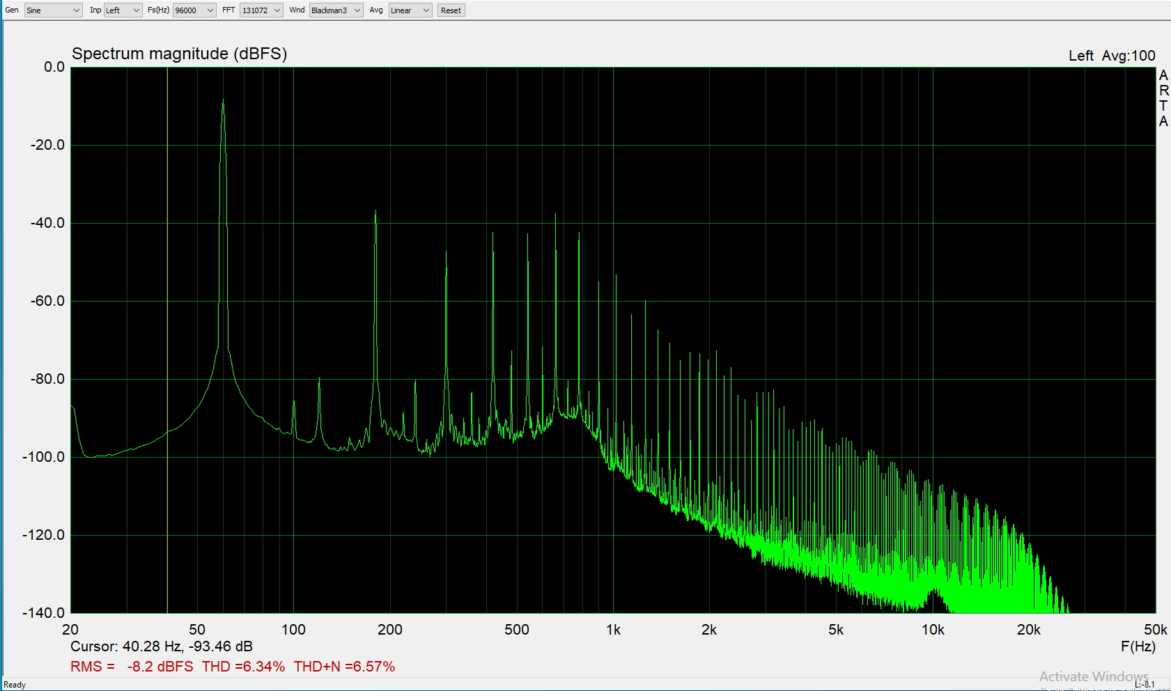

Lets start with aCorcom 1EBH1 IEC inlet filter. I got these at a HamFest three for a dollar. There is a bit of improvement above 10KHz.
The name of the file contains the filter model. CC is Corcom.

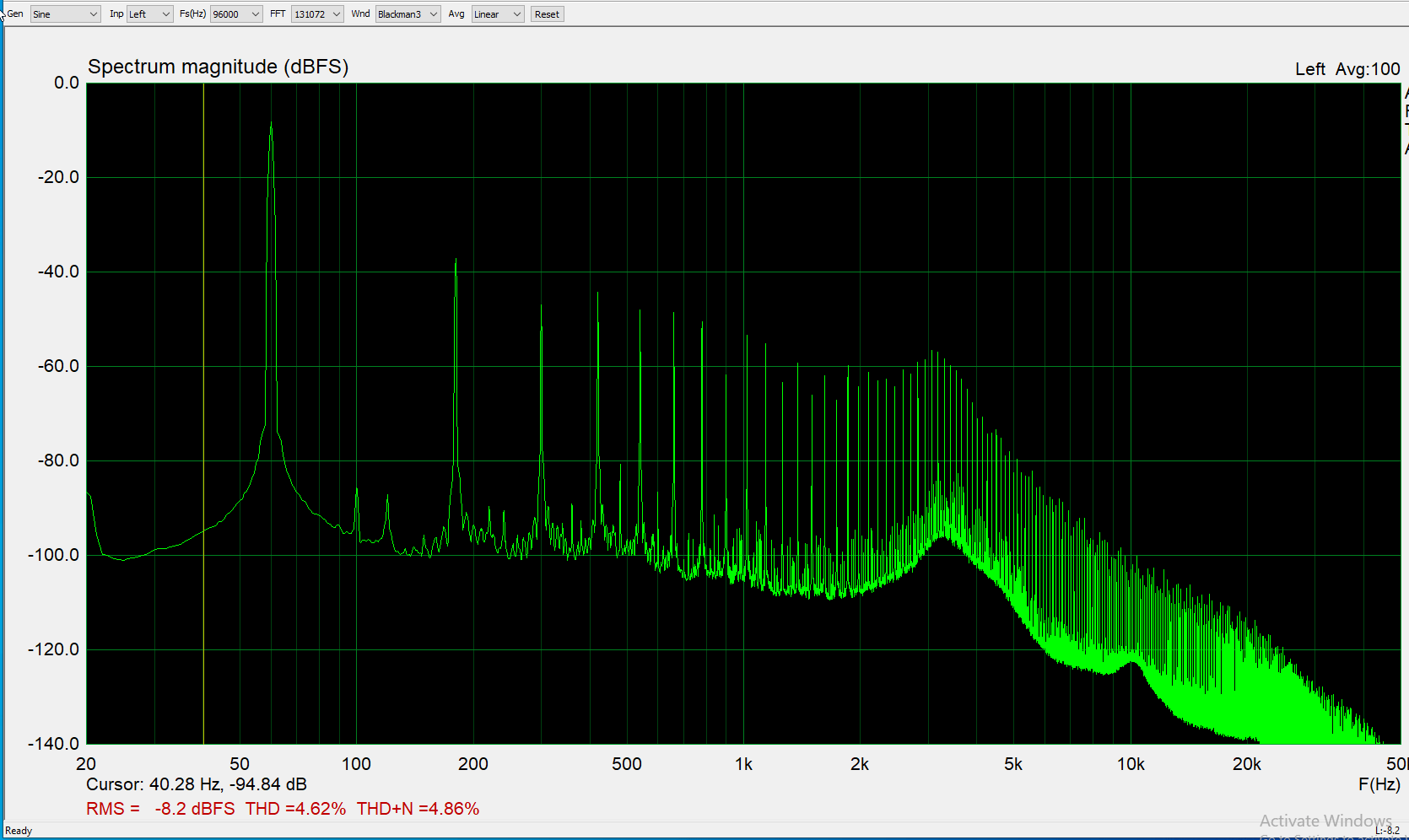

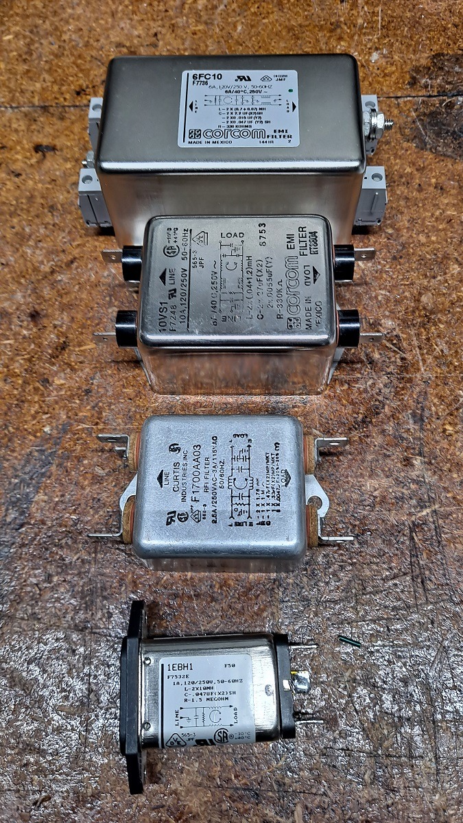

Some more filters, smallest to largest per the picture of filters.
None of the filters have much effect below 10KHz where most music content is.
Also, the physically larger the filter is, the better it performs. There is no free lunch.
The big Corcom is around $100 IIRC. It has a significant impact above 20KHz.

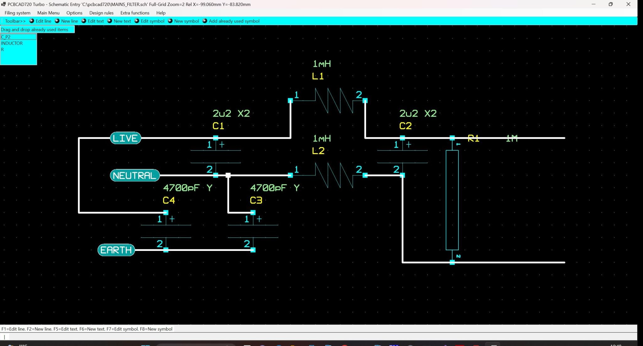

I may try building a line filter since I have a ready supply of CMC and a selection of X2 caps. I am a little short on Y caps (1, 4.7, and 22nF).
Remember that CMC's do just that: common-mode. The effect of a "good" CMC (ie. one that has minimal parasitics) on your spectrograms should be minimal, since your measurement is in differential mode.
In practice, CM and DM can leak into one another, but if you are serious about cleansing the DM, you should also add single inductors, or non-cancelling coupled inductors. Ideally, they should be used together with RC damping networks, as strong resonance frequencies will appear (in CMC's too, although the phenomenon is more subtle and is generally addressed with gas surge-arrestors bypassing the inductors, or connected to the PE when possible)
It is unlikely that a DIY filter will be performing as well as well chosen, certified and tested shielded industrial filters that may even have an IEC inlet, internal fuses and a power on/off switch. Don't bother picking one that filters in the audioband but choose one that filters HF/RF (as they are designed for). You can filter stuff in the audioband at the secondary/DC side.
