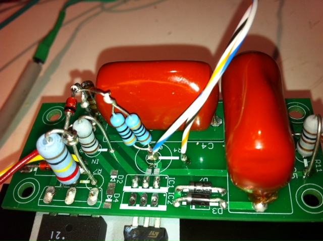

On this one I will leave D2 and D4 out. I'm also going to shunt R1 and see if I can get away with that. I did a point to point thing with D9 so as to avoid all the SMDs this time.
I saw your notes about D6 and D8 but it didn't sink in until after I had them soldered in. I understand they cause no harm so they stay in.
They shouldn't hurt as long as the zener voltage isn't lower than the voltage drop across the regulator. If so, they will release their smoke.
Sorry about the SMDs. I wanted five of these to fit in a small space in the amp I designed them for and that was the only way to make them this small.
I don't think that will happen, but without the smoke, they can no longer cause trouble. I could clip them out I suppose.
I get it about the SMDs. If it won't hurt you feelings seeing your nice board all hillbillyed up, I'll post the photos of the point to point workaround. 😱

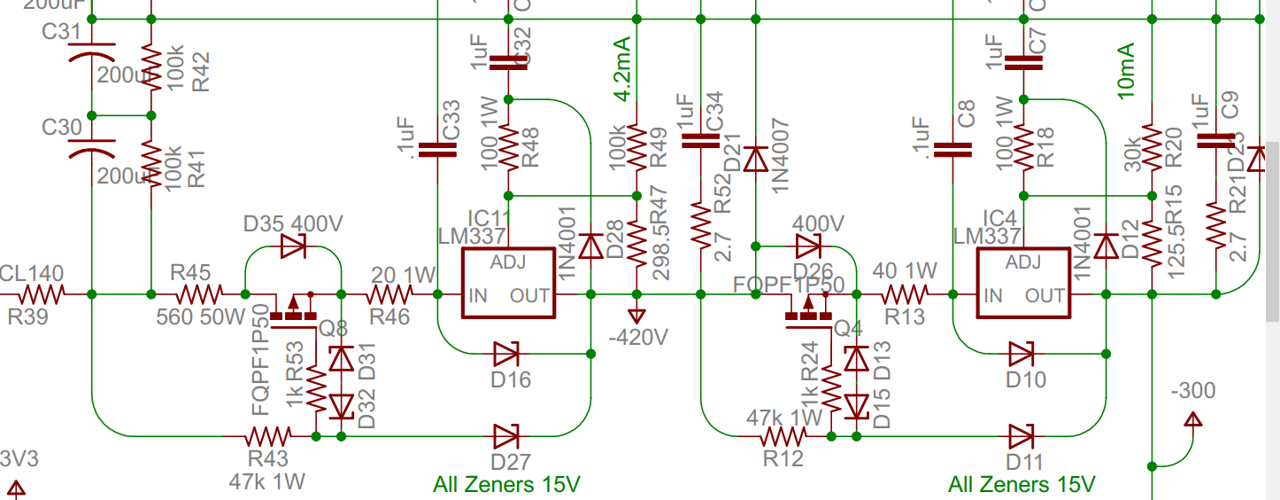

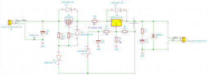

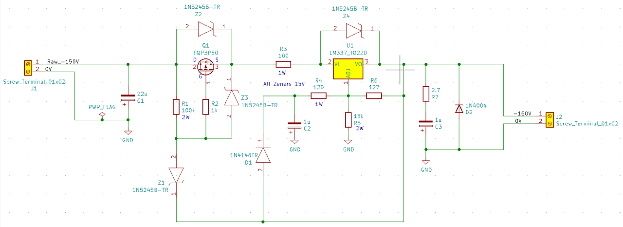

Problem with negative Maida regulator
Hi. I am building ±150V Maida regulators based in part on the schematics at post #28 (1st attachment).
My schematic is the second post.
I was so confident I went straight to PCB design and production.
Being cautious I’m running 2 tests before hitting them with ±175V
  • with ±19V and a short in place of the large value voltage-setting resistor looking for roughly ±1.25V at the output
  • With ±57V from an amp power supply I have handy and the voltage-setting resistors set for ±25V out.
The positive one passes both tests.
The negative one produces -0.8V in the first test and destroys the zener protecting the P-channel MOSFET in the second.
Thinking there might be a problem with my PCB design I built a standard negative regulator on a solderless breadboard (worked perfectly so I have the LM337 pin-out right) and then the Maida circuit.
The latter had the same -0.8V output with the -19V test. I didn’t try -57V because I have a limited supply of 15V zeners.
I’ve triple checked (more!) the pin configuration of the P-channel MOSFET.
Does anybody have any suggestions for something I’m missing please?
