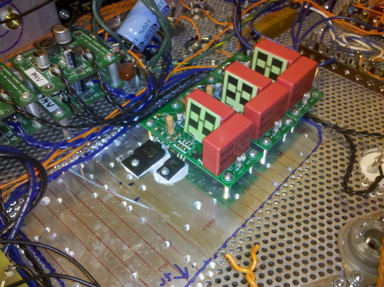

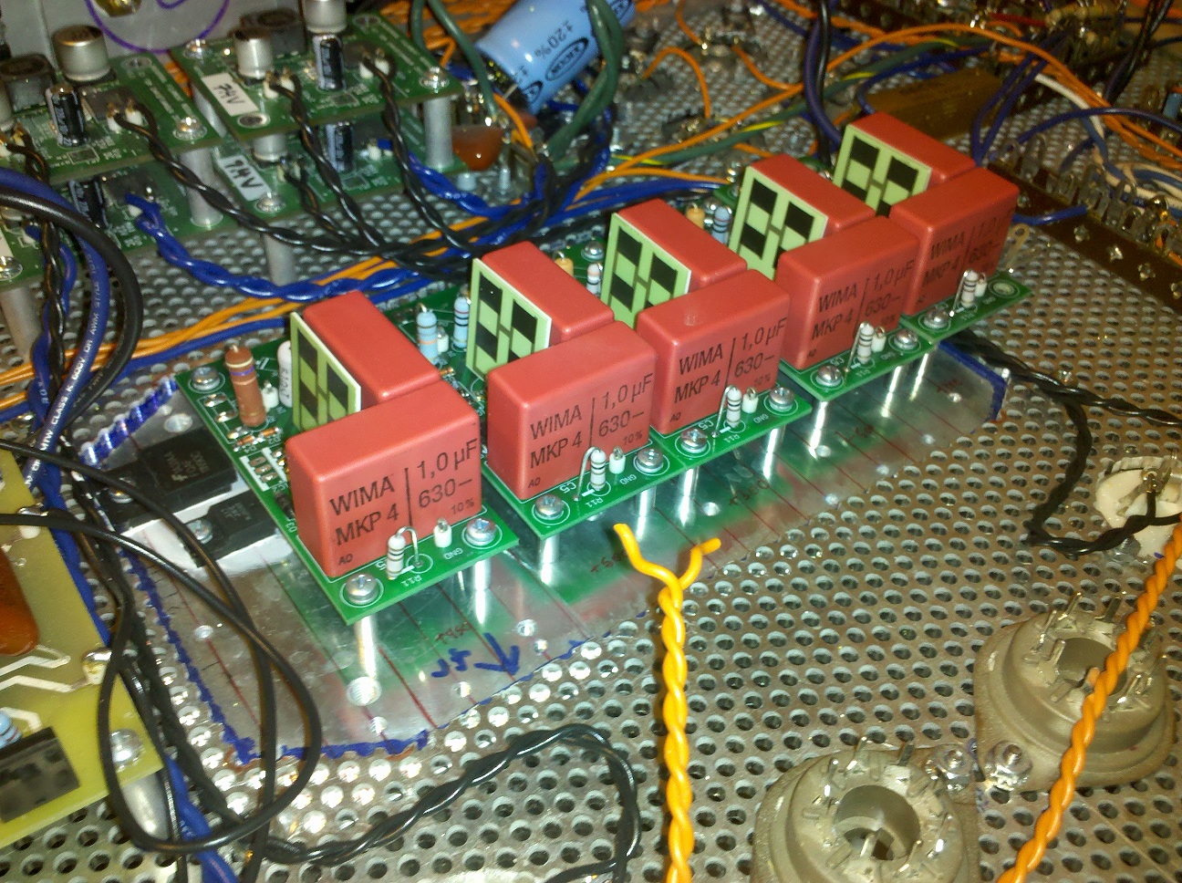

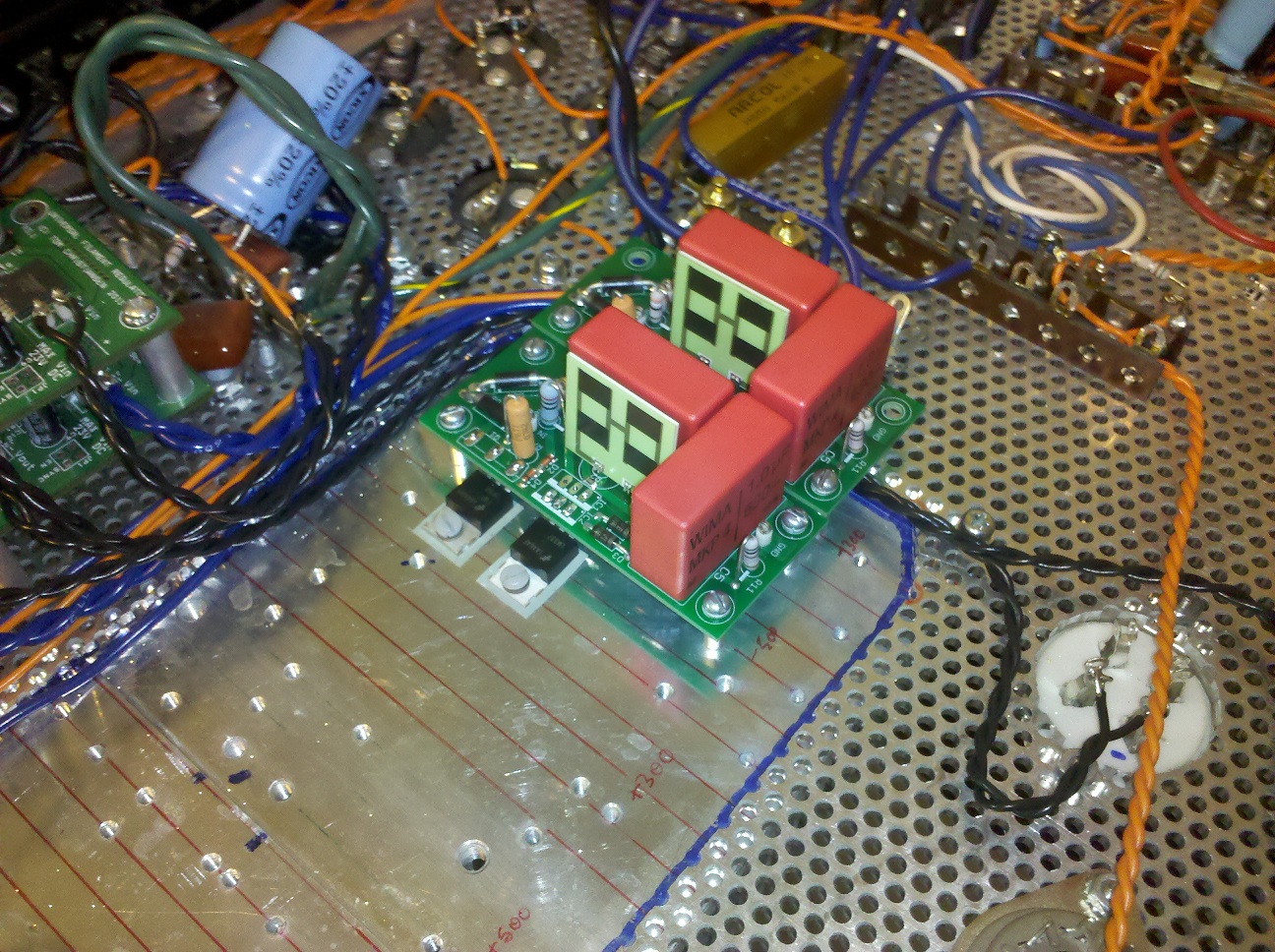

I built up a set of these for my amp and tested them and they seem to function. I can't detect any ripple on the output with my 465. They survive power cycles, etc. I guess the real test will be to watch the output when it is powering an amp that is playing loud music. That won't happen very soon as I am a slow worker.
PM me if you want to participate in the group buy or do I need to start a thread in the group buy? Anybody know proper forum etiquette on group buys, I've never led one.
I also have suggested parts and can offer tips on how to solder the surface mount parts without buying expensive equipment that I can post here if anyone is interested.
Attached are some pictures of how it all went together. This is for a push-pull amp with power supply voltages at +450(power tubes), +500, +380, -300, -420. I decided to do a split supply on this which proved interesting. I have a power transformer for the power tubes and one for the split supplies. I guess I could post a power supply schematic for those curious a bit later.

I would suggest that you post here the price and all build info like material list, smd soldering tips and so on. Also would be interested in test data, like how much power it can dissipate with only that flat plate as heat sink.

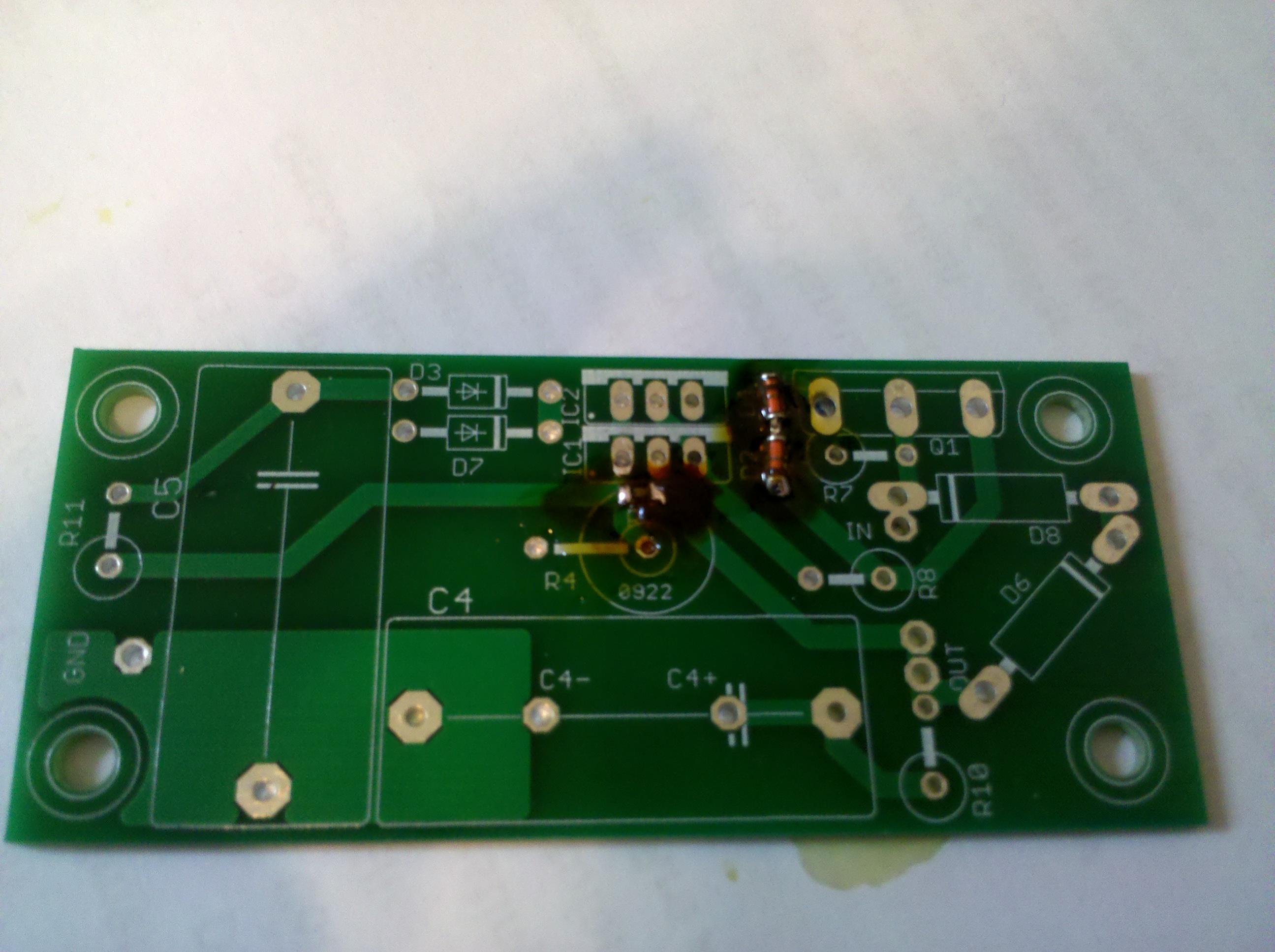

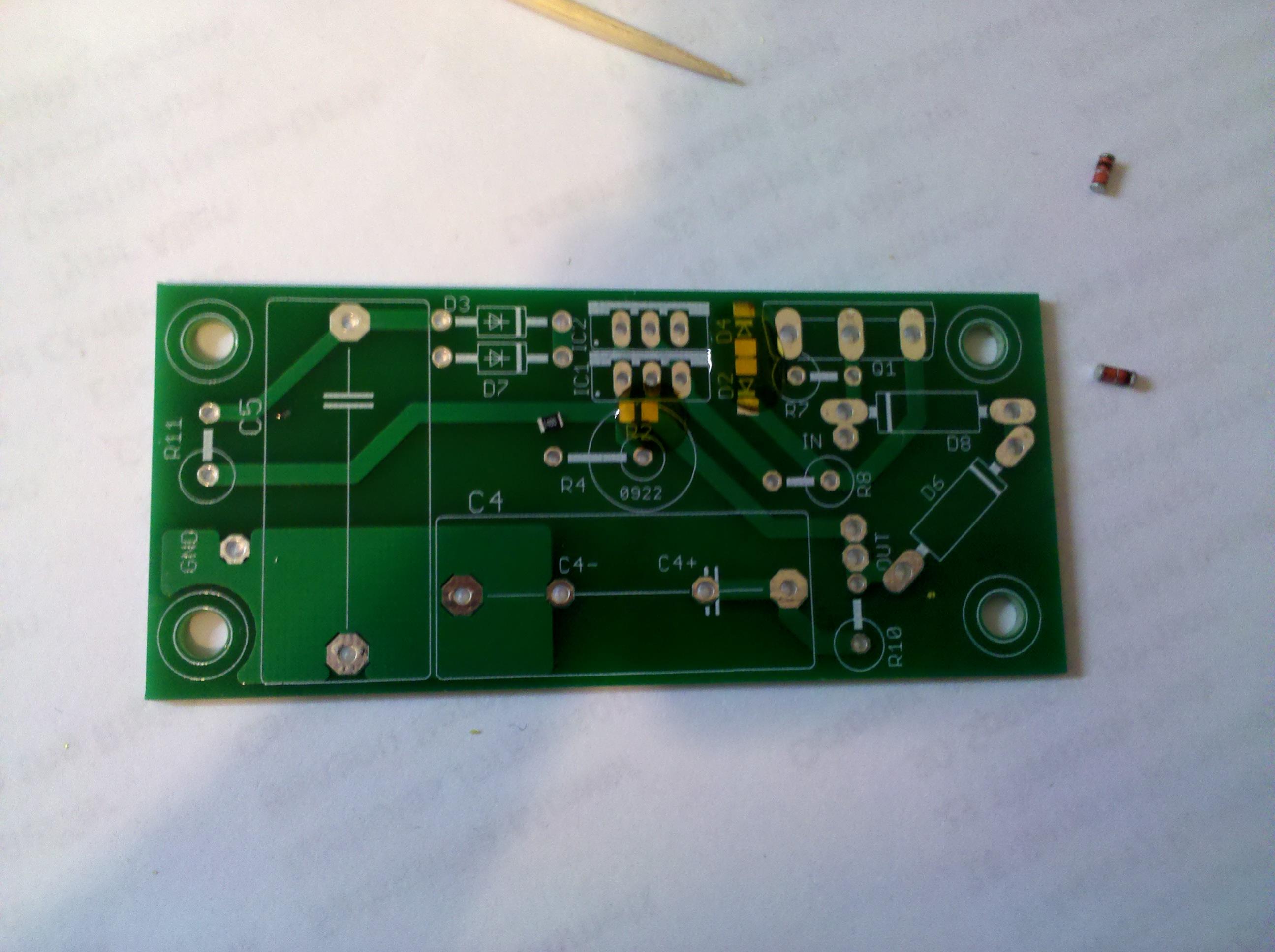

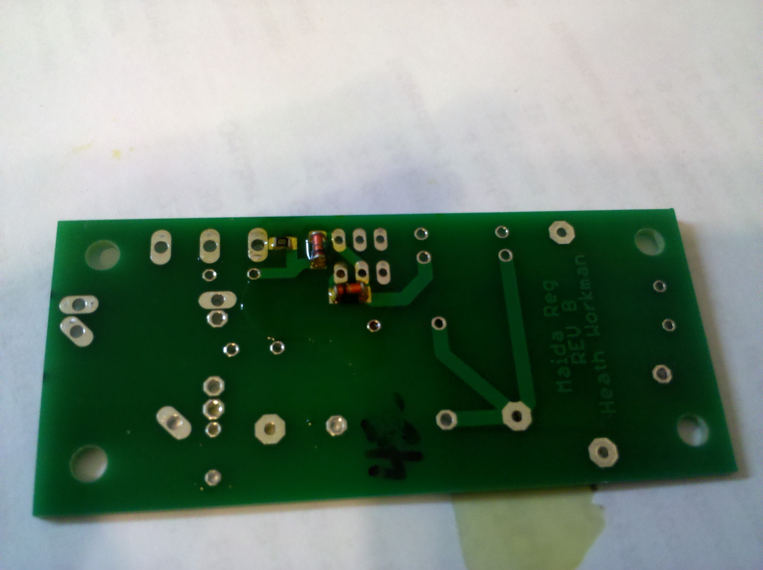

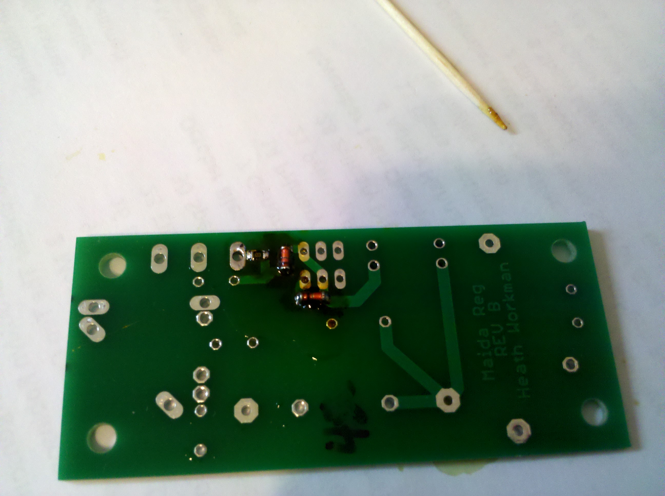

Here are some soldering tips. Basically, my strategy for soldering the SMT diodes and resistors (6 total per board) is to first paint some flux onto the pads(some use flux pen, I use a nail polish bottle). The next thing I do is pin the component with a toothpick. Next, I get some solder on the iron's tip. You don't need very much. I then touch the tip of the iron to the metal part on the end of the component and the pad at the same time. The flux makes the solder go where it is supposed to go and as long as you make contact with the pad and the lead at the same time it will work.
If there is too much solder afterward you can clean the tip, put more flux on and pull solder off with the iron but solder the second side first😉. You can also add more solder the same way. Flux is your friend but remember that you should clean it off later. I have attached pictures of the results of doing this at home. This was all done with the standard tip that came on my Weller iron.

I forgot to answer this. The plate in the picture actually has some nice big fins sticking out on the top side of the chassis. It's a heatsink I salvaged from a big industrial motor driver.
Anyway, the max dissipation is going to be set by the heatsink/mosfet combo. My method is to go overkill. I bet this won't even get too hot to touch. I use FQAF11N90C for positive supplies but you could use a cheaper one I suppose. I like the isolated package, but it is a little pricey too. I also found an LM317 with an isolated package. For the negative supplies I did have to buy rubber insulators for the LM337 and p-channel fet to isolate them.

Of the SMT components, there are four diodes and two resistors. In the schematic in post#7 the diodes are D1, D6, D8, and D9. I used 15V zeners for all of these in my design. I just noticed that I goofed on the schematic and D9 and D1 don't have the symbol for a zener. They are meant to be zeners. I will get some part numbers at work tomorrow and post a BOM tomorrow evening hopefully.
The two SMT resistors are 0805 and are R1 and R2 in the schematic. R1 is a gate stopper obviously and needed to be small to fit where I wanted it to. R2 I made 0805 because it is easy to get any value you want in high precision and low cost. My plan was to build it up and see how close I came to my target voltages and swap that resistor if necessary. Most came within a volt or two but one was 9V off. I may swap next time I order parts. R4 is a 5% power resistor so I knew this might happen.

Which devices are in MELF packages? I'm familiar with the SOD80 and related packages. Pad layouts can be made such that they support DO219, SOD123, or others as well.
Manufacturing instructed us to quit using them (MELFs) some eight years ago due to solder quality issues. Apparently the devices like to roll around.
If you are hand soldering them, it is not really an issue but I prefer other devices wherever possible.
