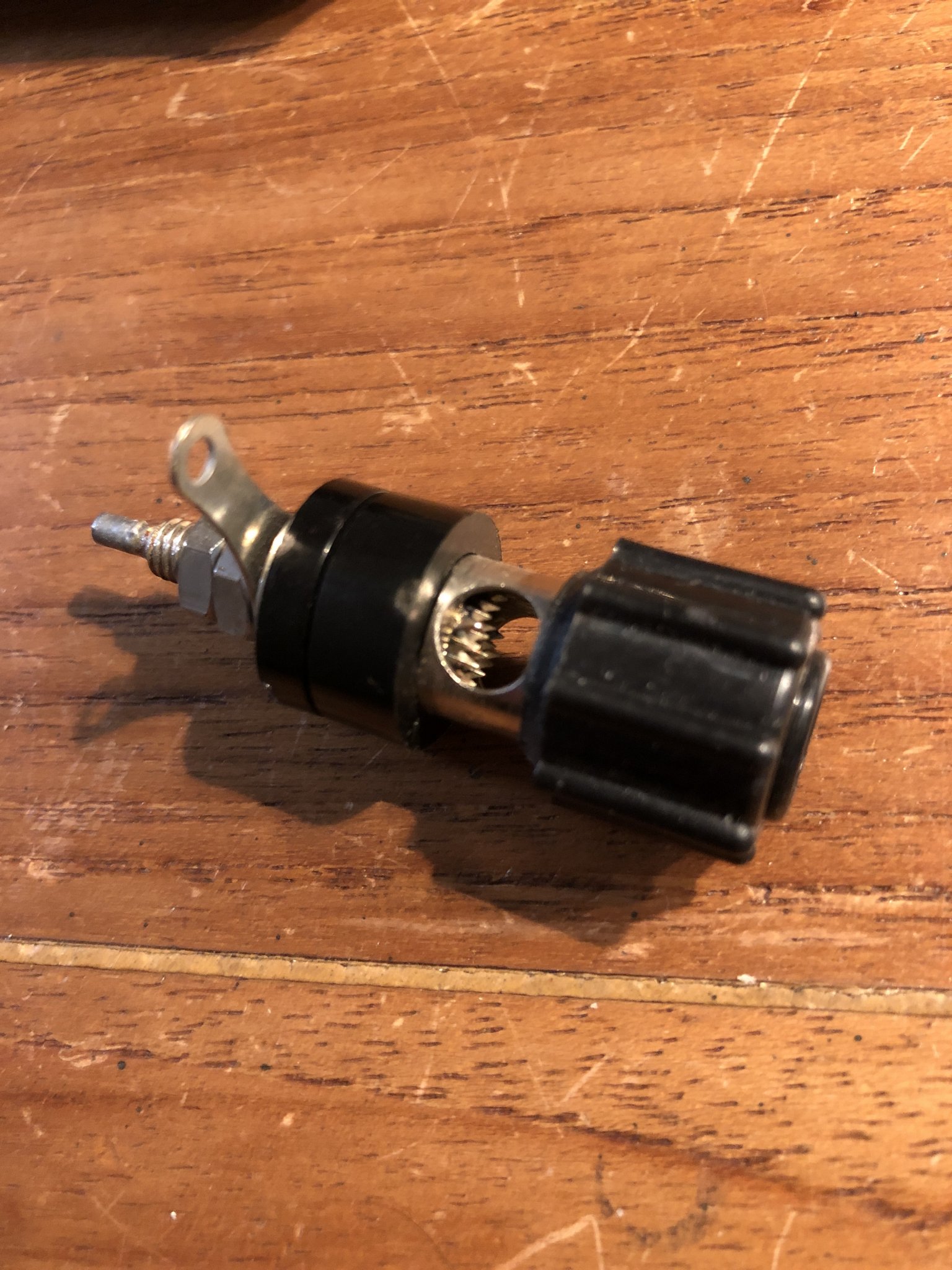

Still the spring part is a separate part.
I think you mean that the barrel shaped spring section spins around when the plug is not inserted into the socket.
But isn't it squashed and held tight against the barrel of the plug when it is inserted?

Yes you probably notice that Englisch is not my language.I think you mean that the barrel shaped spring section spins around when the plug is not inserted into the socket.

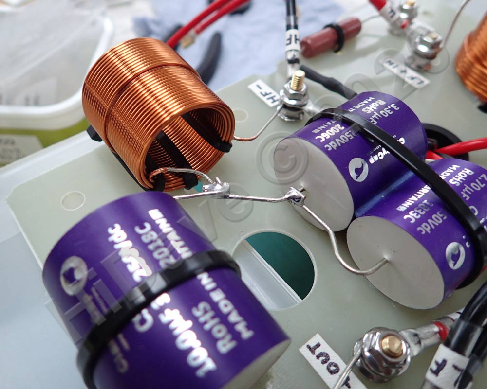

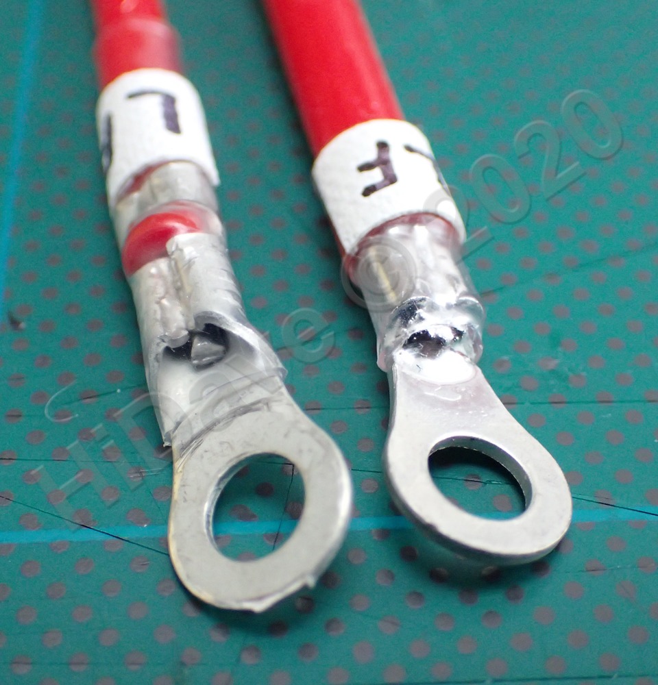

I chose a "belt & braces" approach when doing my Cross-overs
Where possible, components were connected directly to each other by hooking the leads together & then soldering. Solder used is lead free silver solder (tin/silver/copper by Shenmao).
Any cables were terminated with a eye or push tab type termination. Wire tinned, then terminal/eye crimped, then soldered & heat shrink over.
Comparison of some different versions (some soldered, others not, final version was soldered) I made:-
When a cable had to be joined to the board the lead of the last component was wound once around the brass "post" & then the cable eye was placed over it & then a serrated nut. Washer was placed over bolt before the component lead was wound once, brass bolts & stainless nuts/washers were used. Direct compressed contact between the eye & the component lead.

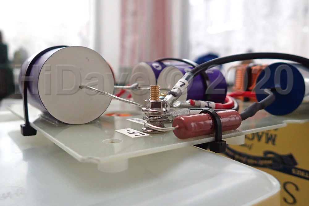

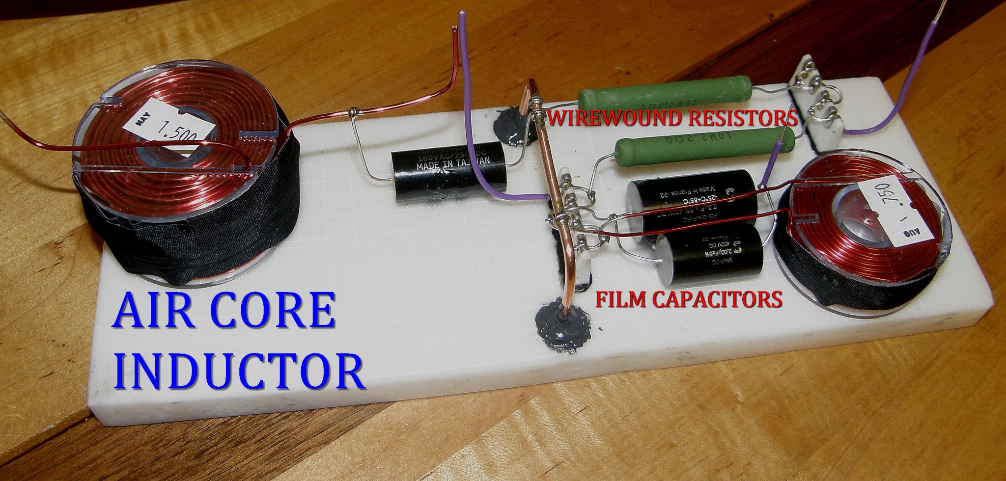

No doubt, we think alike. Here is my first cross over made only a short time ago. Like you, the wires are wrapped around the lead of an adjoining component. I think that is the number one way for me. OTOH, I wanted to be able to take the crossover out easily, as I may be changing some components, so I used stiff miniature spring connections for incoming and outgoing leads. The whole thing is supported by 1/2" Corian just because it was leftover in my shop and works easily.I chose a "belt & braces" approach when doing my Cross-overs

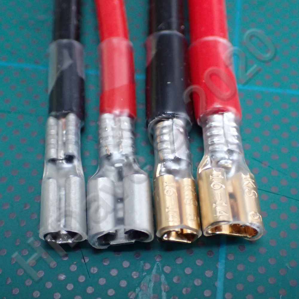

Your crossovers are worthy of being on display.Washer was placed over bolt before the component lead was wound once, brass bolts & stainless nuts/washers were used. Direct compressed contact between the eye & the component lead.
Pity the workmanship is hidden inside the box.

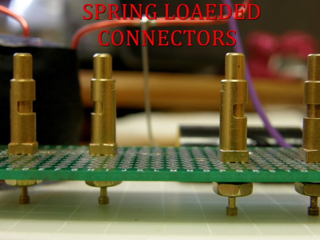

While on this subject, &, as the forum is DIY focused, I was hoping to harness everyone's knowledge and creativity towards a related issue.
We appear to be in agreement that generally retail offerings of speaker related parts such as banana plugs, speaker terminals, wiring, fasteners, tabs, solder and sundry are on the whole of inferior quality (low grade copper, cheaply formulated alloys & solder, poor mechanical strength, come to mind) regardless of price.
There also appears to be general agreement (not all) that ferrous in the signal path should be avoided.
I was hoping for ideas to DIY design speaker terminals!
- Non ferrous,
- Use of repurposed/recycled parts/material made at a time when such parts were made to a standard.
- And/or utilize well priced off the shelf new parts of an acceptable quality.
- Simplicity of design, & aesthetically pleasing.
- Functional (low resistance, good mechanical strength & easy to use).
Just a minor question.
Why the stainless nuts/washers onto the brass bolt?
Does all brass have an issue?
Thanks!....& yes I have been thinking about a clear Perspex lid for the cross-overs!
Stainless steel is not as electrically conductive as brass....so any signal that is "stray" from the cable eye or component lead will only flow into the brass bolt/post & not the nuts/washers as it chooses the path of least resistance. As stainless steel is stronger then brass, the lowest washers under the component/eye will not deform when tightening up the nuts. Also the nuts have a wide flange which is serrated on the underside which grips & locks the cable eye wherever I rotate the eye to to, so it keeps its place & orientation to the brass bolt/post. I could not find the same design in brass.

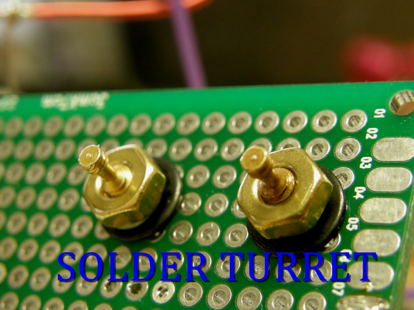

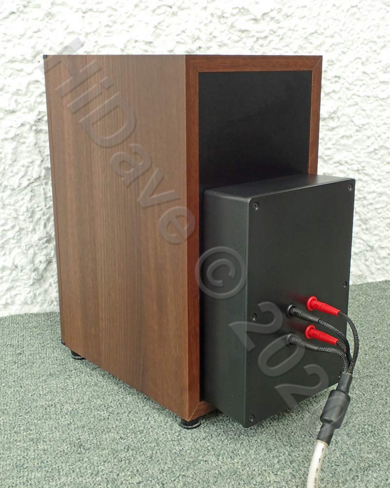

4mm Test/measurement sockets with 6.3mm push tabs on the rear by MC/Staubli is what I used:-
