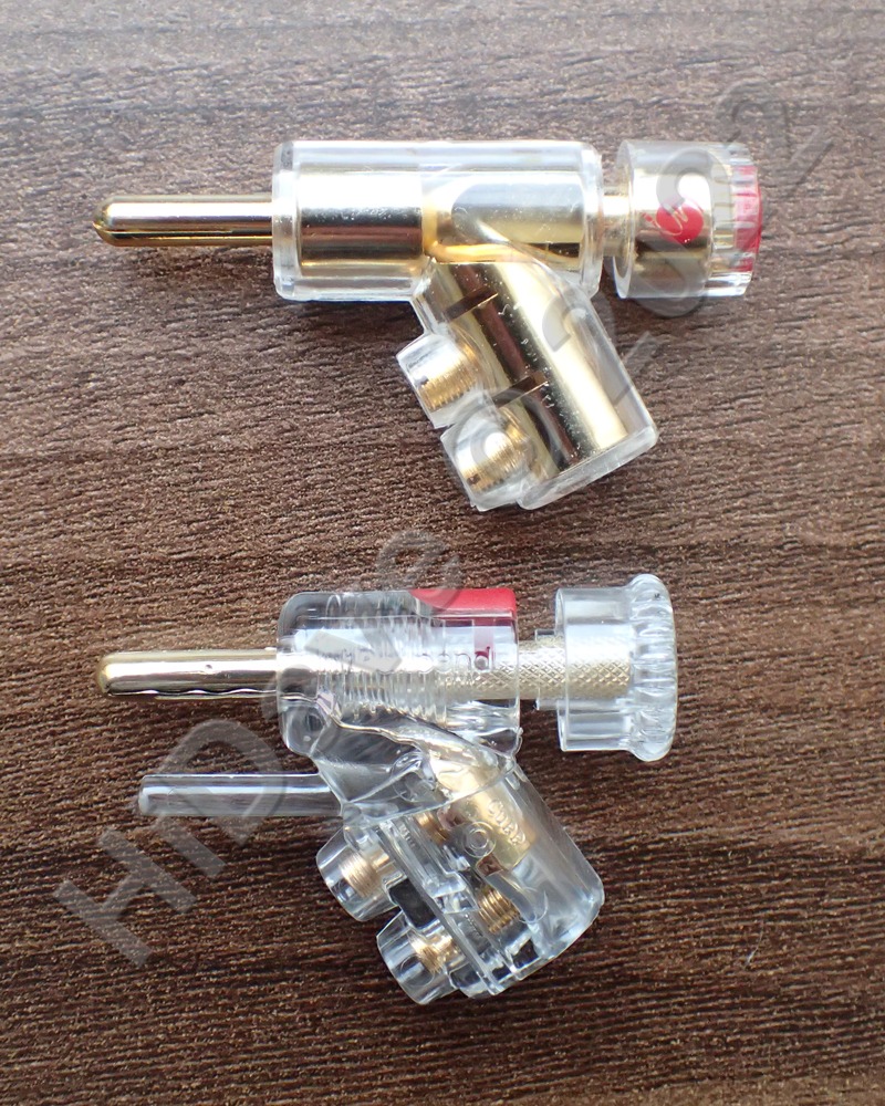

I agree with you that the WBT Banana plugs do look "fragile" compared to my previous ones which look similar but are from a different brand (Fisual). I was careful on insertion & tightening in both cable into plug & plug into Amp sockets.
I only purchased these as I am trying to eliminate all extraneous metal from the signal chain, & improve the quality of the metal that is left in the chain. Compared to my previous set (Fisual "deluxe"), these have quite a bit less metal in them & the metal is gold plated (nickel free), copper, whereas the other set is gold plated brass (& the plating has presumably got nickel in it). However the WBT ones are about x4 the price of the Fisual ones!!
Fisual top, WBT bottom:-
I agree with the use of "Test/measurement" leads, connectors, plugs, etc. as the quality is good enough to to be used on the equipment that is used to "test/measure" Hi-fi..!!

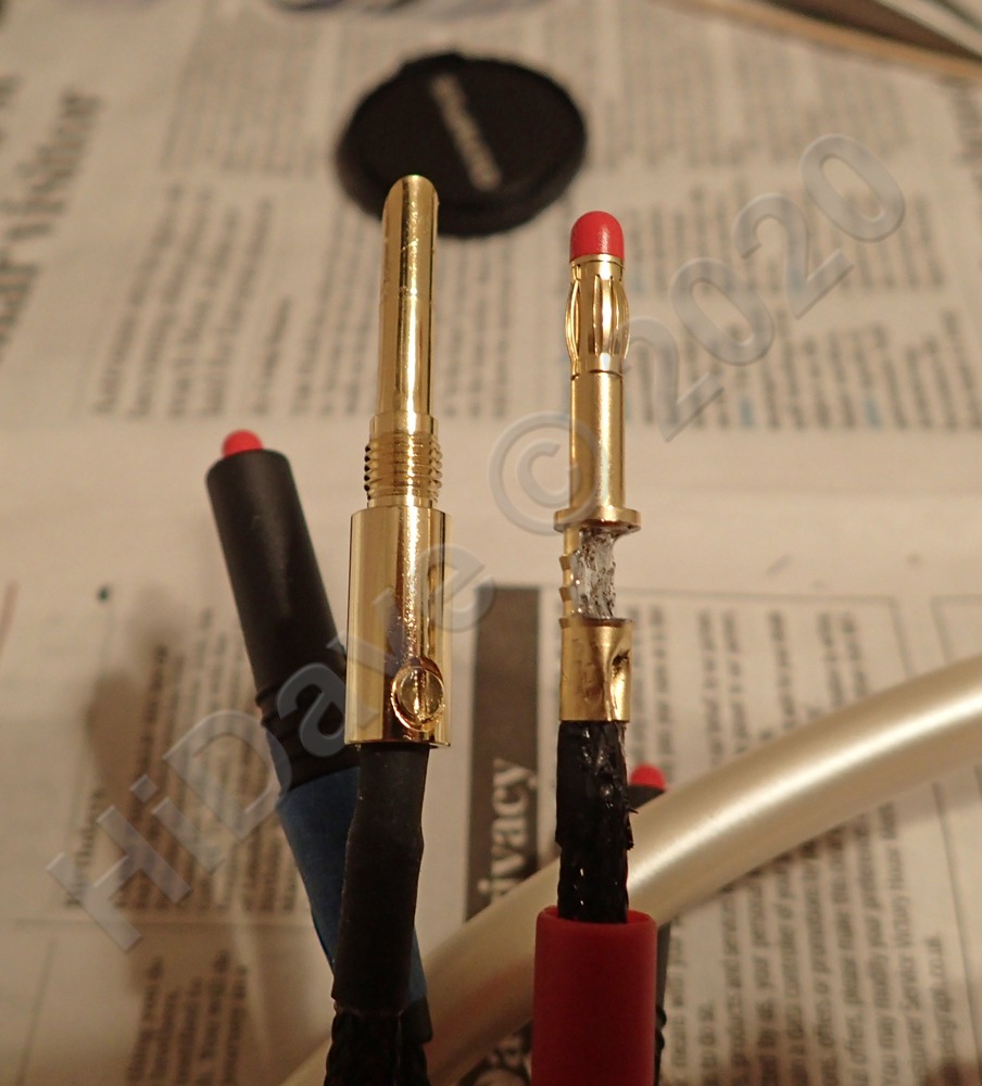

In my rebuild of the speakers, for the back panel of the speaker cross-over box I used MC/Staubli shrouded, test/measurement, gold plated brass plugs & matching, 4mm diameter back panel sockets (with 6.3mm push tabs). Unfortunately they don't do a version with a 45deg angle like my Fisual & WBT plugs for the back of the Amp, otherwise I would have purchased those instead!
Fisual straight 4mm banana plugs left, & MC/Staubli on the right. Again, much less metal, & better sprung "grips" on the MC/Staubli.

The right one has the worst contact system of all. Separate part with meagre spring force and twice a contact resistance. Cheap construction. Point being that the quality that I like can hardly be found anymore. Almost anything recent is cheaply made and sold for small prices or it is cheaply made and sold for premium prices. One does hardly see or notice differences between A and B or C brands as all is about the same. BTW I don't see the relevance of having less metal if the metal is of known good reputation/conductivity like brass/copper.Fisual straight 4mm banana plugs left, & MC/Staubli on the right. Again, much less metal, & better sprung "grips" on the MC/Staubli.

The right one has the worst contact system of all. Separate part with meagre spring force. Cheap construction.
Spring force in their matching sockets it very good!!
I look at like this:- Worrying about trying to get a perfect cable/twist/material, & amp construction, source construction etc...then you go & have a big lump of metal as a connector!
