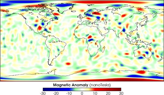

I'm concerned that the Earth’s surface magnetism may be having a deleterious effect on my listening pleasure. 😉
However, the concentrations of magnetic rocks and minerals in the Earth’s lithosphere are beyond my control.
Or perhaps a few nanotesla are nothing to worry about? After all, my fridge magnet is about 200 times stronger! 😊

Anything, valid or not, will have those who exploit for profit.I'm concerned that the Earth’s surface magnetism may be having a deleterious effect on my listening pleasure. 😉
