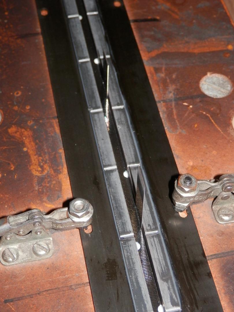

The differens is which way the magnets are turned. I don´t think the differens is a big deal. Any way its´s easier to make with the magnets like magnepan planar

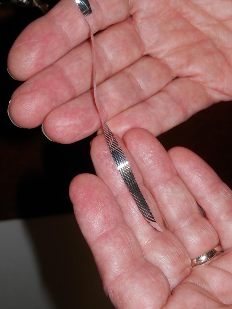

Are you saying that I could use.....these type ribbon in the magnepan true ribbon frame...
I have a pr that need new ribbons....I have been to come up with diy type a replament that would have better output......were can I get this paper......what about folding foil...any input would be helpful......these stock ribbon have week output....
thanks
thanks
dont think you get any better output on the high frequency's to be honest, the ribon is 4 micron i believe in the magnepans. and there is no other added weight to them except the conductor it self.
tyu, im curious , what do you mean by " these stock ribbons have weak output". What do u mean by weak?
If I owned a pr of the Magneplaners and that tweeter was out I would not hesitate to experament with thicker foils. Even as thick as 12 micron. Sure the super thin stuff has its benafits BUT the particular characture of the Maggi mid unit may be a good match for the sonics of the thicker foils.
Yes yes u will change the resistance and thus the x over point. I would simply compensate with some resistance added. In fact many may find that playing with this resistance and thus the level may be to their liking.
If you must have thinn I see some 4 and 6 micron stuff on ebay from time to time. Not 2.5 but not sure we arent past point of dimineshed returns once u get below 4 micron.
