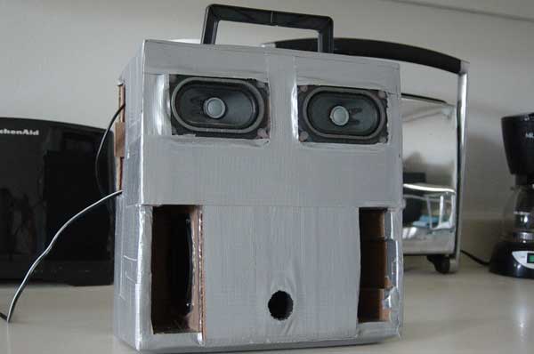

That was uncalled for. Is this your idea of a diy speaker? (see attached)limono said:I've yet to hear a DIY speaker worth more than a wood it was built from
DcibeL you beat me to it on this one. Limono you have not heard any well-designed DIY speakers. Apparently you are not into this hobby - why are you on this forum?
