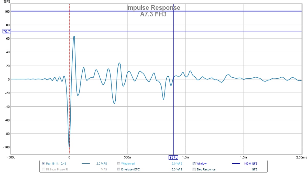

Some recent measurements of A7.3 by BMS:

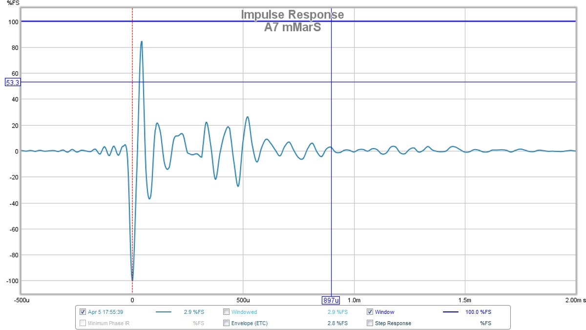

Not that I have a problem with the measurements per se -- they are pretty much what I would expect, I have an issue with technique.
It is really bad practice to use a speaker as a stand for another speaker, particularly with the driver facing the microphone. It is easy to get sympathetic vibrations that can muck up the measurements.

I gotta agree with Bob that BuildMeSomething's data is not useful here. The IR screams reflections or Bob's astute recognition of a symathetic vibration. Those peaks in the IR aren't from the box, they're far to strong.
To claim a manufacturer's data isn't reliable, I need to be confident the data is clean and accurate. That means well away from boundaries and windowed to remove the rest of the reflections if necessary. Otherwise Mark is right, we aren't at his level and can't make these claims.
I see the point about not having another driver nearby for the measurements but how much of an effect is that really? I have done measurements of the fullrange tops (as BMS) has also on an OB with the woofer right below in an inactive state. The impulse response and frequency response seem to be the same as when I measured it without the woofer directly below it. I think the reflections you see are so close they must be coming from internal reflections in the box and back out the cone. Perhaps more internal damping needed? I think the A7.3 if tested in the OB will not have the same early reflections.

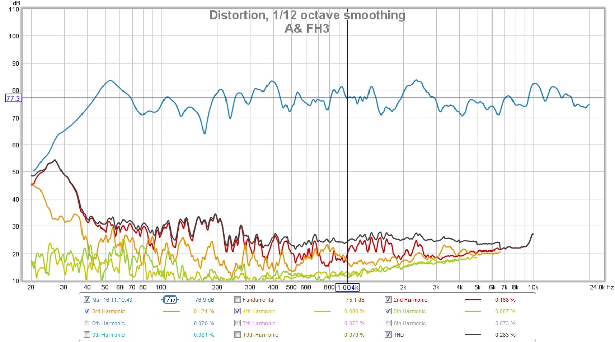

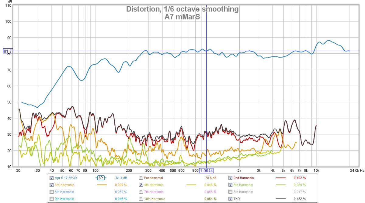

Hi, as X has posted a reference to a few measures I did of the A7.3 in the mMarS sealed enclosure, thought I'd post them here properly and add some from the A7.3 I have also fitted in the FH3 enclosure.
I know Bob fretted about the mMarS sitting atop another speaker during measurement. With the possible early reflection being due to the woofer underneath... As shown, the A7 fitted FH3 has the same early reflection plus a second just after. Personally think these are due to internal reflections.
I want to measure the A7.3 fitted to an OB, I'm hoping that free of a box these will go beyond the -45dB to -50dB distortion figures they currently exhibit in the FH3 and mMarS enclosures.
