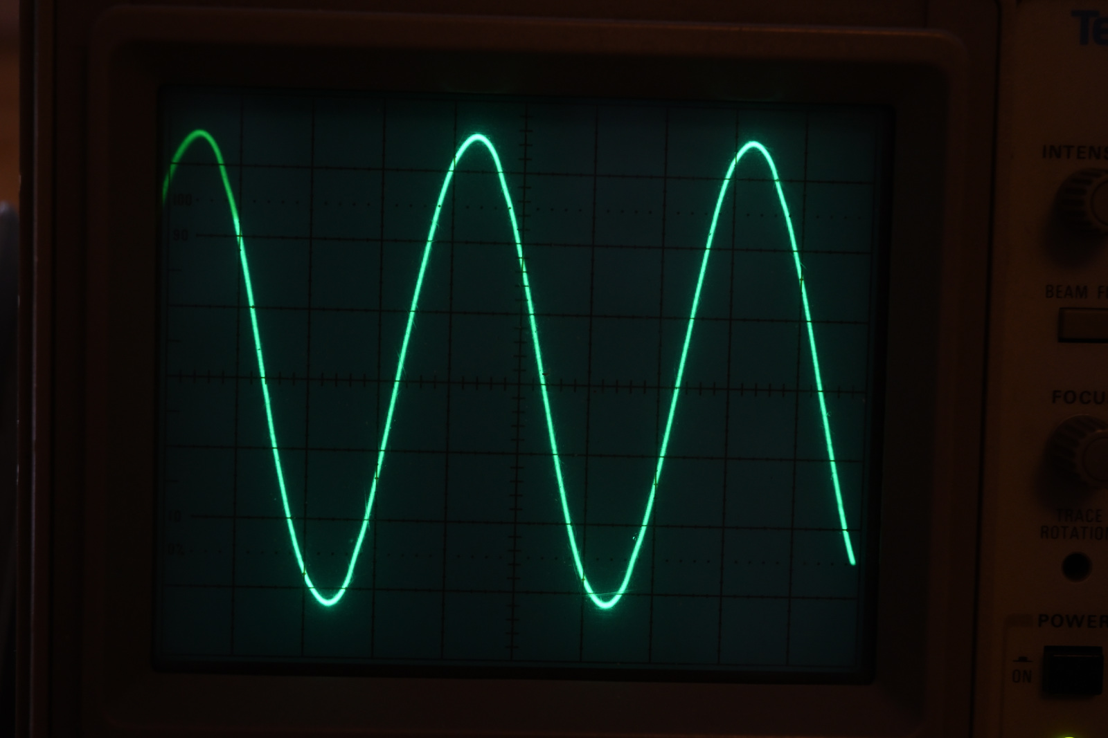

M2X strange DC offset and transformer noise problem
I think your problem of truncation in the AC is very difficult to solve with filters particularly not knowing what is riding over your mains freq. It would be quicker to see if others in your building have the problem and call the power company or move out! You have a DFT scope and attenuators to see what kind of frequencies you would have to filter out? You may need high pass and low pass. The principal 50 Hz frq is truncated so I imagine the fourier transform would huge sinc ring down around it. I don't know how the window function on scopes work. It is definitely saturating the core of your transformer and inducing the hum mechanical and dispersed flux like the Tony Stark arc reactor...LOL
I have written to the power company but I think sine waves like this is more and more normal caused by some strange asymmetrical loads on the network. Maybe something like this is needed:

I have now some news. It seems the cut of the sine at the tops is normal caused by uneven current draw. E.g. our amps with rectifier has peak current at the top of sine and it will "cut them down". Maybe look at your own mains to confirm this. I live in a city and there are some meters of wire to the transformer station. So it probably depends of where you live how "ugly" the mains looks.
I have now invested in a small power re-generator which is made for audio (not an UPS). I now have a nice sine and my transformers are silent now. Ripple of rails has gone down from maybe 25mv AC to 0.0 mV when M2X are stabilized. The DC offset of the left mono block is 100% stable while the right channel is stable within -+ 30 mV or so.

This is how my 230 VAC sine looks now and it is regulated.
Sound is fantastic. When DC-blocker arrives it will be mounted in front of re-generator.

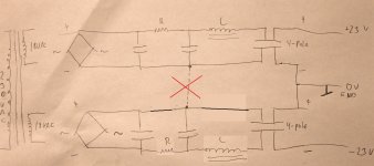

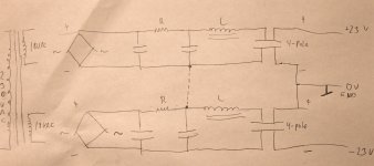

I might have found my error.

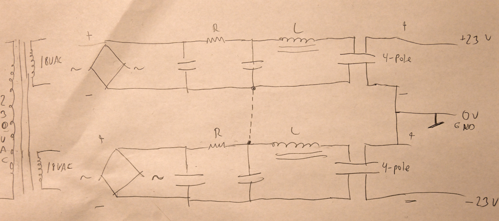

I attached a principle drawing of my PSU for each M2X mono block. It is based on the universal PCB (CRC) with and added LC filter where the C is a 4-pole capacitor and from this cap I define my Gnd. This connection also goes to chassis via a NTC.
On the universal PCB I had soldered in one link between the two channels. It is the dotted line on schematic which I now have cut. It seems (we will see over time) this did the trick with both occasional slight humming from transformer and with one rail voltage 0.2-0.3 V lower then the other and going a bit up and down. And suddenly it could be stable.
Do you think the dotted line connection could have causes that (creating unbalance)?

A 4-pole cap is just a cap made for filtering only (not for coupling) which has two inputs and two output so DC current are flowing through the capacitor foils for better filtering.....is the theory.
After some hours now my left amp showing 0.6-0.8 mV of DC offset and right amp is showing 0.9 - 1.1 mV offset. And toriods are silent. I can hear a bit with ear close to it. The very stable DC offset is also caused by the regulated AC mains which is steady at 230.6 VAC or so.....with a nice sine.
What ZM said, though I’m familiar with 4-pole caps. The asymmetric nature of the circuit makes it more susceptible to ground loop issues. With your supply, the star ground needs to be in exactly one place, and should also include the speaker negative terminals.
Yes, that dotted line connection has been cut. It was a link on the Universal PCB between the two sections. I had only mounted one despite there are room for many 🙂 ...so I could cut it without unmounting the PCB board which has really many screws (used all mounting holes). I have one common star ground and very short wires from the 4-pole caps to the PCB (few cm). Electrical hum level was very low when I did REW measurement and I expect even lower level now.
