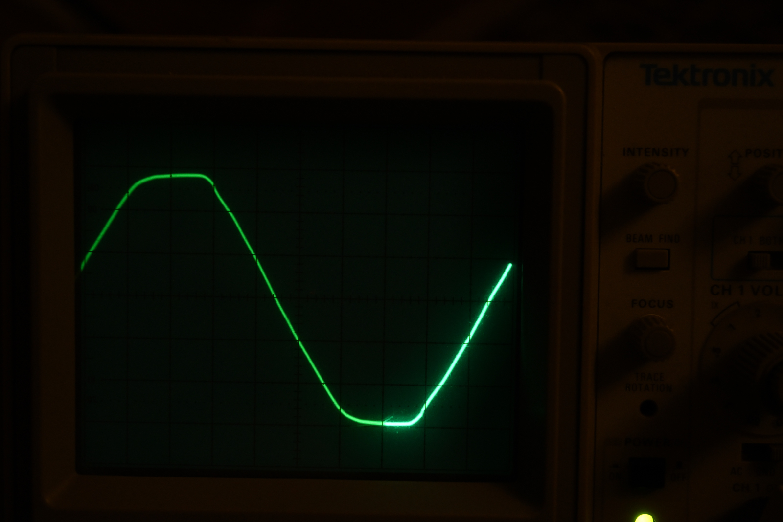

This is direct from the wall (what goes into the filter and isolation transformer).
I can also see that the negative DC rail voltage on both amps are less negative than usual. Rail voltages are like -22.7 VDC and +23.3 VDC. This morning they were almost symmetrical. So this is the reason why DC offset is a bit off now........
So probably amps are fine......but transformers does not like the sine.
How can I "reshape" a bad sine?
The sine out of the isolation transformer looks identical (have just checked). I see the same difference between AC and DC coupling. The difference is probably just the input cap in AC mode that filters the signal.
Here a better view of the shape out of the isolation transformer after I have aligned the line in Gnd mode exactly at the center line. Sine is not 100% symmetrical around the Gnd center line.

You can not reshape the AC mains... unless you generate your own by using inverters and batteries.
Do you live in a house that may have reactive loads connected to mains supply? Do you live in an industrial area?
You could also try this: you have two monoblocks... so, try swapping the primary wires around on only one monoblock transformer. That may do something
Or, plug the monoblocks straight into the mains wall outlets... do not use power boards, if possible. Maybe that will help...
Also -> unplug everything in your household from the mains supply, and then see if the mains waveform changes🙂

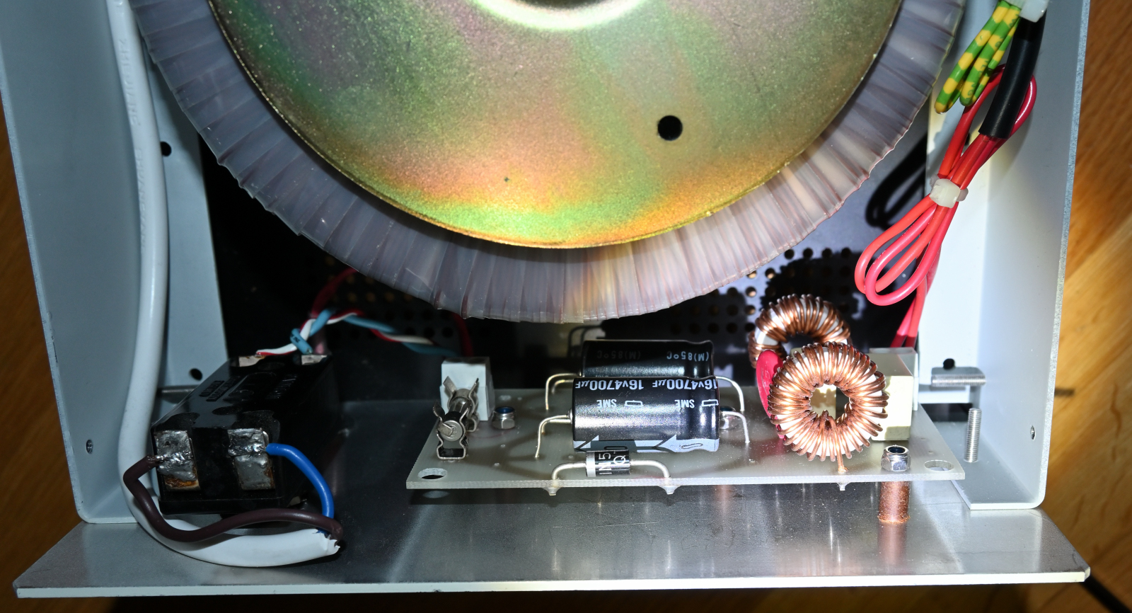

I looked inside the box with isolation transformer and there are diodes and two capacitors that usually forms a "DC trap"?
Now only one diode is visible in image. In fact there are four. Two between the two caps and one on the outside of the caps which I think are those that are involved in "DC trap".

The DC trap will trap the residual DC (put your oscilloscope on DC when you are checking the mains waveform, and then see if there is any residual DC... of let's say 20-30V..???); however, it can not correct the flat peak-to-peak mains waveform.

well, it is DC blocker , though I prefer something more substantial ( regular 25A metal cased diode bridge, wired appropriately) ...... and even two of them wired in series, so DC blocking is extended to sorta double level
is there possibility that these caps are old and tired?
as you already implied in post #11 ?
as I see it - easiest and fastest is that you scramble some parts from drawers and make one quickie DC blocker , with fresh parts

The last scope image is in DC mode and in Gnd mode the trace was adjusted to the Zero line. There was not jump (as I could see) when shifting between AC and DC mode. Only the flat top was more like a "down hill" in AC mode.

flat crests of sine are not exactly what we are talking about when we are mentioning DC in mains ( which is more easily explained as asymmetry of sine - mid line being moved up or down ref. to neutral) ......... but flat tops are exactly the same in nature as clipped sine at output of your amplifier ........ and we know that's exactly the thing which is killing tweeters :rofl:
xformer will complain wherever it sense steady value of current , be it from one or another reason
DC blockers are capable to solve slight sine asymmetry while those flat crests are hardly solvable without resorting to your own Niagara
proper isolating transformer , with differential secondary and with non-toroidal core ( so EI) usually is making problem lesser, (slightly softening flats) but with price of own humming, so simply taking away some (humming) burden from your equipment to own trouble
