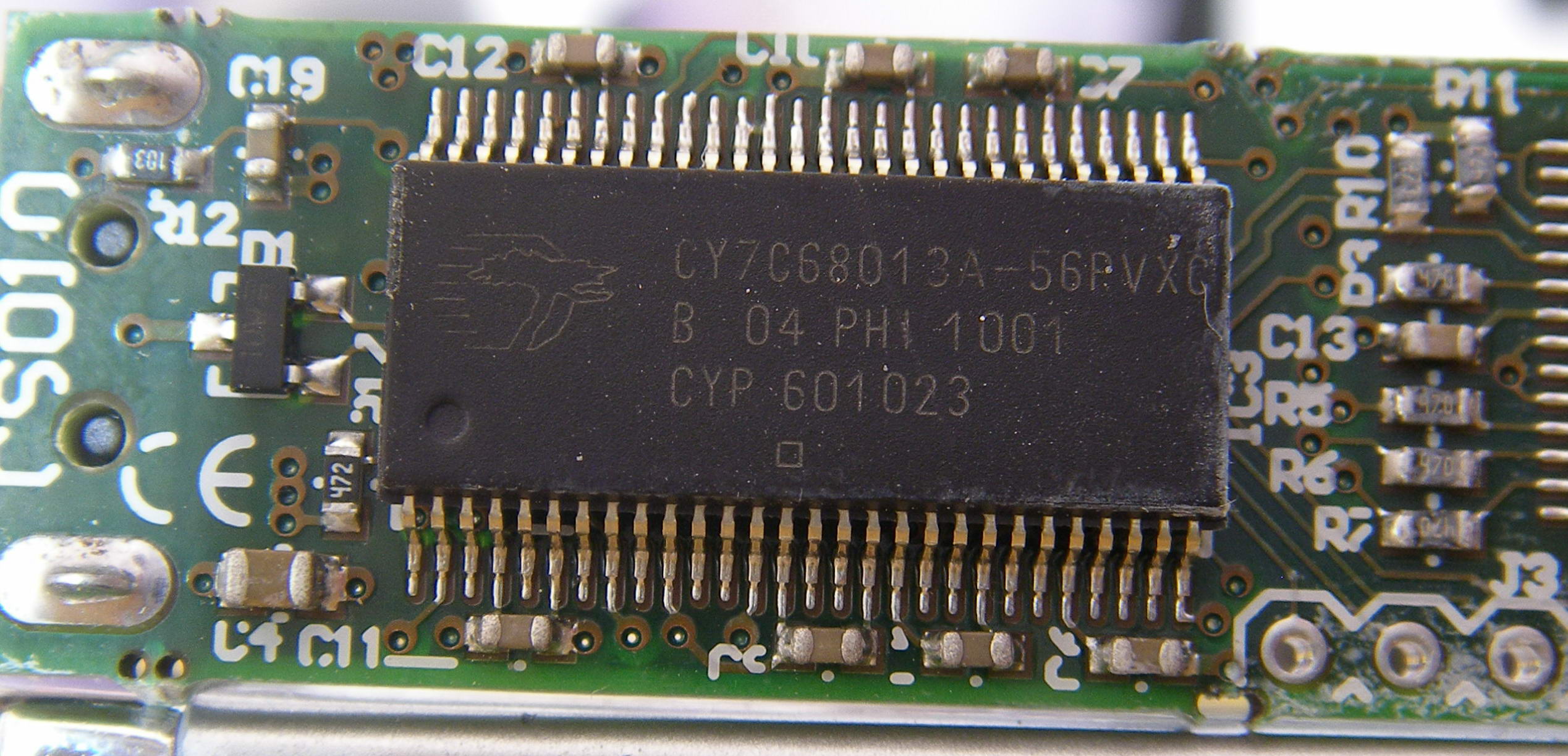

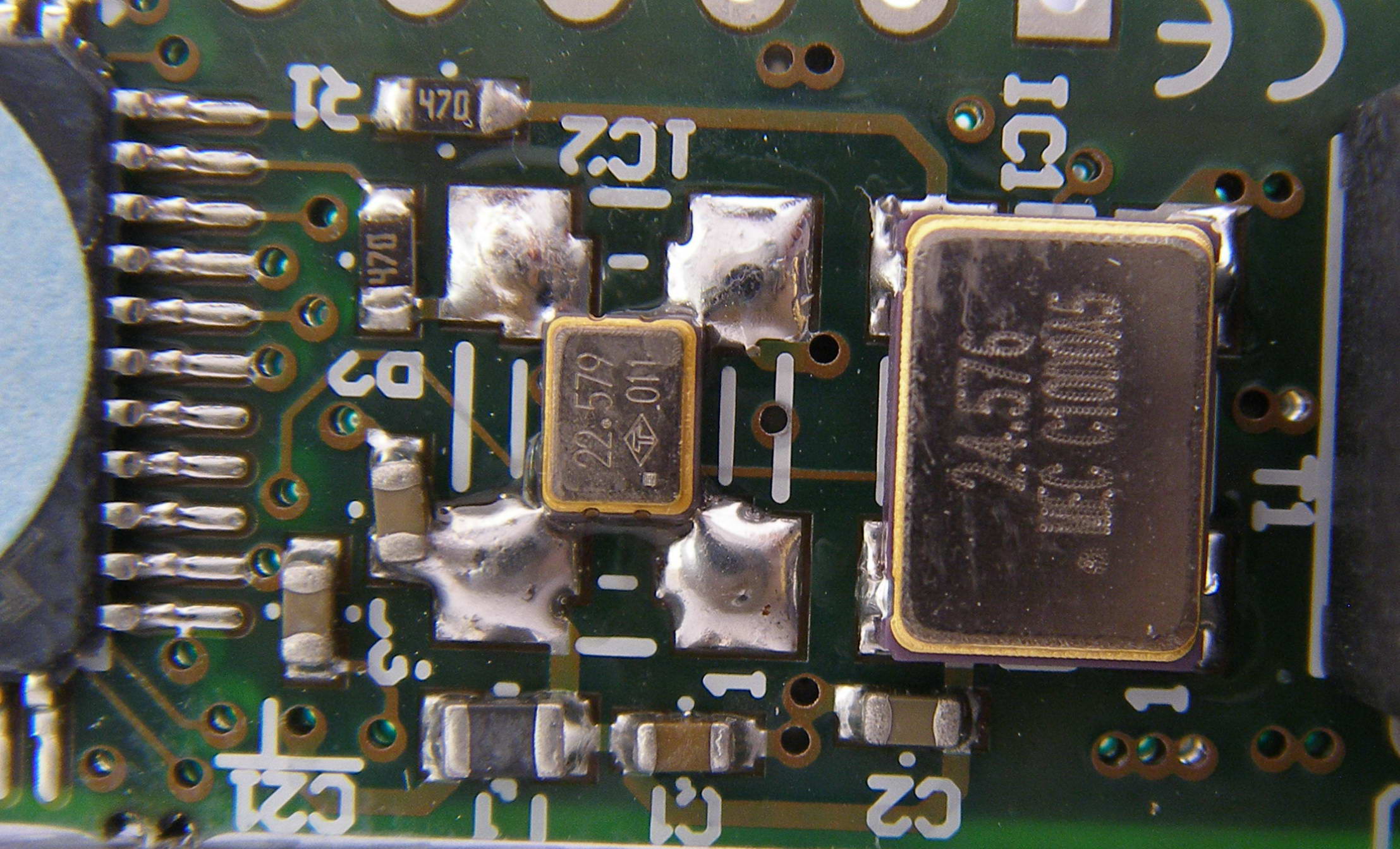

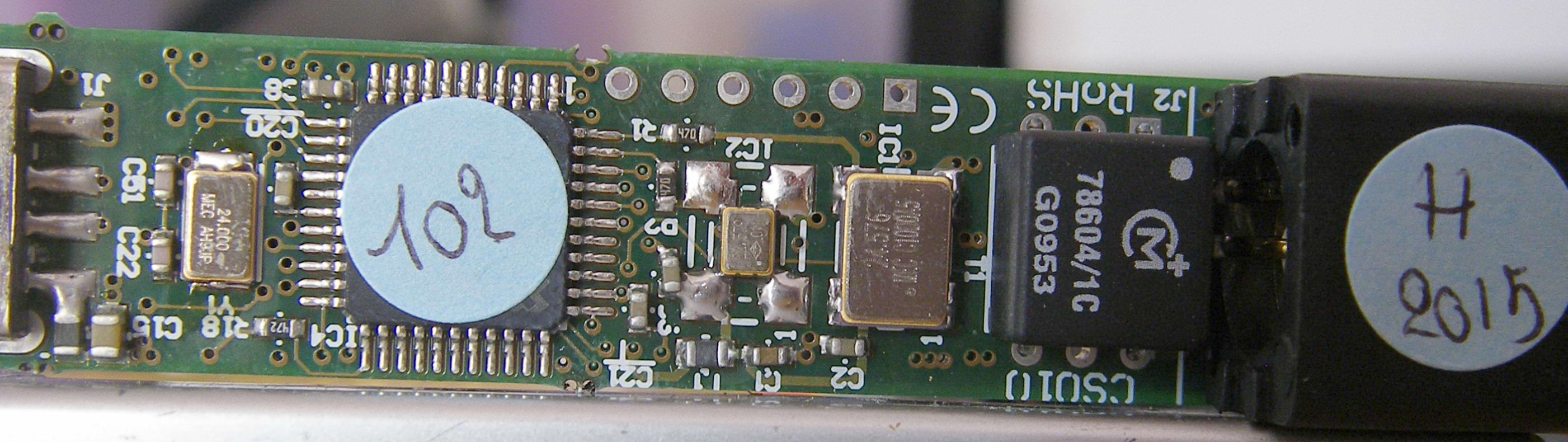

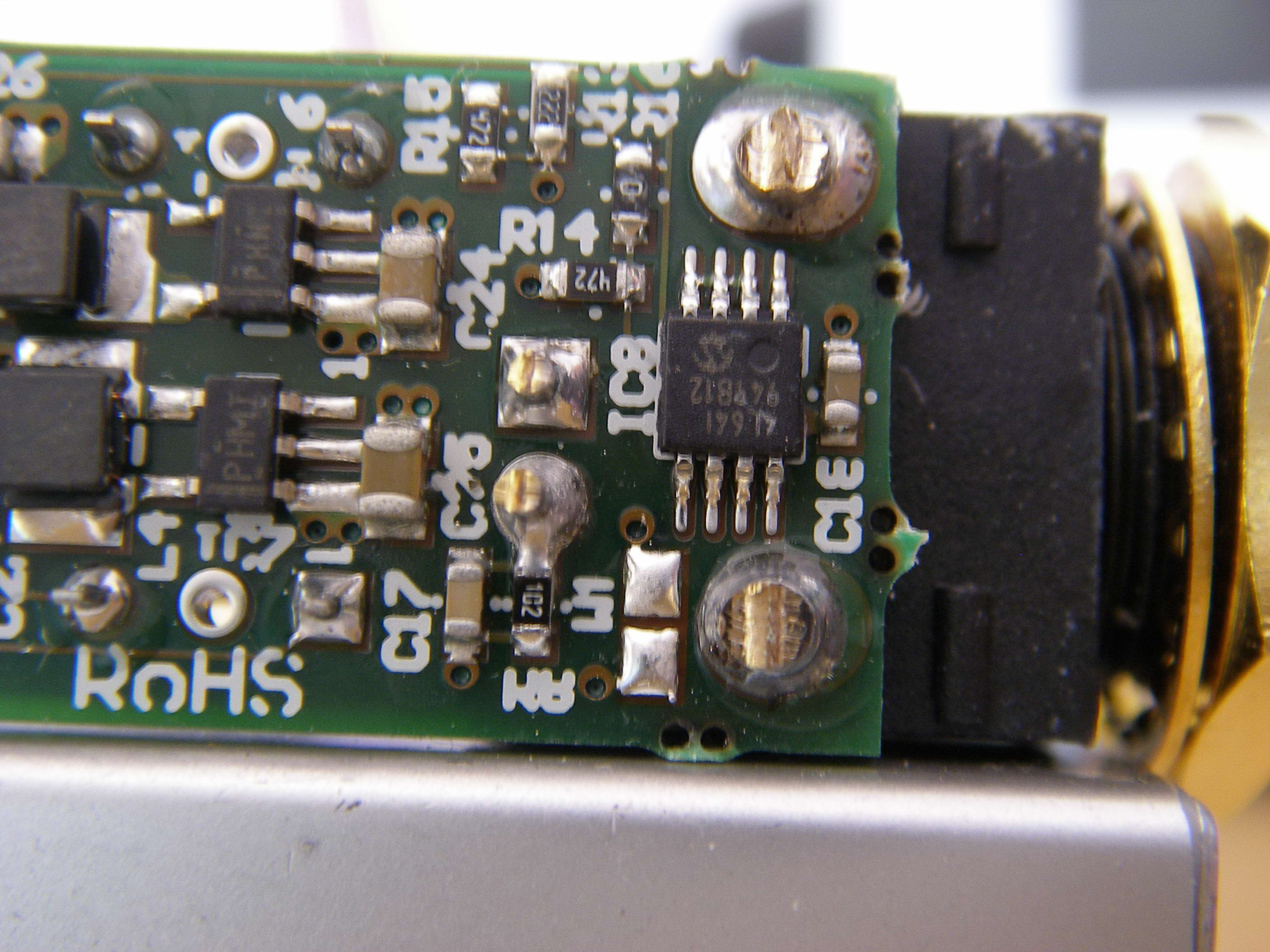

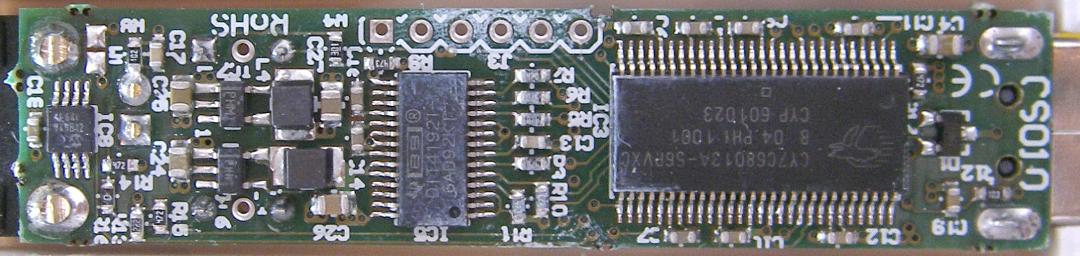

Here is my Hiface, there are some difference!!!
Also I want to know if it is a good idea to remove the isolation transformer, because I use one from Lundahl ll1572 inside my buffalo dac.
I think the only difference from the original hiface photos is that small 22.5792 clock is no longer a MEC clock.
You are talking about removing the SPDIF transformer in the HiFACE - is the LL1517 being used for this in the Buffalo?
Pharod, Can't be done without breaking the case - it's glued along a seam all the way around the case.

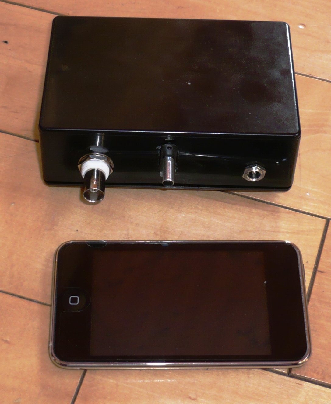

I rebox my modified Hiface inside a bigger box with batteries, switch, led, charger socket.

Thanks Jkenny. Nice Job!
