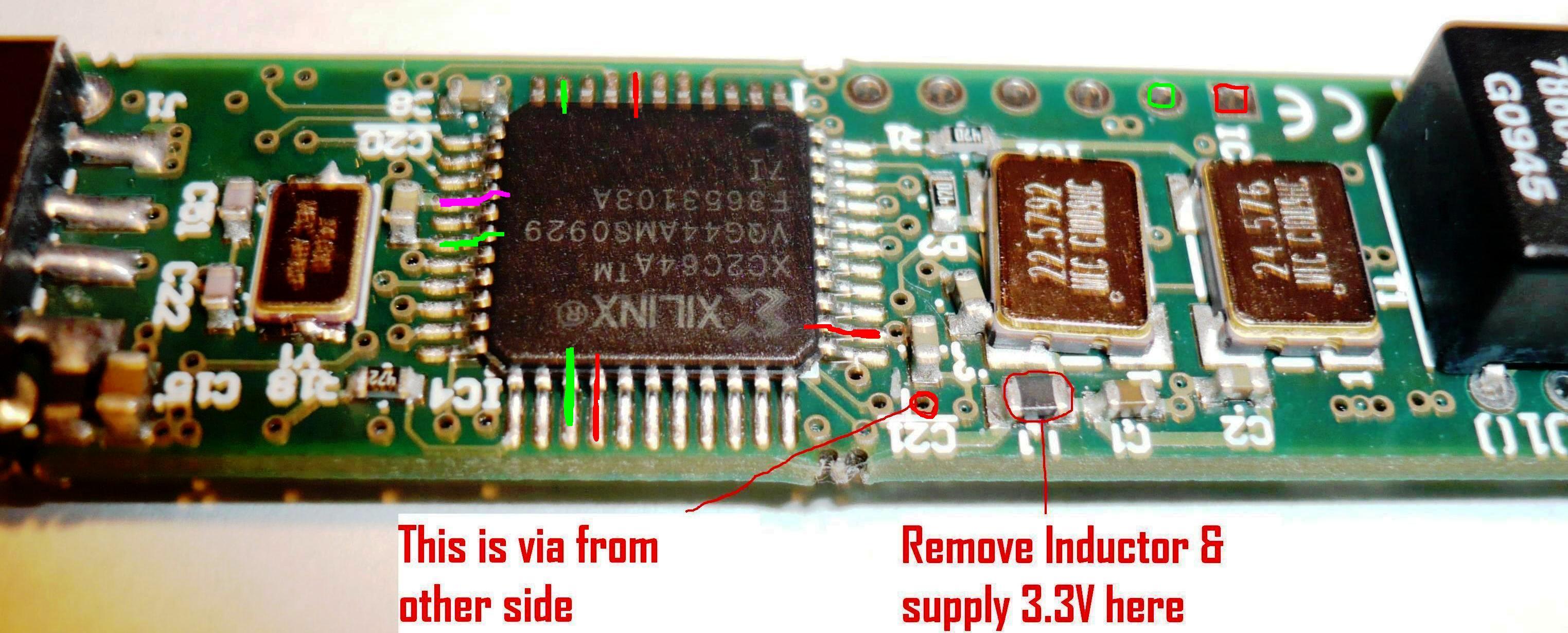

Do you have the ground to your powersupply connected to the USB ground?
Thank you very much to GuidoR & Regal the M2Tech hiFace is going on well, the regulator is Salas V1.0 remote sensing I don't use I2S, I prefer to use the isolation transformer for SPDIF, the DAC is a TP Buffalo II also Salas V1.0 remote sensing, the I/V is an Erno Borbely configured balanced for the Buffalo II, I mind this aproach for hiFace inside the DAC box is very good because don't need digital cable & specific 75 ohms connectors only needs & USB 2.0 cable extension.

Yes, a major change in sound quality, with batteries (Jkeny tried LiFePO 3,3, but also 2x1,5 alkaline will do the trick).
Have a good luck (micro-surgery is involved...

Thanks GuidoR, I see post 128 when jkeny connect the +3.3V disconnecting an inductor.
Yes Merlin, remove the inductor & connect your 3.3V to the right pad vacated by the inductor (or to the left of the smd cap). Ground (Neg) can connect to the right of the smd cap.
