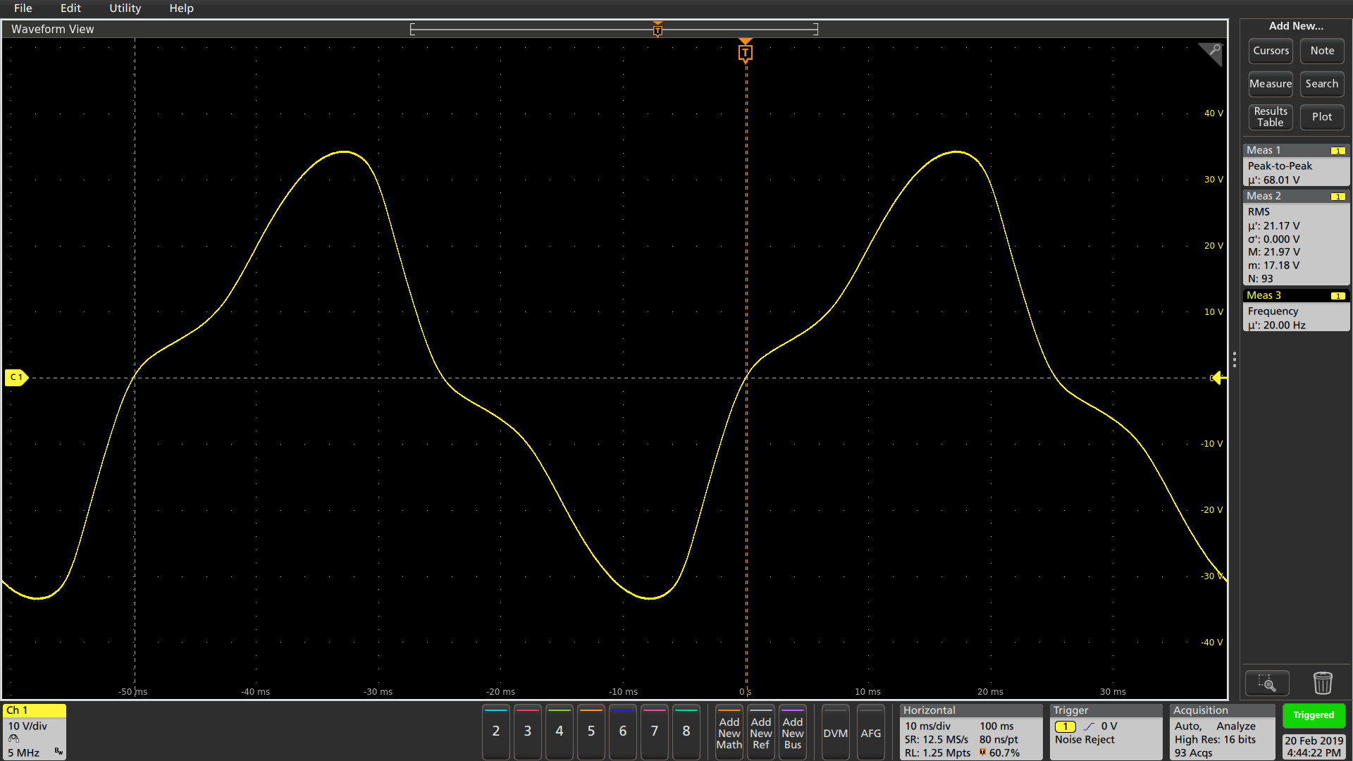

As you predicted, for 20v p-p out at 20 Hz, the sine wave is visibly distorted.
So, if max p-p voltage out is needed at low frequencies, this is not a good solution.

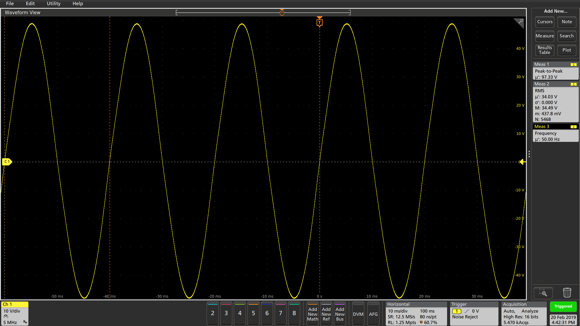

I like to measure things so I went further and measured the Edcor for voltage swing and for bottom octave behavior.
No problem getting the Edcor to swing 100V p-p undistorted as low as 50 Hz. Below 50 Hz, and above 10 V p-p, there is visible distortion regardless of output impedance of the driver. So, I conclude that the distortion is core saturation.
This preamp idea would be to drive my Aleph 30 which would be driving an array of midrange speakers that will have a 100 Hz crossover making behavior below 50Hz not so important.
Thank you all for the inputs and suggestions. They were all helpful.
50 Hz 100V p-p output

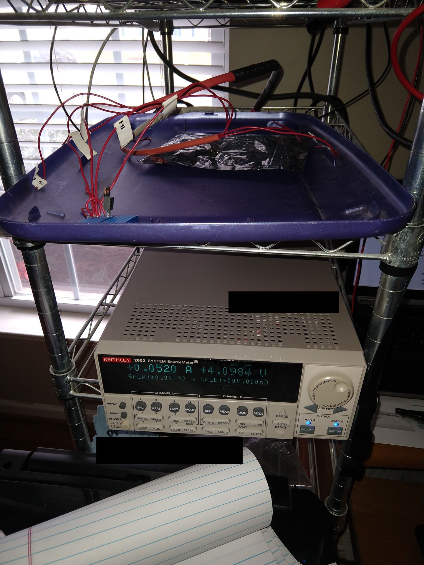

Thank you for the well wishes. I have sorted through a pile of qty 50 MTP10N15 and have found enough matched pairs to go forward. I measured Vgs at 51.9 mA.
The matched pairs span Vgs from 3.85 to 4.11 with two quads at 3.93 and 3.94.
A pic of the test rig for measuring Vgs is attached for amusement.

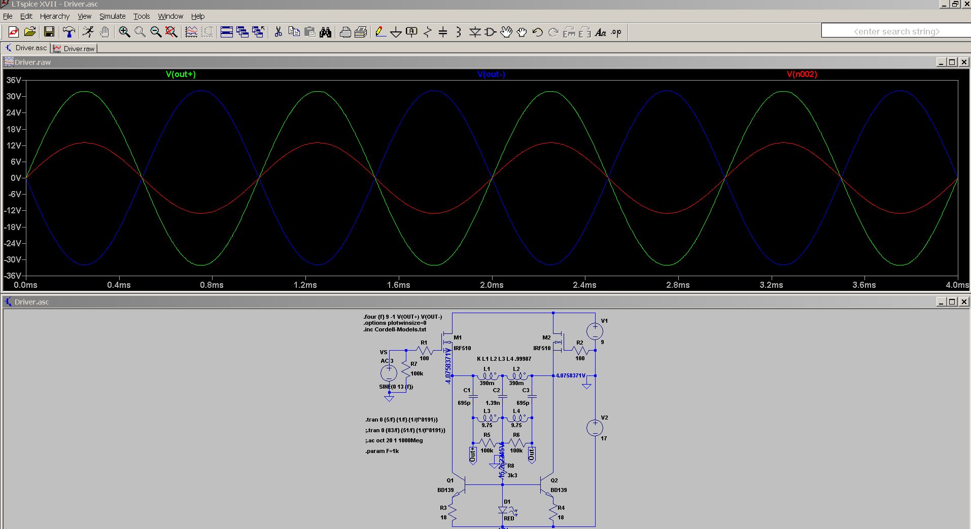

Indra1's driver Asymmetric rails
Hello Indra1
I have interrogated your driver circuit. Clipping with + / - 9V rails is quite asymmetric. I adjusted the negative rail until clipping was mostly symmetric. It looks like the negative rail wants to be approximately two times Vgs more than the positive rail for symmetric clipping.
Yes Brian, clipping will be assymetric on symmetric rails. But it does not really matter for use up to 10Vpp you need to drive the Aleph 30 right?.
And use a 47 ohm dummy resistor instead of the transformer to first make sure DC offset is manageable as pointed out by Mark Johnson on your build.🙂

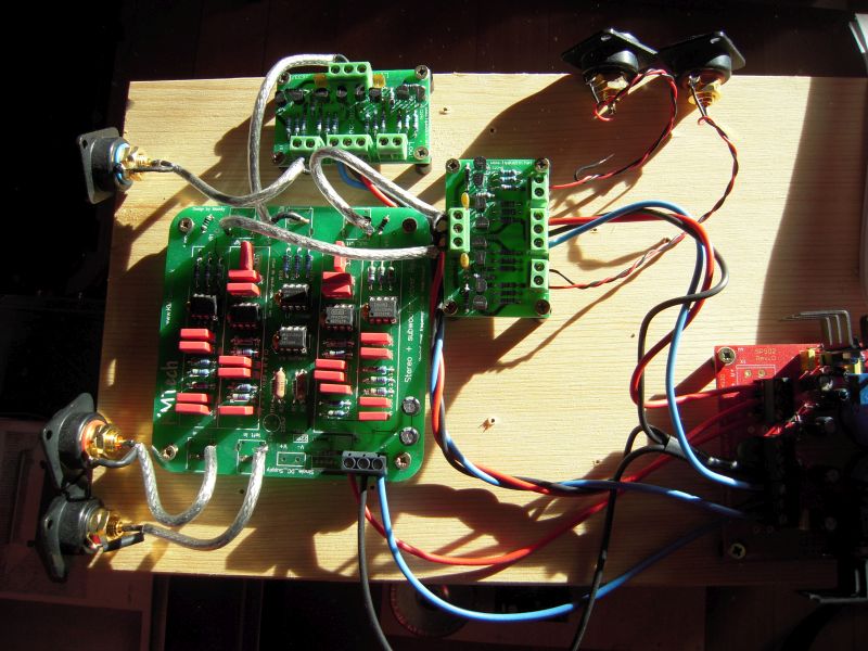

answer to woofertester
Hello woofertester,
I have used those bufferboards mentioned in the beginning of this thread
to buffer the outputs of one of my active crossover projects (based on OPAmps). It behaved very well. But I wasn't measuring it. Only listening. Was a few months
ago.
But at the moment this project is sleeping. I made an PASS AXO and a M2X
inbetween......
Greets
Dirk
