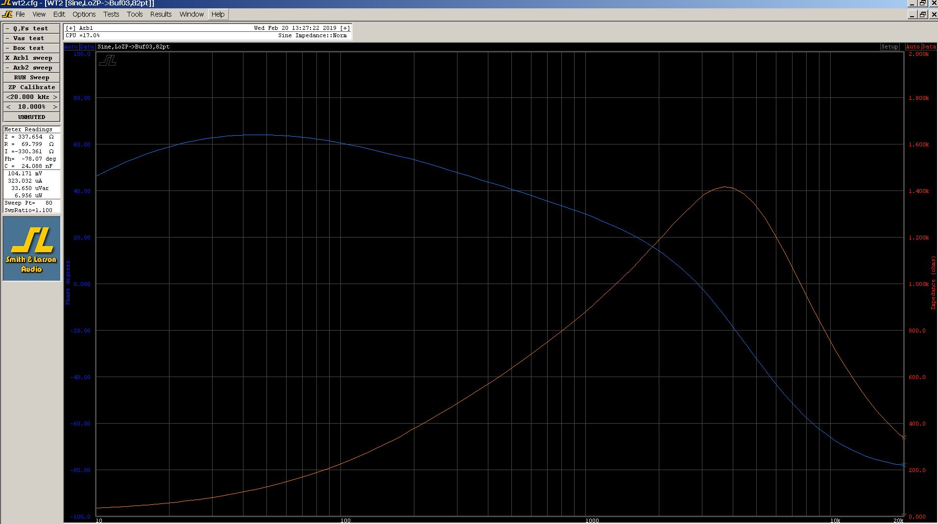

1/2 of 600 ohm tap of PC600-15k
Attached is an iunloaded mpedance/phase plot of 1/2 of the 600 ohm winding of an Edcor PC600-15k transformer.
This winding has a resonance around 3.7 kHz.
The low frequency inductance starts at about 390 mH at 10 Hz and tapers to zero near resonance. At 20 kHz, the capacitance is around 24 nF.
This is from pin 1 to pin 2

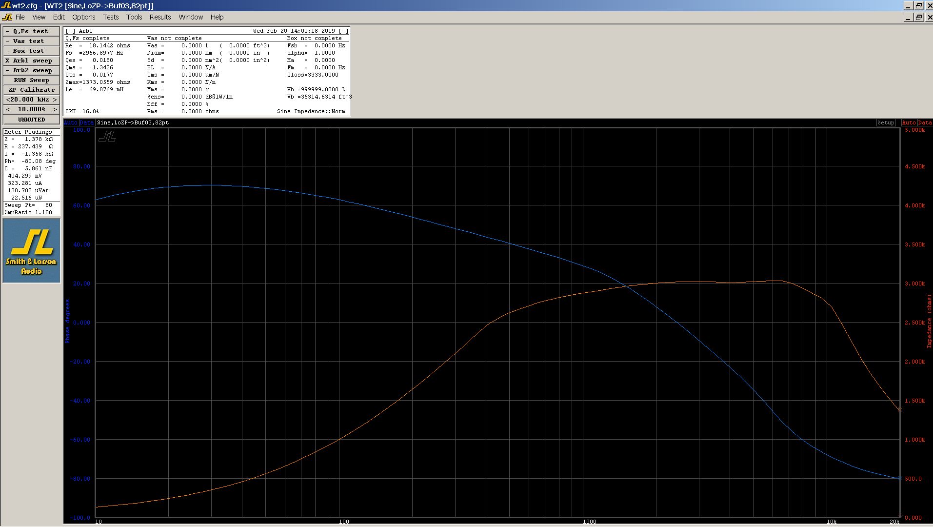

The curve in post #35 above is incorrect. The tester signal was clipping that is why there is a flat spot in the curve.
The curve in this post is correct.
