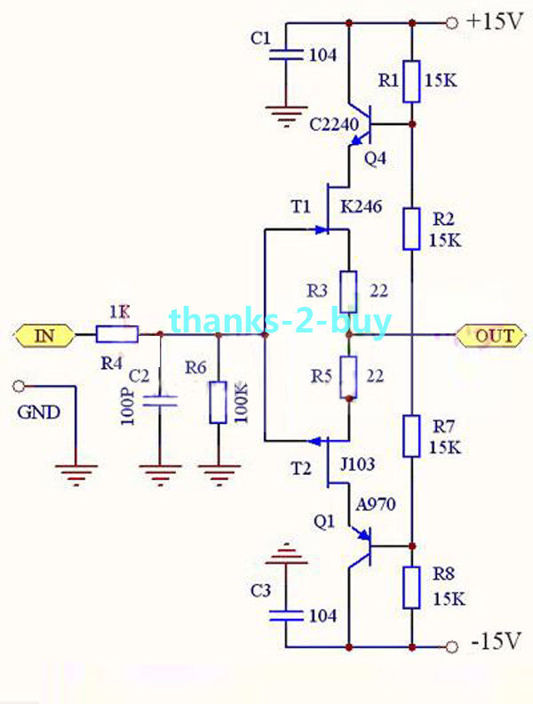

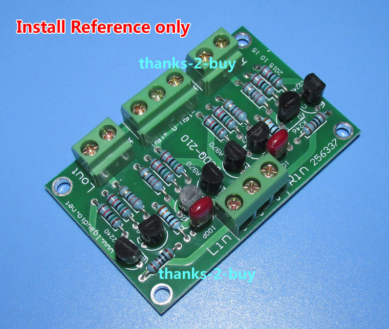

An Aleph30 is sitting on a shelf awaiting a balanced output preamp.
Also sitting on a shelf are the parts for an M2 and some of the pcbs in the attached pictures. The buffer PCBs were acquired from eBay. They have a ridiculously wide frequency bandwidth.
The idea is to have one buffer channel driving an M2 Edcor transformer and a pair of buffer channels buffering the balanced output of the Edcor transformer.
Today I set up an Edcor PC600-15k using a sig gen and a scope. Driving 1/2 of the 600 ohm input and measuring across the 15k winding there is a voltage gain of approximately 9.5 and a -3dB bandwidth of 18Hz to 25 KHz with the output unloaded and the input driven by a 50 ohm sig gen.
Interestingly, the voltage gain is nearly identical to a BA3 preamp that I am finishing for a long-time friend. The parts cost for the M2 inspired preamp will be much less than the parts cost for the BA3 preamp.
Any comments/questions/suggestions are welcomed. Execution of this idea will have to await finishing the BA3 preamp and acquiring or re-purposing some enclosures.

though , through some fun I had making Iron Pre and Iron Pumpkin , I have a strong feeling that you need buffer(s) just in front of iron , no need after
Not autoformer. The autoformer gives you gain of N + 1. For me, N by itself is good enough... and ... I want the input isolated from the output.
So.. it is very simply
unbalanced input => buffer pcb => Edcor => buffer pcb balanced => output
I agree that output buffer is not required. Output buffer is only required if there is a need to drive a low impedance load.
You could call this an unbalanced to balanced converter with voltage gain.
One note is that there will be zero negative feedback which will make this preamp Zen-ish.
You could do this idea with B1 buffers.

These buffer PCBs work well. You could apply + / - 40V with no problem making them useful with an OPS power supply.
The cost of finished working PCBs is so low that it is silly to acquire all the parts and assemble yourself. Unless that is what you love to do.

Would you mind sharing a link for those buffer boards on eBay?
As requested
JFET input Cascoded Buffer Preamp Board use of Toshiba 2SK246/2SJ103, C2240/A970 699970145561 | eBay
Calculate the output impedance of the preamp. How much capacitance can it drive without damaging the HF response? How many feet of interconnect cable is that? What happens when you connect a solid state power amp whose input impedance is 10K ohms, at the far end of a 5 meter interconnect cable?
Good questions. I will connect one of these up and see if I can device some torture tests.
I did perform an output impedance test a long time ago but have forgotten the results. I will re-do and report here.
You could easily convert that circuit to a B1 Rev. 2.
Q1 and Q4 can be omitted, just install jumpers between the emitter and collector of each of them. Omit also R1, R2, R7 and R8.
That is a great idea. I may buy some unpopulated kits and assemble them as a B1 R2. Thanks.
One attraction of the assembled boards is that they throw away 1/2 of the rail voltages. Great for a front end buffer driving a voltage gain stage. You can use the OPS rails.

I encourage you to take more measurements on the PC 600/15k and perhaps other alternatives since key performance factors will somewhat deviate from the M2 due to different mode of utilization. And for output, I woul think the Whammy output stage will serve you much better instead of the tiny buffers.
Regarding the JFET input Cascoded Buffer Preamp Board use of Toshiba 2SK246/2SJ103, C2240/A970 699970145561 | eBay I would not know if the JFETs are actually 2SK246/2SJ103, but if one for one reason or another want to use 2SK170/2SJ74 instead that should be a piece of cake.
Use of a level matching transformer as an autoformer can have performance advantages compared to the normal transformer mode with regards of parasitics and losses.
For best result, an unbalanced to balanced transformer usually use a different winding technique and/or shielding compared to a regular level matching transformer.
One attraction of the buffer board is that it is $11 populated for two channels. A quad of Toshiba 2SK170/2SJ74 from Punky Dawgs is $65 and then you have to add all of the other parts and PCBs. So,.. just investigating a lower cost possibility.
