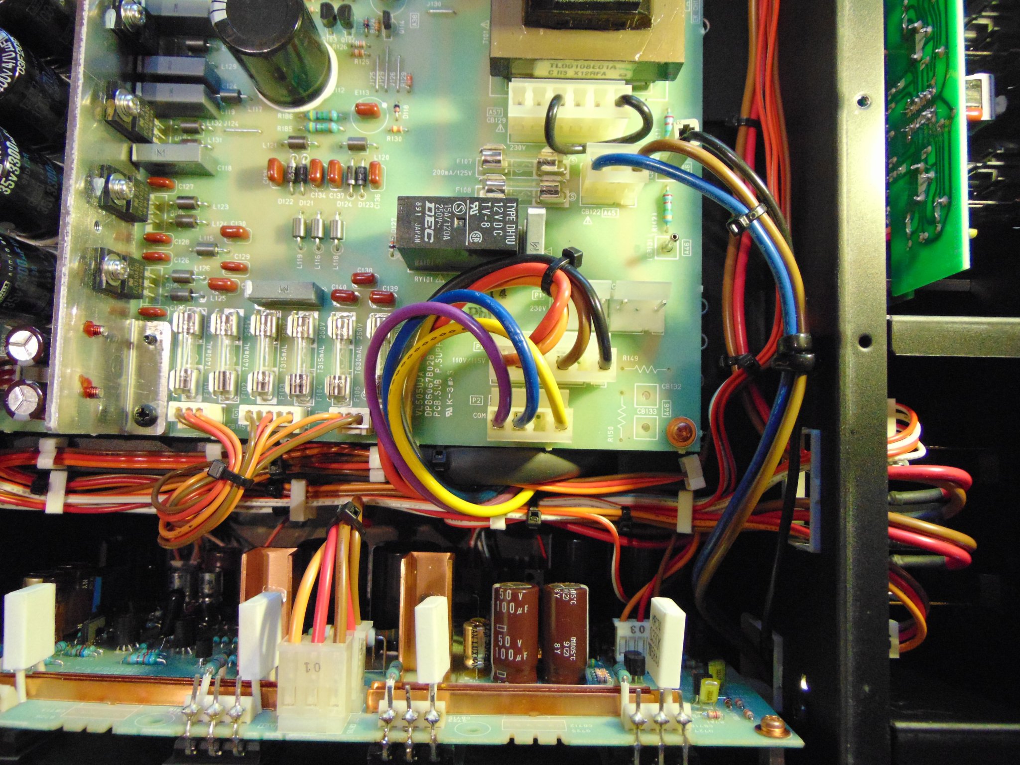

YOU HAVE TO OPEN THE BOTTOM PLATE OF THE THE LUXMAN. THERE YOU WILL FIND IT IS SET FOR 100V YOU HAVE TO MOVE THE JUMPER TO 115V FOR INPUT VOLTAGE. ALSO YOU NEED TO DO THIS.
If you look at the two plugs near the bottom,the violet and blue need to swap position and the red and orange on the plug next to it also need to swap.The blue and red are 100 volt taps.And the violet and orange are the 115 volt tap

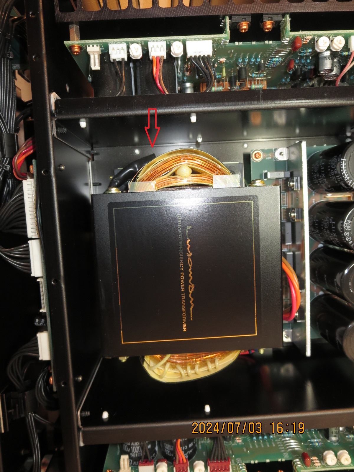

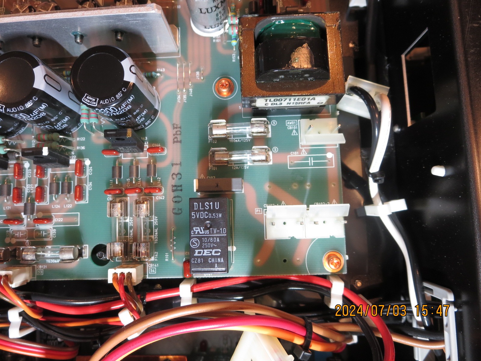

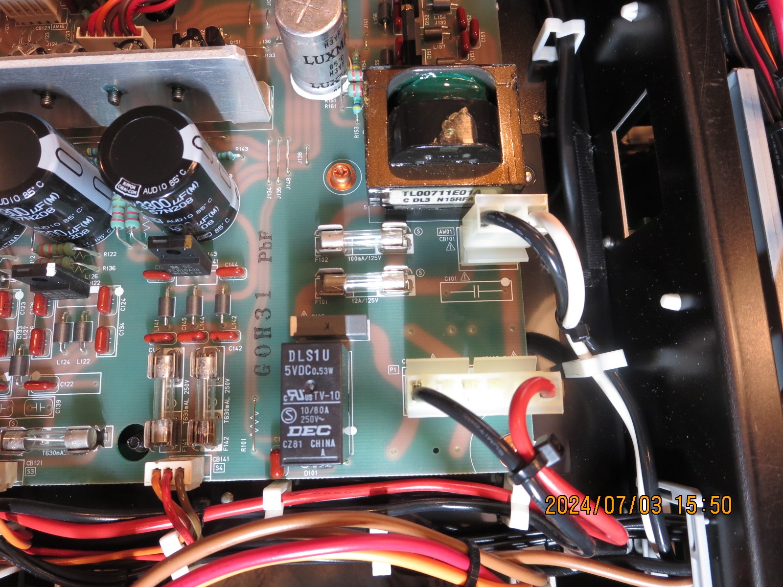

I pulled the bottom plate. It looks like this is a straight 100v product in the configuration that I bought it.
The black and white plug is the 100v power in. It goes directly to the small transformer through the 100 mA fuse and then to the black and red plug via the 12A fuse.
I traced the black and red wires and they go directly to the big transformer in the third picture where marked with a red arrow.
So I assume that I go with the bucking transformer which looks pretty easy to wire in.

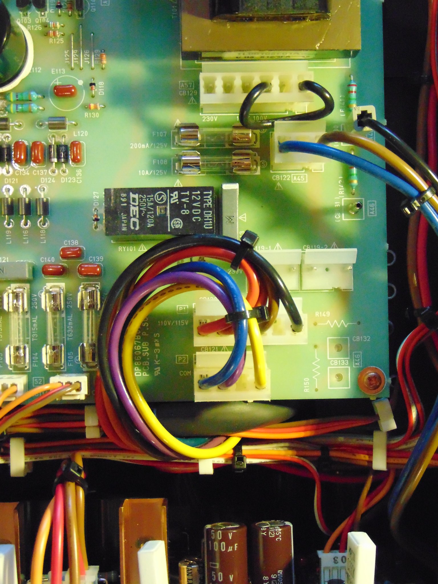

HERE IS LUXMAN LUXMAN L-505U 100V JAPAN VOLTAGE THAT I CHANGED TO USA 115V. THAT BLACK WIRE ON TOP WAS SET AT 100V ON PICTURE 2 FOR JAPAN 100V (136(5) JPG MOVE THAT TO 115V ON PICTURE 1 IS THE 115V OPERATION DSC00144,
FOR 230V YOU HAVE TO CHANGE FUSES AND MOVE IT FROM 110/115V TO 230V OPERATION.

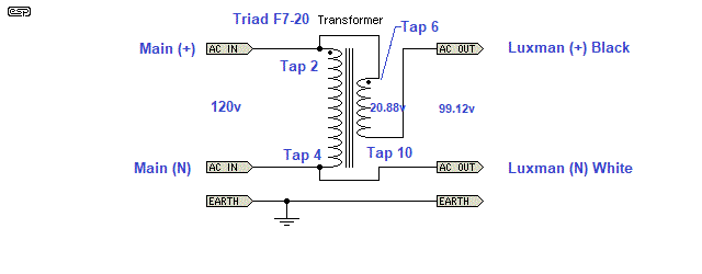

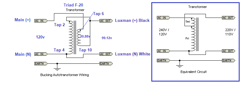

In reading the Rod Elliot article above, the standard way or wiring the bucking transformer is 'Figure 3' and a better way per Elliot is 'Figure 4.' I have marked the Figures using the Triad F7-20 transformer in the attached.
Is this correct? I want to use the Figure 4 configuration as he said that it has less losses.

You got this totally wrong.It goes directly to the small transformer through the 100 mA fuse and then to the black and red plug via the 12A fuse.
The small transformer is only for the st. by function., making a 6 to 12ish small DC to make you able to switch between st. by and ON on your remote control.
The power on (mains to big transformer) is done through the relay next to the power inlet.

Either figure 3 or figure 4 will work fine.
Figure 3 is the same as my sketch in post 16, and Elliot's arrangement in figure 4 had never occurred to me. The figure 4 voltages are incorrect however. I estimate the delivered voltage is about 102V rather than 99V; the explanation is that the primary is driven with only 102 VAC rather than 120V. Consequently, the buck winding produces fewer volts, resulting in larger net output.

I AM NOT SEEING THOSE WIRES TO SWAP ON 550AX. ALSO I SEE RED CHINA MADE PARTS? 505U AND 507U 509U ALL JAPAN AND USA MADE PARTS.
ONLY LUXMAN HAS THE BLACK WIRES TO MOVE THE INPUT VOLTAGE IS L-505U L-507U L550A. THOSE UNITS LOOK LIKE MINE EVEN THE NEW ONES IF YOU HAVE 110/115V 230V CONNECTORS YOU CAN SWAP THE WIRES . THE BLACK WIRE ONLY ON U SERIES. BE VERY CAREFUL IF YOU MAKE A MISTAKE SCHOTSKY DIODES WILL BLOW IN THE BOARD.

LOOKING AT YOUR L-550AX POWER SUPPLY IT IS DESIGNED FOR JAPAN 100V ONLY.BECAUSE 230V SLOT HAS HOLES NO CONNECTORS TO CHANGE TO 230V. USE A NISSYO NDF-1500U JAPAN MADE TRANSFORMER 115V TO 100V STEP DOWN TRANSFORMER NEVER USE TRANSFORMER MADE IN CHINA. LOOKING AT MY LUXMAN L-505U If you look at the two plugs near the bottom,the violet and blue need to swap position and the red and orange on the plug next to it also need to swap.The blue and red are 100 volt taps.And the violet and orange are the 115 volt tap

I guess I'd be inclined to the Elliot configuration. It gives modestly larger delivered AC to the LUX and hence very slightly more available available power/headroom.

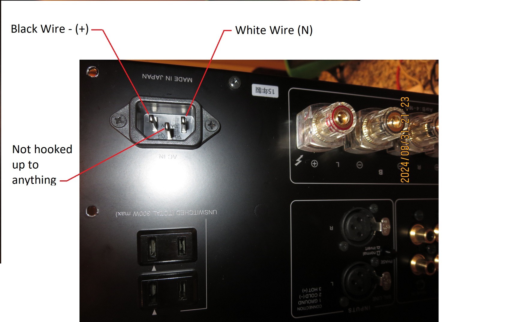

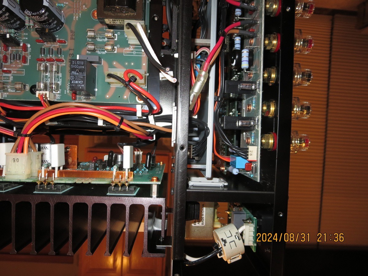

Ok, I finished another project and I am now trying to install the Triad bucking transformer. The Luxman has an IEC connector mounted upside down. Being Japanese it does not have a ground wire. The Luxman power cord is beautiful looking, but it is two prong, not three. I want to wire this for use in the USA with any power cord so two issues came up.
In a nutshell, it looks like in Japan they wire their Type A outlets backwards and use the long pron for (N) and the shorter prong for (+).
1. See the photo below that I took upside down to make this easier. The IEC receptacle on the back of the Luxman is upside down. If I use a USA cord, the 'N' prong on the left that corresponds to the long outlet female on the left is the black wire inside of the Luxman, and the right wire is white.
I just want to make sure that I am correct as it seems that I need to use the white wire inside the unit for (+) to the bucking transformer and the black wire inside the unit for (N) to the bucking trasnformer. I took a second photo with the pigtail from the wire inside of the Luxman where I will splice in some wire and extend to the bucking transformer. You can see the black wire going to two fuses, one high amp (12A) for the big trasnformer inside of the amp and one low amperage (100ma) into a small trasnsformer for the other electronics in the amp.
I know this is a very easy question, but it just feels strange wiring the black to (N) and White to (+).
