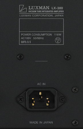

Has anyone successfully configured a 100v 50/60 hZ Japan spec LX-380 for 115v 60 hZ. Been eyeing those on eBay from Japanese sellers. As much as I would love to live in Japan it remains a pipe dream.

Hi, there seems to be no online service manual or schematics for lx-38o so converting it from 100v 6o hZ to 115v 6o hZ can not be advised with certainty. Only thing I know for sure is that the EU version only has 1 primary 230v winding. If you want to know if the Japanese version has dual 100v/115v primary windings you probably have to obtain the service manual first. Or just obtain the usa lx-38o version as that one is ready to use without dangerous trickery.

You plan seems to be difficult when looking at the Japanese lx-38o type plate. Only 100v is indicated where normally the other possible voltages are also indicated if that can be changed internally. Most efficient and safest tip is to buy the amplifier where you live.
