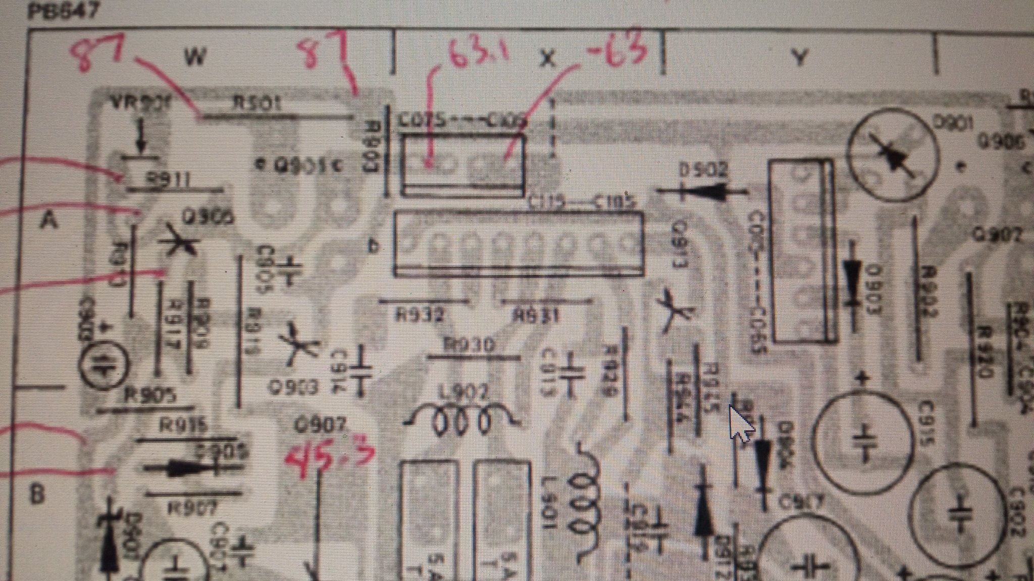

First question: Are the capacitors on power supply module P647 now been replaced?
Second question: in the middle of board P647 I see a setting pot (blue), what is that? because I have never come across this modification before.
I understand from your post that you manually trigger the power supply with a resistor of 4.7K and that the power supply then turns on and that the output voltages are then 51 Volts. And are these voltages adjustable with VR901 and VR902? But this triggering must be done again and again when the device has been switched off.
In the service Manuel you can see that these voltages of 51 Volts are too low in my opinion, and that these voltages should be at least 55 Volts, see fig 6.2.
You can also see that a current of 3mA must flow through the zeners.
The resistor that should regulate this has a value of 2200 Ohm.
A simple calculation Ohms law U=IXR 2200X0.003=6.6 Volt rounded to 7 Volt because the base current of Q903 is also added.
So a voltage of approximately 7 Volts falls across resistor 917. Add the zener voltage of 48 Volts and you arrive at 55 Volts.
In my view, the -4 Volt offset on both speaker outputs L/R indicates that there is a common problem and then I end up with power board P647.
The amplifier should also be able to work with one power output board.

Non of the capacitor changed on P647 PS board. I removed few capacitor from board and then read the values and found different what is printed on the capacitor. What I understand that I should change the capacitors.First question: Are the capacitors on power supply module P647 now been replaced?
In the middle of board there is trim pot. I did not rotate it. I thought it is original.Second question: in the middle of board P647 I see a setting pot (blue), what is that? because I have never come across this modification before
Yes, I manually started the power supply unit through 4.7 k jumper.I understand from your post that you manually trigger the power supply with a resistor of 4.7K and that the power supply then turns on and that the output voltages are then 51 Volts. And are these voltages adjustable with VR901 and VR902? But this triggering must be done again and again when the device has been switched off.
I did not turn the VR901 & VR902 because I was very happy and don't want to change voltage. What I understand that I should trim it if possible to bring the voltage levels to + - 58.
Resistance number please on board P647. Otherwise I will read from manual.2200 Ohm
This is the answer for which I was waiting for, you said single channel will work and must give sound. I removed the inputs of PB649 @ connector C09M >C10M that is I think coming from pre stage to verify that there is no DC bias voltage coming from pre stage to drive stage.In my view, the -4 Volt offset on both speaker outputs L/R indicates that there is a common problem and then I end up with power board P647.

Referring to connector C11M>>>>C18M. Power supply (C18M,17MRed +55 volts then C16MBlue {seems output} then C15MBlack {0 reference volts} then C14,13MGrey {-55 volts}, then C12,11M {48Volts}
As per your guidance voltage should be 48 volts because of two zener diodes on both sides but here volts are 54 on C12,11M these should be 48. Let me calibrate from three trim pots on P647, may be it works. If not then it may be due to damaged zener diodes 24 volts which are in series. Let me find and reply here.

Trimming pot 901 is working and three volts up/down (54~ 51) on CO7S>>>C20S but trimming pot 902 is not making any difference on the voltage on CO7S>>>C20S
This means some problem in power supply.
Regarding left/right channel if I remove any of the pin left side blue, right side white out from connector(C11M>>>>C18M) then amp does not need to get ON with the help of jumper 4.7 k. It gets ON normally.
I think it is due to 54 volts on C07S>>>C10S. Once these volts got controlled to 48 instead of 54 volts amplifier will comes to running stage.

In this case, measuring is knowing
So you have to find out why VR901 works and VR902 doesn't.
The positive and negative power supply are basically the same, only the transistors are different NPN/PNP.
So you have to measure where the differences are between the positive and the
negative power supply and again this problem can also be caused by bad capacitors.
I would start at the front by measuring the voltages with ground as reference and start with Q901/Q902, especially what are the emitter voltages and what currents flow through them and so on. And also measure the alternating voltages on the bridge cell. And what is the ripple voltage after rectification?
And the measured maximum positive voltage of 54 Volt also remains on the low side. Forget that 48 Volt because that is a reference voltage for the power supply itself and is not the output voltages.
The 48 Volt is made with two 24 Volt zeners in series,
one is used in combination with an emitter follower (Q507/508) for the 24 Volt voltages that feed the pre amp.

I replaced all capacitors of PB-647 & PB-649. Very strange happened. When I switched ON the amplifier after recapping a series lamp lights up means something short. It was surprising for me why it is like so. Anyhow all transistors and diodes are ok. Capacitors were all checked before stuffing. Capacitance was fine. I finally removed two capacitors and checked and found minor variation in capacitance. After all inspection I thought I should check it's voltage rating. Printed value of voltage over the capacitors was wrong. I applied the DC voltage through bench top and when I cranked up the current meter start reading up. 100 volts capacitor once reached 65 volts current started increasing. It means the voltage ratting which was printed on the capacitor was totally wrong.
Therefore it is my advice to all that before replacing capacitors one must take the power supply voltage to its maximum DC value keeping the polarity plus & minus as per capacitors. So capacitors must be chosen very carefully. It was very very disappointing.
