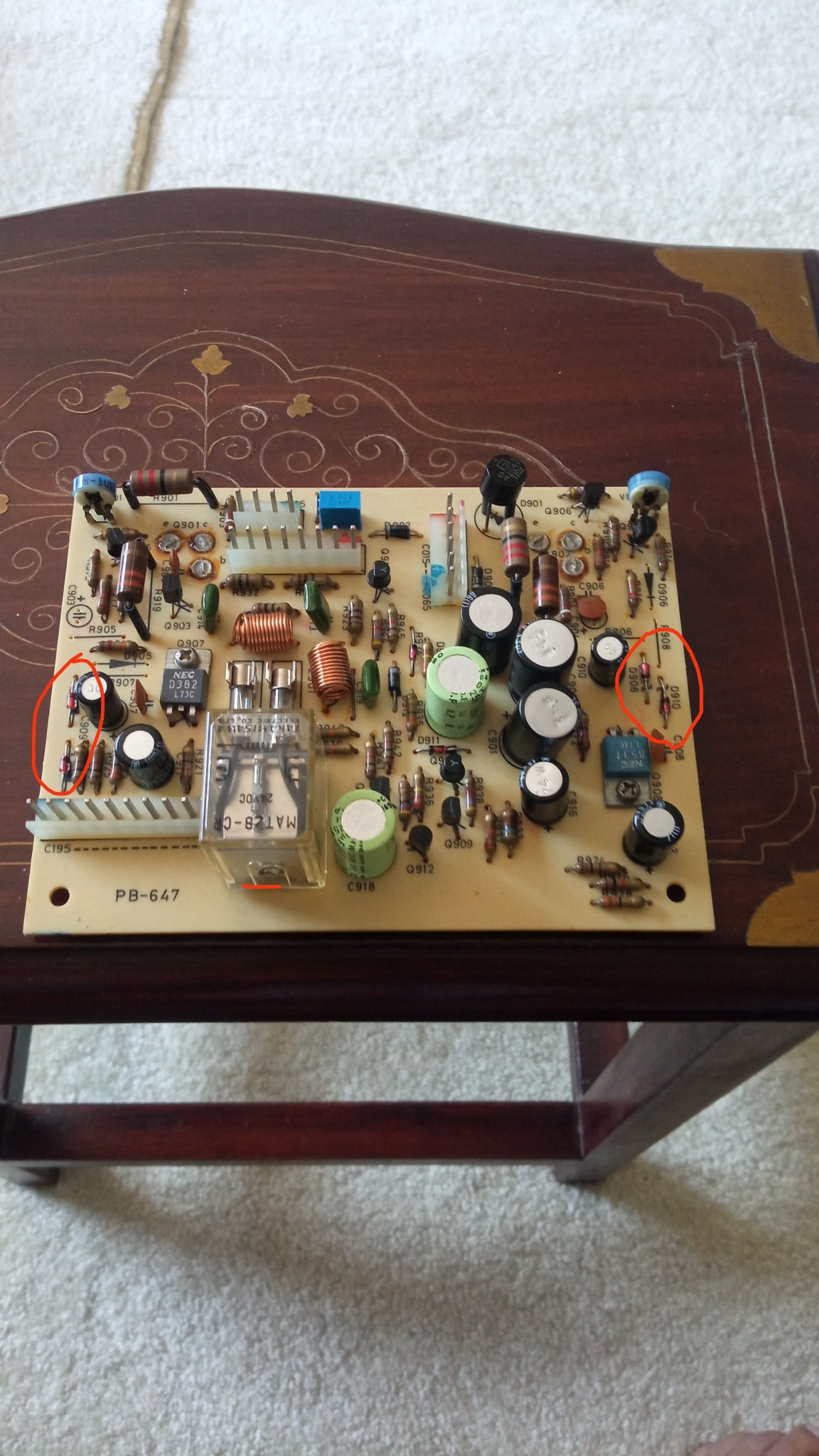

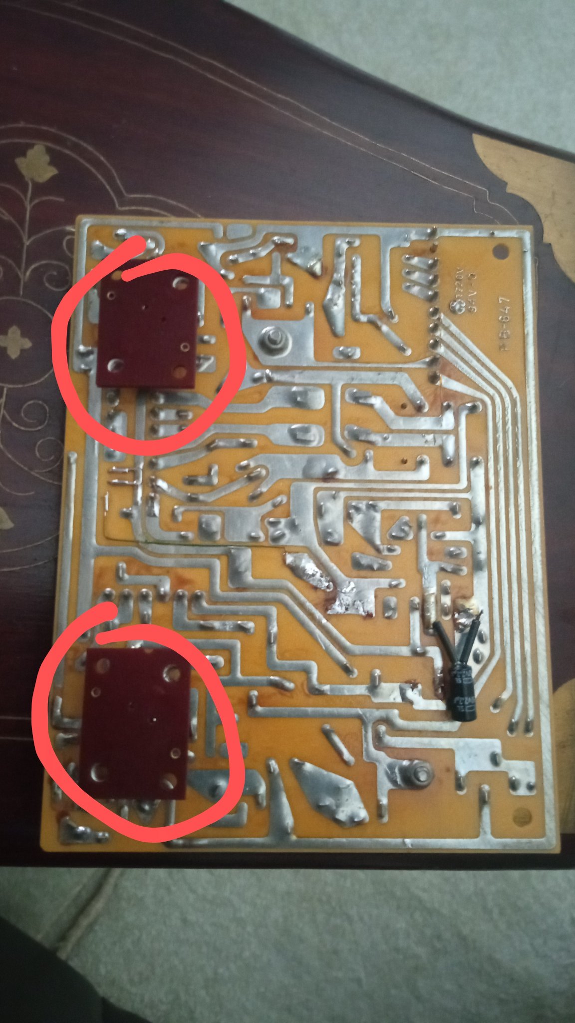

In the newer models of the L100, the startup circuit on board P647 has been removed. On these modified models, the power supply on board P647 is powered op by two diodes mounted on the back of board P649.
Do a Google search for L100 restoration and Flickr has a repair report with 100 photos, where you can see the two diodes mounted on board P649.
Thanks for it. I downloaded all photos but unable to find diodes on the back side PB-647 power supply. Can i try to bypass the startup circuit by adding some bias voltage to the base of any suitable transistor on PB-647 with trim pot.Do a Google search for L100 restoration and Flickr has a repair report with 100 photos, where you can see the two diodes mounted on board P649.
The idea is that in normal operation the power supply reference zeners are powered from clean power on the regulated side. So long as that feature remains intact, an alternative startup circuit is probably okay.

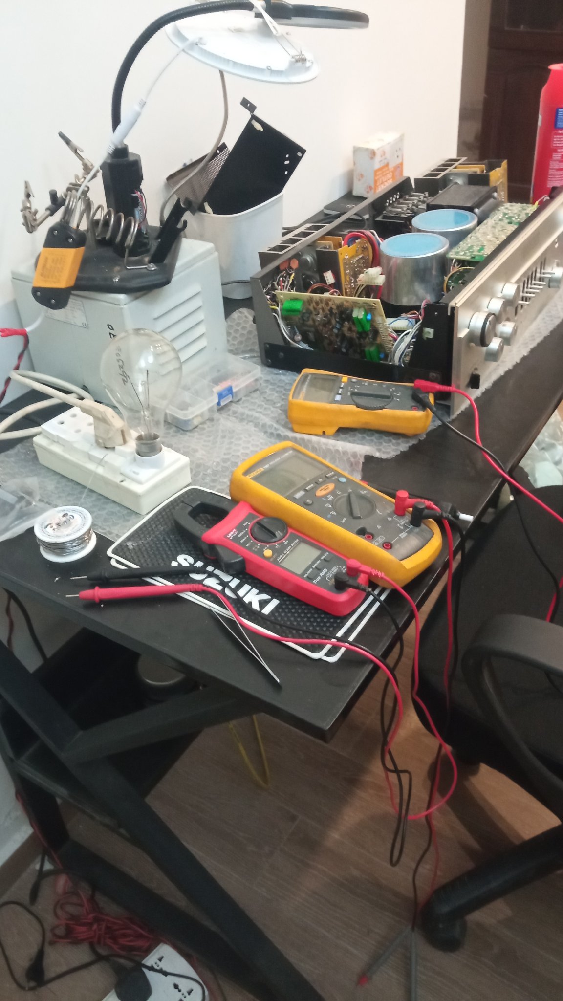

In order to carry out repairs on these amplifiers, it is important to at least use a dim bulb tester as a current limiter in case there is a short somewhere.
Please see attachmentThe two startup diodes are mounted on the back of board P649.
Please see attachment. Picture of PB647 board. Encircles there are only two transistors bases.The two startup diodes are mounted on the back of board P649.

Both the diodes are on the component side. See attachment
I am already using 200 watts bulb in series for over current protection. If use 100 watts bulb then capacitor charging will take more time to fully get charge and has to wait longer after switch ON the amplifier. See attachment.In order to carry out repairs on these amplifiers, it is important to at least use a dim bulb tester as a current limiter in case there is a short somewhere.

Since nobody has found information on how to modify startup circuit on this particular amplifier, I would suggest that idea be abandoned and we return to troubleshooting.
Most of the problems with these amplifiers are known to be due to bad electrolytic capacitors. Also, there is a troubleshooting procedure to start up the power supplies using a 4.7k resistor. Has that procedure been tried yet? If so, what was the result?
Have the electrolytic capacitors ever been replaced in this unit?
In particular, has the startup electrolytic capacitor been replaced recently?
These are basic questions that will lead to the next troubleshooting step, if further steps turn out to be needed.
