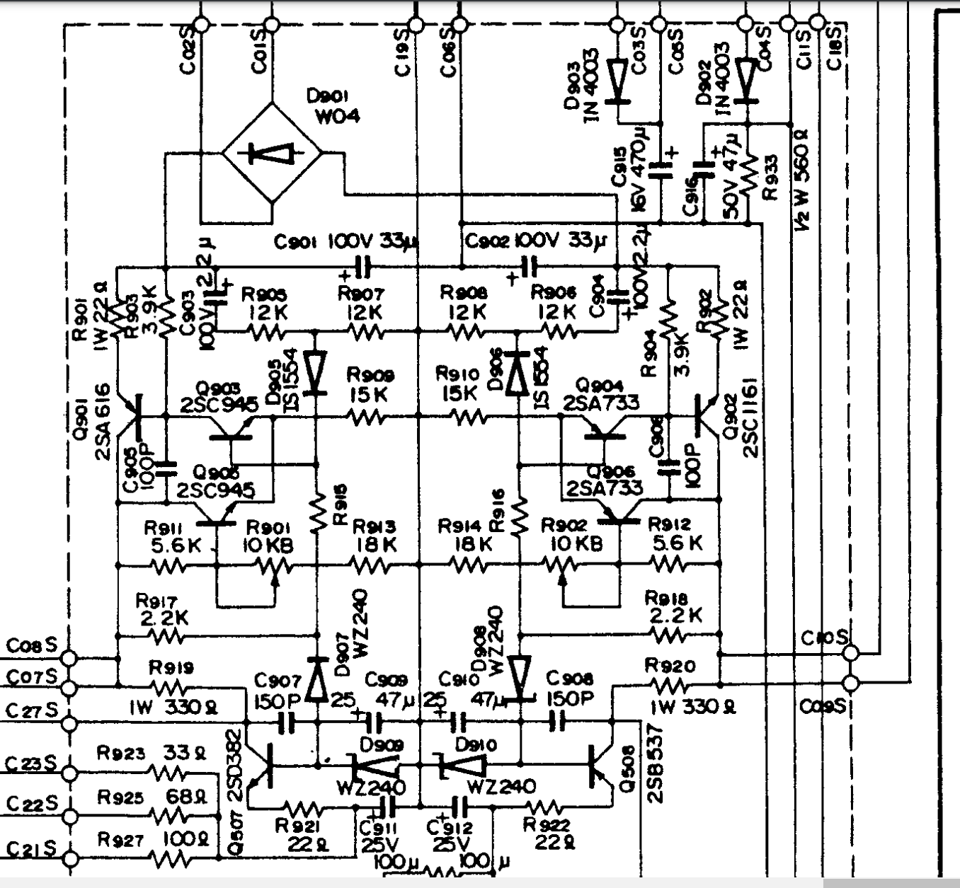

I asked my office people to print page 15, 16 & 17 on A3 size and that is Schematics of this amp. I hope I will get it repaired provided I could find the output voltages of regulated power supply that is used for driver stage. I noted 1.5 volts DC but capacitor C17 on board is 100 volts and 2.2 uF. It means I must know the voltage out from PCB 647 ( power supply) connector C07S ~ C10S. Let me find and dig it by tomorrow. It's late now in my country. I am really thankful to you and respectful to me.

Today is weekend and working on Luxman L-100. I found that there is no power out from PB-647, connector C07S ~ C10S for driver board of power amplifier PB-649 referred connector C11M ~ C18M. Pin# 17&18.
The power transistors, C116 & A653 of PB-647 are not biased when switch ON the amplifier. According to circuitry both transistors must be biased to make the power supply ready for driver circuits of power transistors (TO-03). I think 48 volts DC will excite the driver transistors of PB-649.
When we switch ON ( amplifier main) 122 volts AC appear on connector C01S ~ C06S pin# 1,2 & 8 Volts AC appear on pin# 3,4. If someone let me know the voltage diagram of PCB PB-647, I can develop much better power supply on the same dimension PCB. If this amplifier got operational then I will made new PCBs with test points and voltage in our will be marked on PCB board complete circuit will be digitised and Gerber files will be available for audiophiles on. So much so the schematics will also be digitised on Proteus software. I have complete facility along with dedicated staff who can prototyping PCBs for L-100 but this all is subject to successful repair. As you told that you repaired many L-100 in the past I will be very much thankful if you please share the voltage IN/OUT as per logic. Mute is also not functioning at the moment.

Power supply is described on page six of the service manual. There is a start-up circuit to get it going in the dotted area on the left. After start-up, if the power supply voltage drops out then it should stay locked out until another turn-on transient occurs at the input. They say it should be possible to start it up for test purposes using a 5.6k resistor to momentarily bias on the zener stack.
On page 17 of the service manual the actual circuit (which was described on page 6) is shown:
