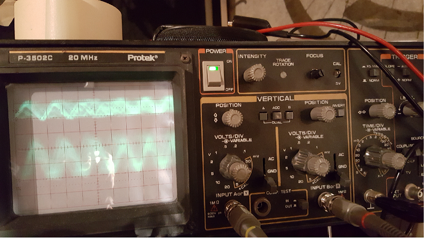

carlmart, it can not be stated enough I am in training on chasing this oscillation issue. The other day I decided to try to oscope through the driver board PB-1079, compare R channel to L channel .
No signal in and bias level on L channel set low so no oscillation should be ocurring. Hung X1 probes on signal out PB-1079, Q205 collectors, image attached. Channel A top signal is right channel out, Channel B left signal out. Interesting that there is a signal difference in amplitude.
Played for some minutes and powered down and came to the conclusion that hanging the probes on the signal output of PB-1079 caused oscillation on the output transistors, they were warm.

Calmart, that oscope image from thread #73, 8/8, there is no input signal. That image taken using X1 probes are the right and left channel PB-1079 outputs to PB-1080. Amp idling with gain pots at minimum. The vertical scale is .5V/div.
This will be reset up again using X10 probes to see what it looks like.
