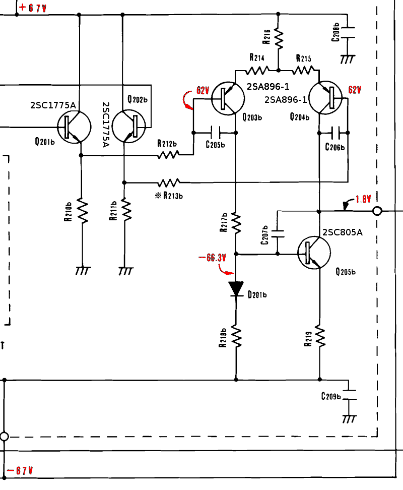

Did check output from PB-1079 to PB-1080 and measured -57V. So you were suspicious of this. Would be interesting to determine if this is being caused by PB-1079 or PB-1080.
Disconnected connection between PB-1079 and PB-1080. High voltage still present on the output of PB-1079 and the input of PB-1080. Ohming out Q-205 on PB-1079 in circuit:

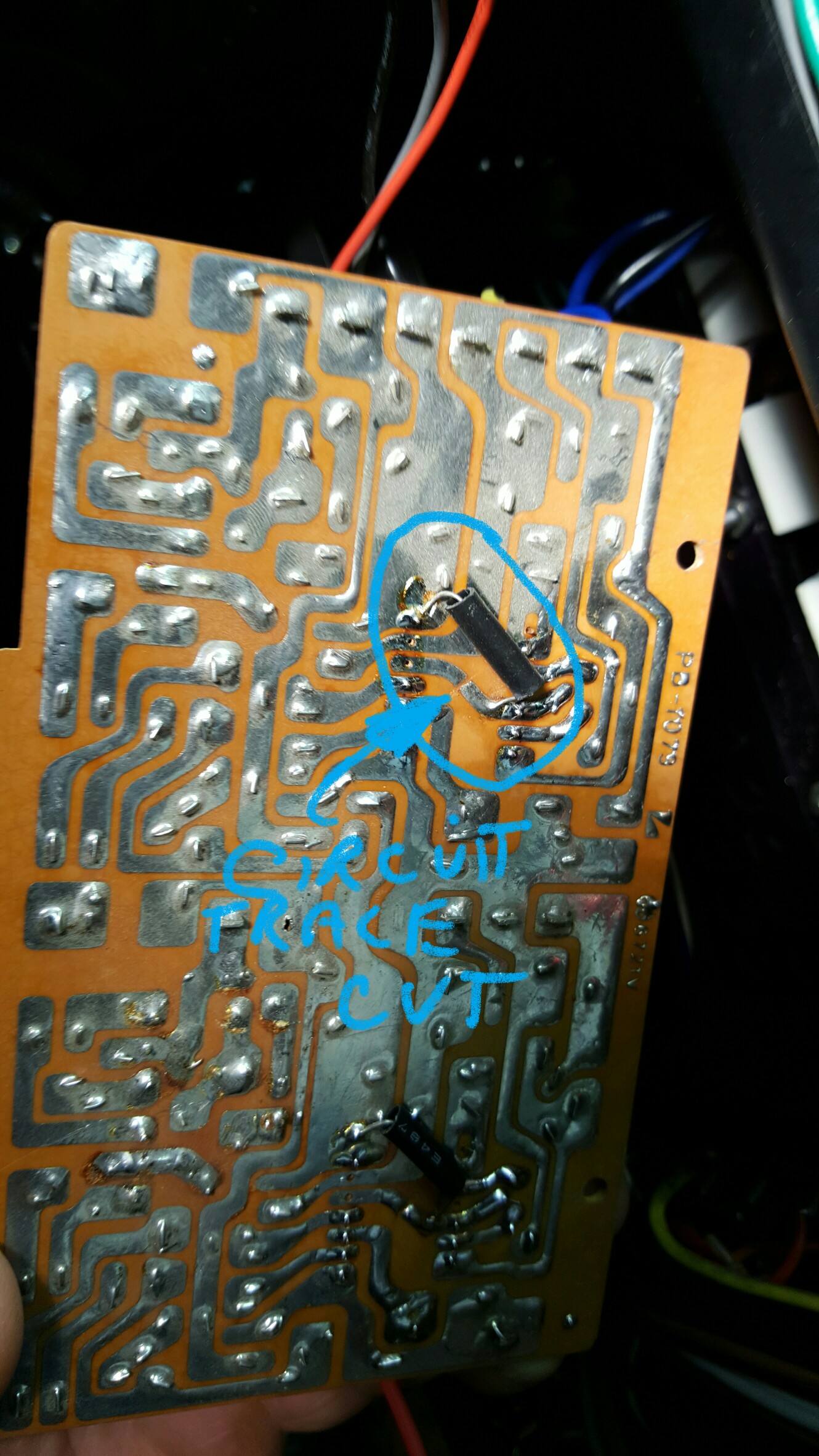

There was a component on the bottom of the PB-1079 board connecting two of the DML pins. It was in shrink tubing, not sure if this left the factory that way? A trace that would have connected the two pins was cut through and this component now spanned the cut through, both channels are similar. On the right channel the one that has rail voltage on the output one of the leads of this component had become detached. Before reconnecting could not get the +62.4V at the input of Q201/Q202. After reconnecting the lead required voltage drop is present. Checked most of the voltages on PB-1079 and everything seems to be as required other than measuring +64V at the collectors of Q204/Q205. This is with the signal output wire between PB-1079 and PB-1080 disconnected. The schematic shows that should be less than 2V.

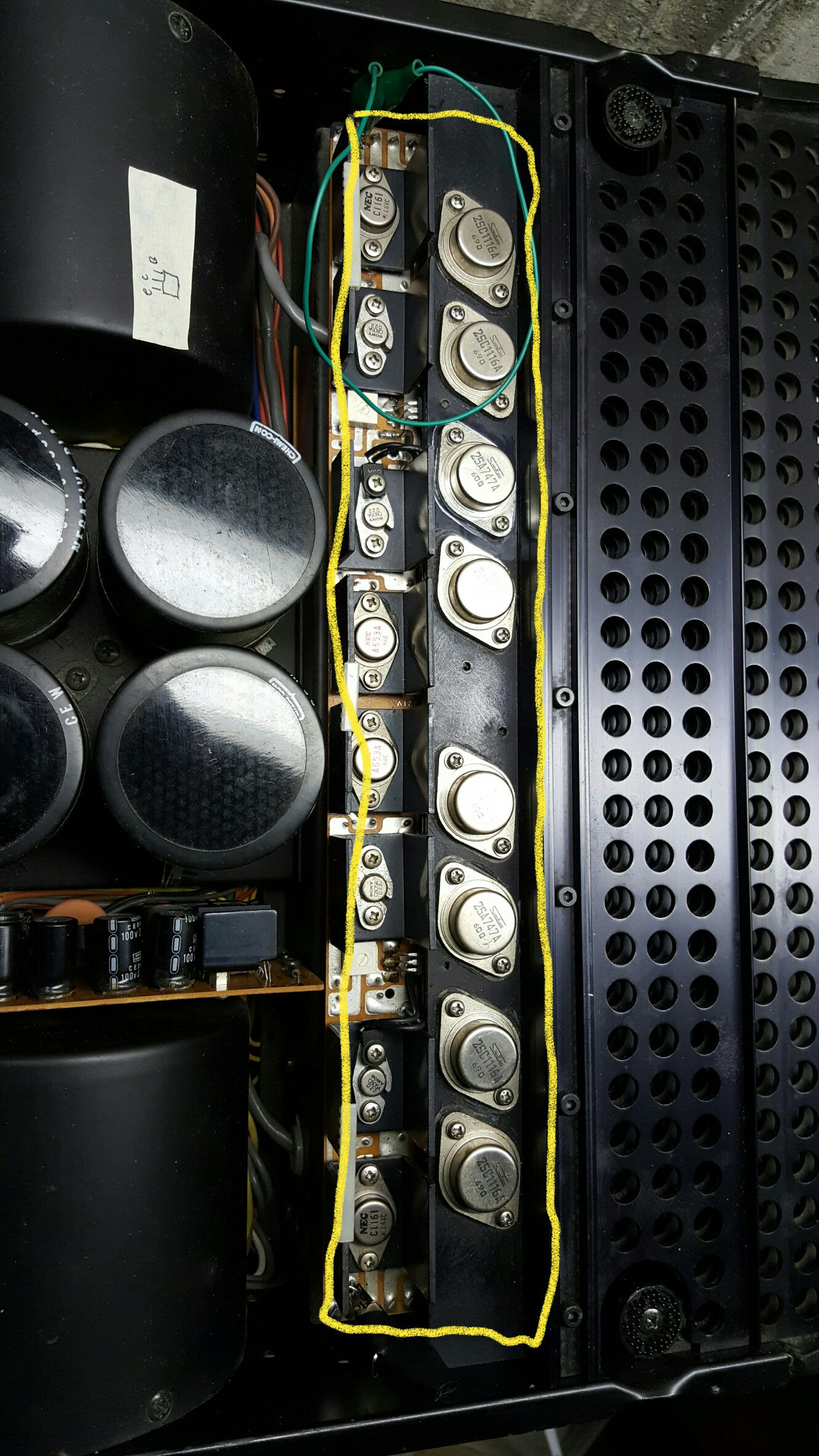

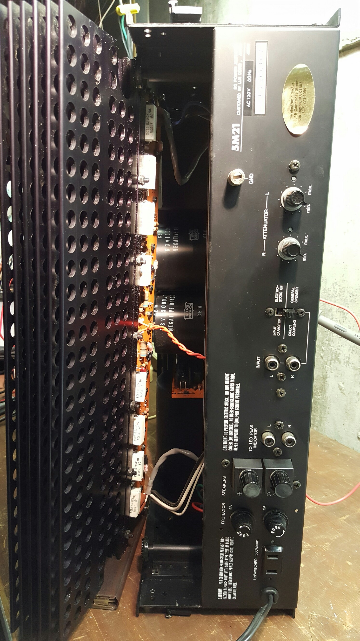

This leaves me the input card PB-1079 to diagnose. Thanks for the suggestion i was just tearing into the amp for possible work to power card PB-1080. Figured out how to remove PB-1080 and heatsink. Might be helpful as we move along.

Image of backside of PB-1079 showing the component and the trace that has been cut. Looking at it now the component doesnt span the cut trace. The trace cut is between pins 5 and 12. The sleeved component which measured 120kohm in circuit spans pins 5 and 2.

SSgrossklass, there is +64V at the output of PB-1079. The output should measure 1.8V. So connect the feedback to the +64V?
Shouldnt feedback be close to 0V?
Shouldnt it measure 1.8V there before connecting anything to the output of PB-1079.

If that's the spot that the collector of Q205 connects to, yes, that's correct. Voltage at this spot with the feedback open is generally hard to predict, except it tends to slam into one of the rails.
