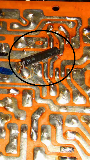

Got bold and hooked up PB-1079 output and feedback correctly and amp comes out of protect with 100mV of DC.
Will solder these connections and adjust DC offset.
It must have been the disconnection of the resistor lead mounted on the back of the PB-1079 board.

Good to hear you got that sorted. Which resistor did that disconnected lead belong to? Something in the feedback, I guess...

The resistor was a factory oops. They soldered it on the backside. No thru holes available. It connects two of the DML pins and without it correct base voltage for the first and second input transistors can not be achieved.
I looked into the schematic and the pcb, and I realized the solder side resistors is the LTP constant current source, which should be 120K or 121K. Right?
Sorry just got around looking at this. The circuit trace between pin 12 and 5 was severed and a 118Kohm resistor soldered between pin 14 and pin 5.
Yes, because that resistor is the constant current source resistor, which should go from trimmer mid point to -V.
In the 5M21 I know that resistor is 120K, instead of 118K. A negligible difference.
Luxman forgot to put it on their schematic. I wonder why or what for.

Glad you had me look at the resistors again. Decided to clean this side of the board, still need to resolve the oscillation issue. While cleaning one of the resistors a lead lifted, was not soldered properly. Cleaned up this area good and resoldered the lead.
