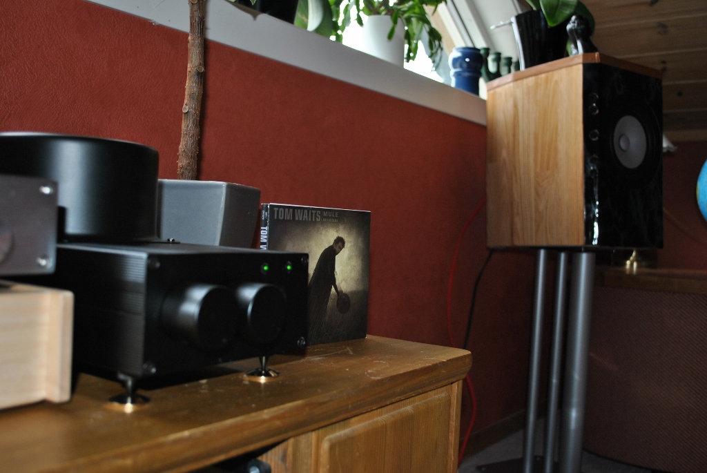

The big speaker is the Alp10,2 in FHXL built in pine (oiled) and the front is a kind of wallpaper.... Not so bad...

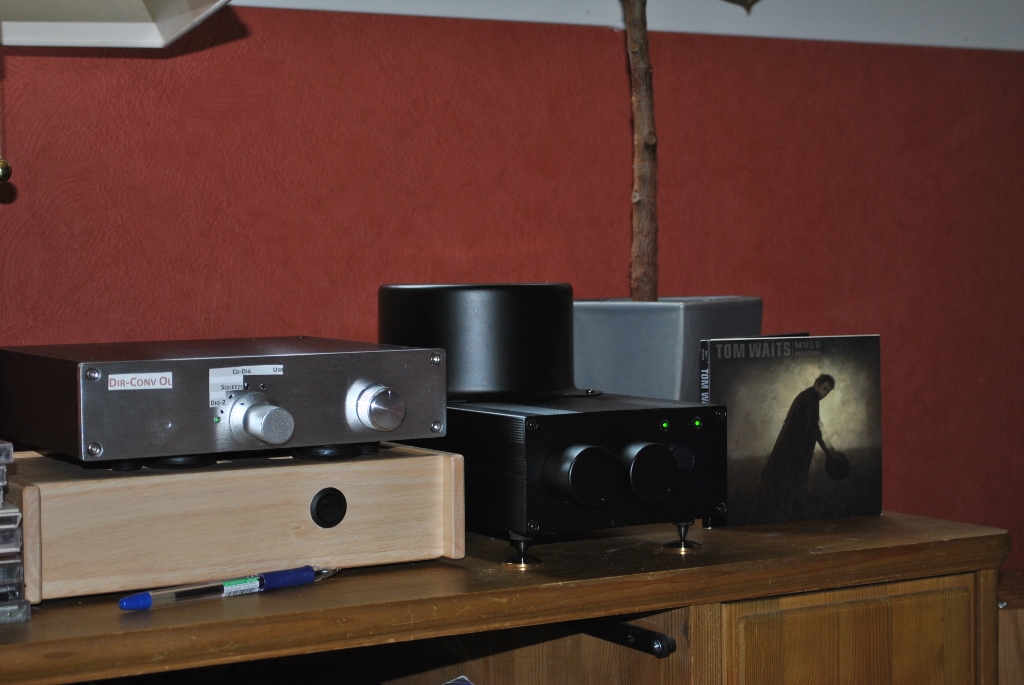

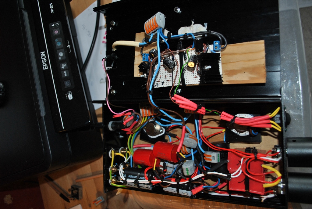

Redressing my Lum.....
Slowly recovering from my hospitalization – which seems fairly succesful(doctors said). Now 6 months with chemoterapy has started. And 6 months or more with sickleave!
But even though I`m somewhat more tired than ordinary, I found the days to be VERY long(have to rest 1 hour every day) – so I started my replacement of some components on this remarkably amp.

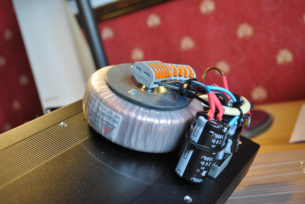

My first version was very good, but there was a loud humming from the trafo that was amplified through the chain. I moved the trafo, bridge and the electrolytics on the psu-section on the top under a round trafo-enclosure. THAT killed all the humming. Then i replaced the resistor on the gate with a thinfilm resistor.
So now it is dead-quiet and very involving. It has so much air around each instrument – so you can focus on each in relation to all else. While I did the remounting/changing I used my old B1 preamp – and even though it is very good – it does not distingues each player and their instrument with such vivid presence as the superb Luminaria! Part of this is maybe also because the SitClone with 2SK82 – which is also a single stage performer AND also a nice project that Michael has been kind to offer us diy-ers.
So the whole chain is short and simple – toward my Alpair12 in Fonken enclosure!
Once again – thanks Michael for your effort in our search for the good sound!!
Best to all
Olav

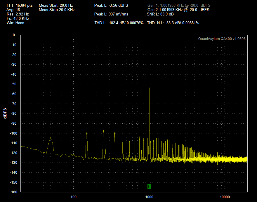

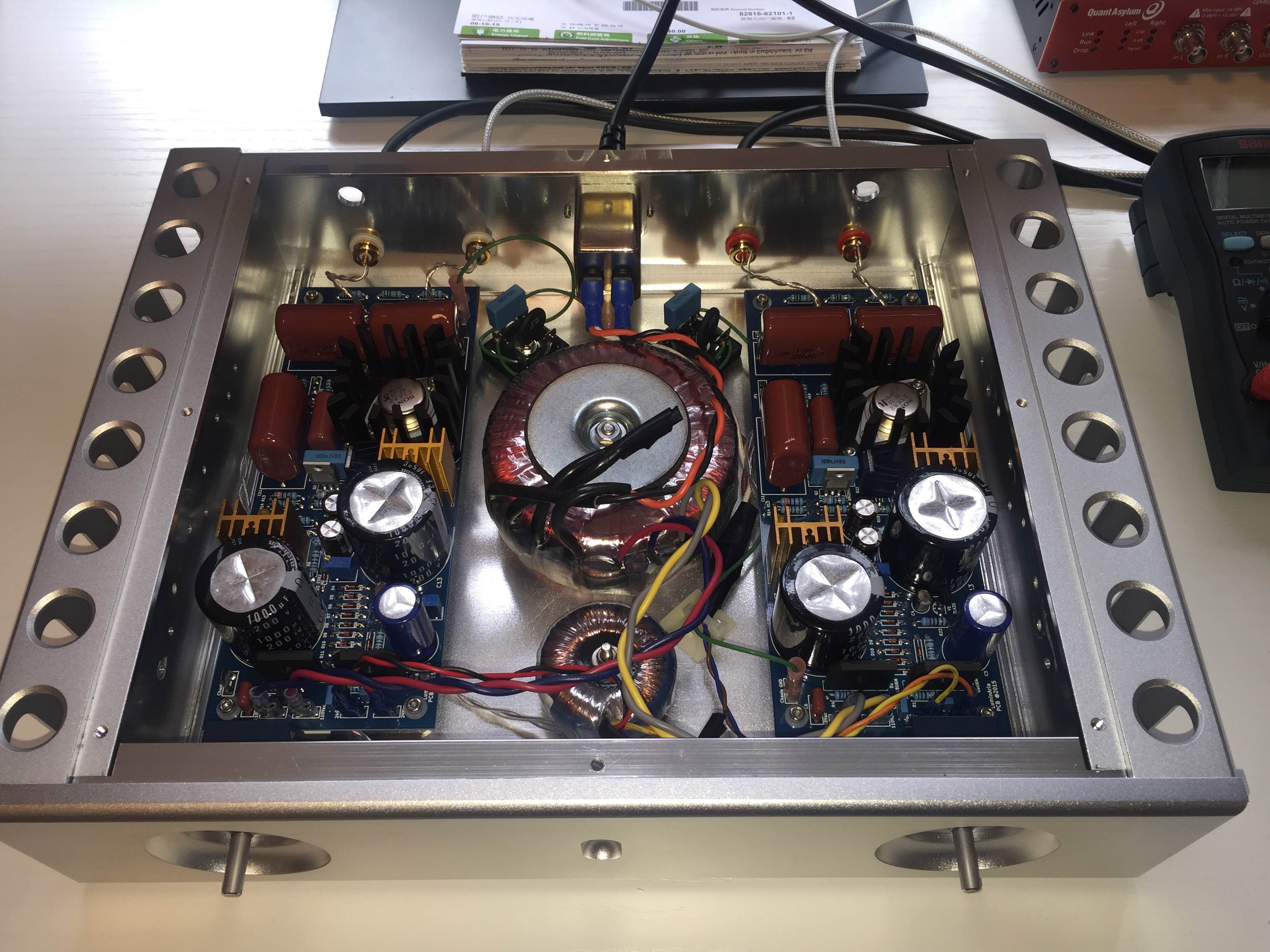

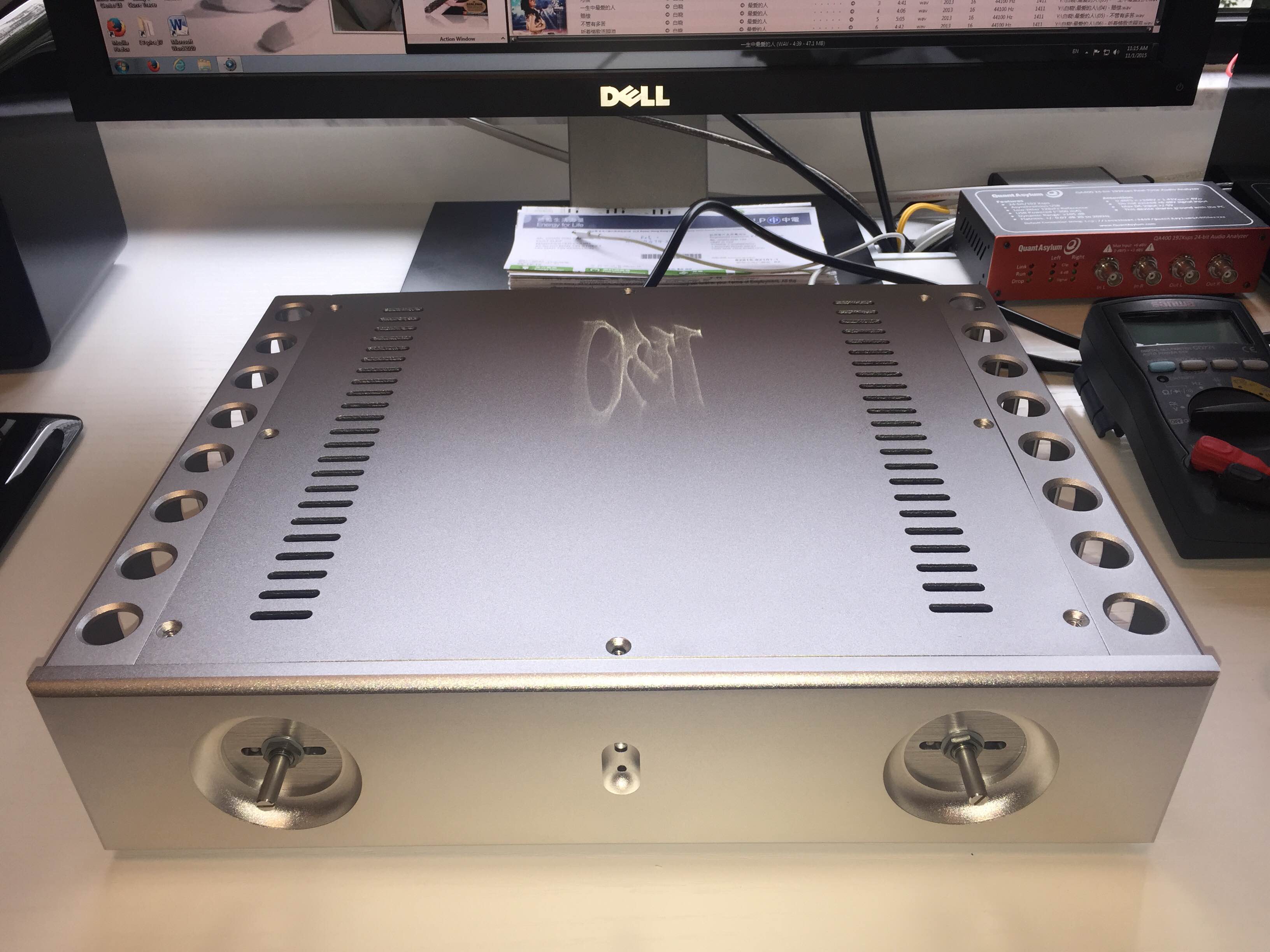

I've made a few posts in the Lab Hangout thread about my LuminAria build, and I think it probably makes sense to add a post here, to record that one more LuminAria has been built (actually this is still a test channel, waiting for some components to build the 2 production channels).
A few things I noticed:
Attached is the board and the THD measurement, it's a amazing that a non-feedback circuit can reach such a low THD
- I tried 10 different pieces of 2SK82 in circuit, most can reach 10-12ppm THD, but one cannot go lower than 30ppm.
- All 2SK82s I tested are having lowest THD when Vds is between 60-70V
- 7 2SK82s are having lowest THD with 65-85mA Id, while 3 2SK82s are lowest at around 50-55mA.
- The gain of all 10 pieces are different, but gain of some are within 2% of one another.
- I selected a pair with similar gain and 55mA Id (to lower heat dissipation), and then use different B+/Id to equalize the gain. No need to use source degeneration to adjust gain at the end.
- The actual THD drifts between 8ppm to 12ppm, but at such low THD I guess it doesn't matter anymore
I like that case !
Hi Tim,
That is a nice layout. I also built Lumiaria and listened to it yesterday. Yes this is a fine pre amp, and as parts are breaking in it sounded different today. I am waiting for the film resistor for the drain load and I expect even better change. The sound reminds me a 10Y DHT pre, but without the microphonic, residual white noise, and hassle for the heater setup.
I could do this with your PCB design. Since I have two PCBs that I can spare, may I give this to anyone who is interested?
Chul

Wow! Really spectacular work there, Tim. PCB's, chassis, all top notch
Thanks Michael for your nice design, pairing it with the 2SK180 L'Amp right now, sounds like heaven but too much heat dissipation (200W) with the L'Amp so I'm building a scaled down F4 to see how they match.
