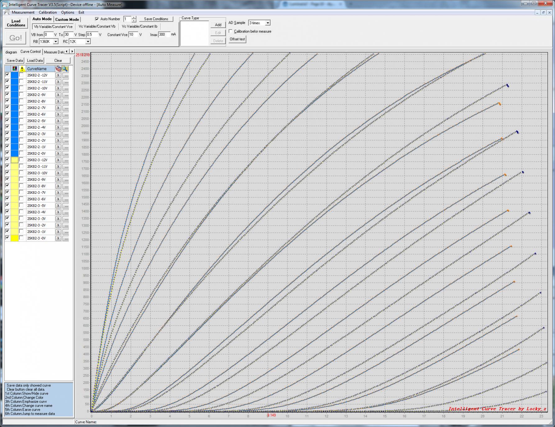

I only have 4 pieces of SK82 and the curves for best match among them is attached. Would they be OK for a Luminaria ?
Yes I think that is good enough. The problem is more If the measurement and the reality will fit....
To get the gain whatever it is more equal I suggest to augment the source resistor a bit with the SK showing higher gain until the gain is equal.
But I did not do it myself and I do not know if there is any drawback.
Good luck!

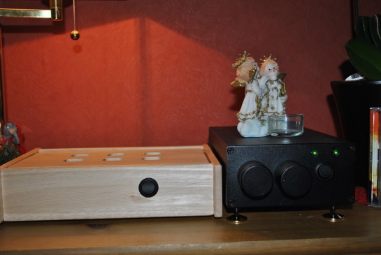

First class sound....at last
My LuminAria at last
And what a revelation it is: The sound is so much more dynamic and gives much more presence and involvment with whats on the CD or streamed media. Compared to the very good passive Pass-B1(and the LuminaAria is the oppsite of passive – it digs to the bone and lifts my SIT mono to new heights)....so it is more lifelike and gives a fuller sound. But it is also twice as powerful in output – so I have more headroom with my Alpair12P. With the B1 it was no problem running it with the vol-pot full throttle, but with the LuminA it can be earblowing. And that is when both is driving my monoblocks SITs (the resistor version of Làmp – Michael Rothacher nice build) on about 7-8watt.

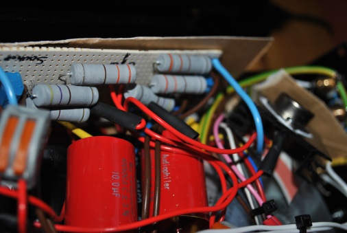

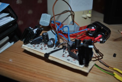

I have only one pair of the 2SK82 and they where somwhat different in caracter – so I had to try (and burn) some drainresistor before I got a fairly even result. Not quite perfect – but you will not hear any difference between the channels! Thats a FACT! And my experience of the newest investment is: everything got bigger and more involving – so you are sitting close to an ensemble and enjoying live music. So touching the music got!
Here are the measurement:
Right Channel: Id=52,5mA
Drain/Source=89,4Volt
Source/Earth=23,8Volt
Gate/Earth=5,6Volt
Gate/Source=18,1Volt
Rdrain Right after some adjustment: 635 ohm/15watt – 3 serie/parallel CarbonComp each 5watt
Left Channel: Id=52,5mA
Drain/Source=90,5Volt
Source/Earth=23,4Volt
Gate/Earth=7,7Volt
Gate/Source=15,6Volt
Rdrain Right after some adjustment: 565 ohm/15watt – 3 serie/parallel CarbonComp each 5watt
Tried with (metal film)2 x 1200ohm/2watt = 600 ohm/4watt + 1 42ohm/1watt = 642 on each channel – but the resistor started to smoke and it was difficult to get the right voltage/current on the left channel!
