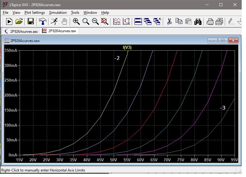

Seeing that I have some 2P926 SITs, I used Michael Rothacher's app to trace the curves of VladimirK's SIT measurements. I regenerated the curves using the LTSpice model and the results are close to VladimirK's measured curves. I have also tried the model out in a couple of choke loaded preamp circuits in LTSpice and the results look reasonable.
Hope this is useful to someone.

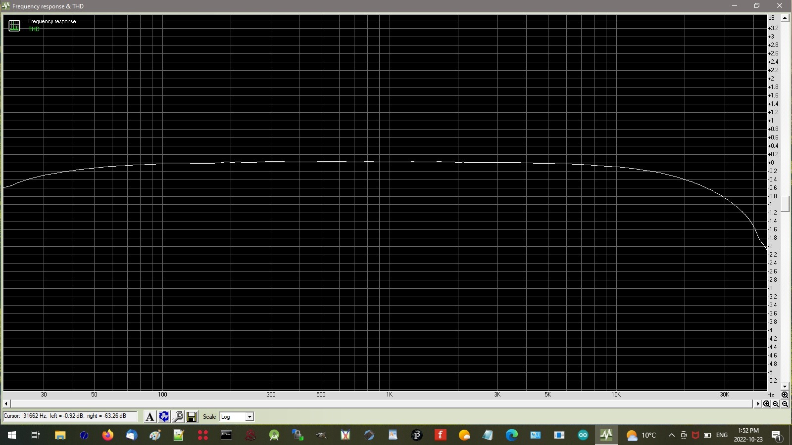

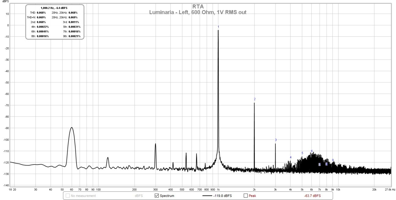

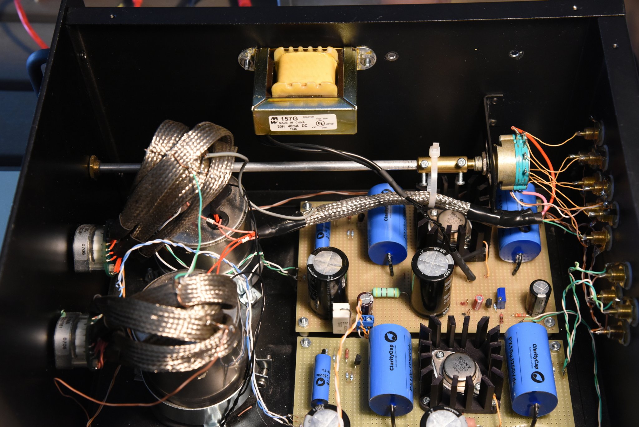

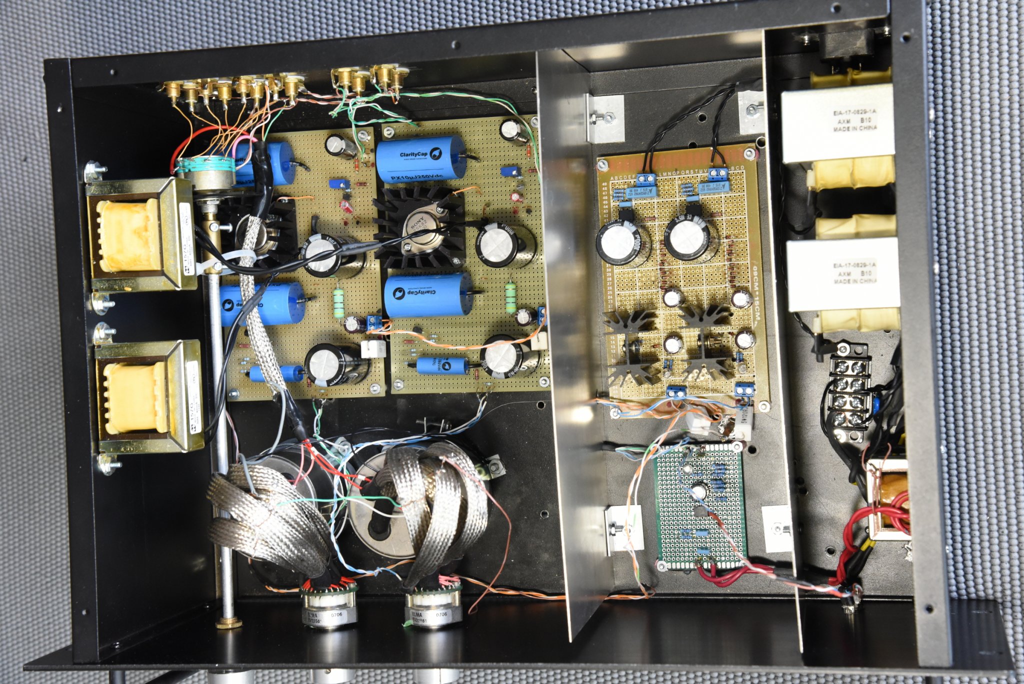

I had a Hammond 157G choke on my work bench, so I decided to install it in my LuminAria, just to see how it would work. I have used the 156C as the choke load for VFET gain stages (and it works great), but I wanted to try out the larger (but less inductance and more expensive) 157G. The 157G is a 30H, 40mA, 570 Ohm inductor and can be easily substituted for the 600 Ohm load resistor in the LuminAria.
I did not change the 2SK82 operating point so it is still at the original 116V 53mA. This is a bit over the 40mA Hammond speciification for 30H, but I wanted to keep things as constant as possible between the two variations.

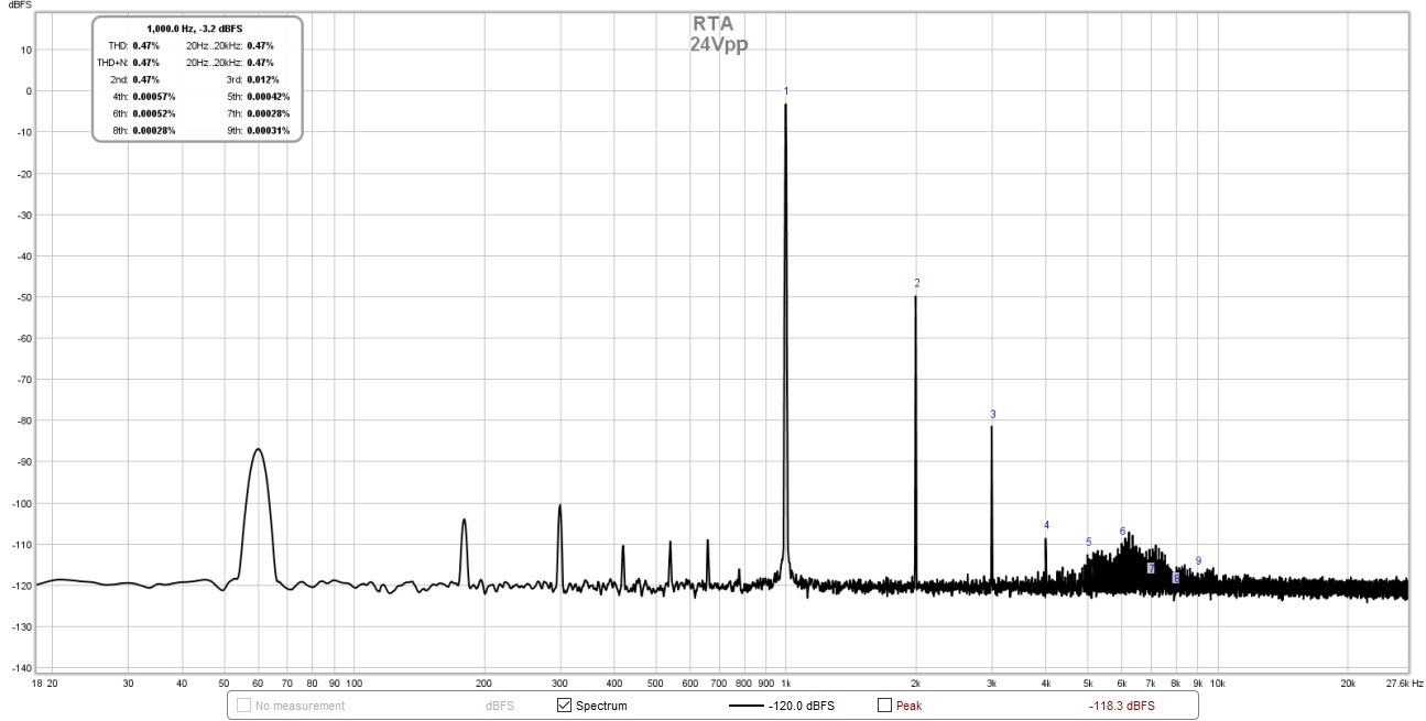

I have included the before and after FFTs and the frequency response with the choke load. As expected, the distortion dropped with the choke load.
I am going to stick the split personality LuminAria into my system and try to compare resistor versus inductor in mono mode and then the combination in stereo. Should be interesting. Or not.

I listened to this new configuration last night, both in separate mono modes and in stereo. In individual mono modes, I could not discern any differences. It takes some time turn down one channel and turn up the other, and my speaker setup from left to right is not totally symmetrical. Any differences between the resistor versus inductor load, to my ears, are not apparent . I really didn't spend much time doing this as it was obvious that I couldn't tell any difference.
Listening in stereo was enjoyable. I don't know if it was better or worse, but the music was flowing. I especially liked Miles Davis' KInd of Blue, where soloists appear in left, right, or centre stage at different times. This let me hear music from different channels without having to play around with the controls. The sounds from all presentations were equally fine.

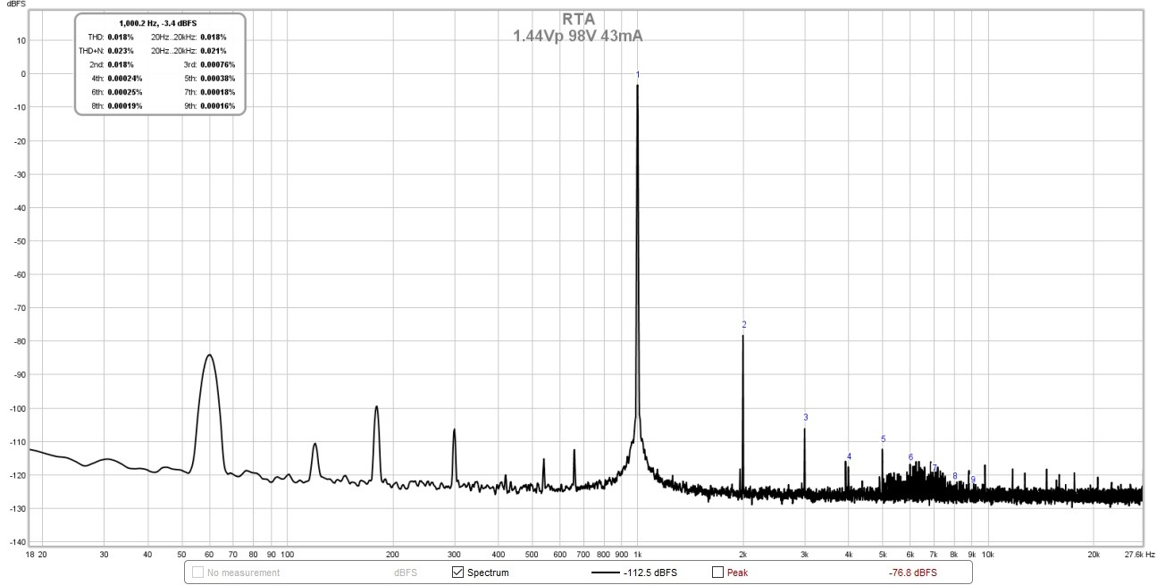

Going to try changing the operating point of the choke loaded 2SK82 to see what sort of distortion numbers can be produced.

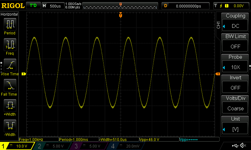

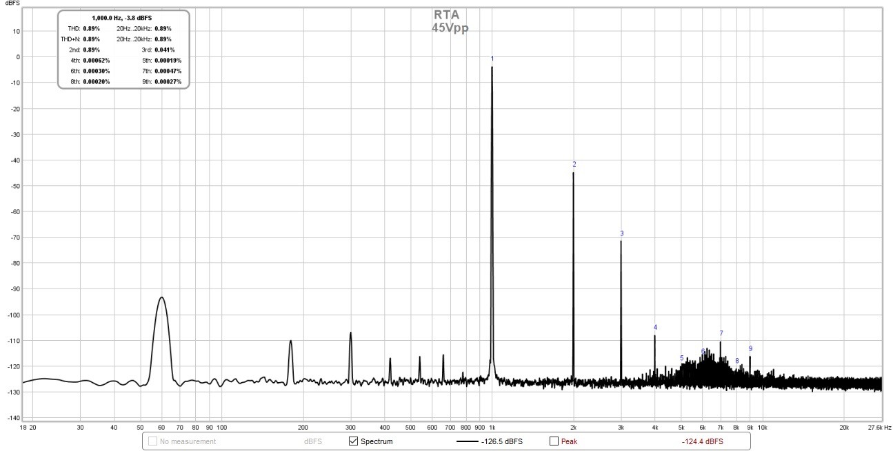

I did some more measuring today. I cranked the output from my 1kHz oscillator to max and fed it to the inductor loaded channel. The resulting output was about 45Vpeak-peak. Repeated for 24Vpeak-peak output.

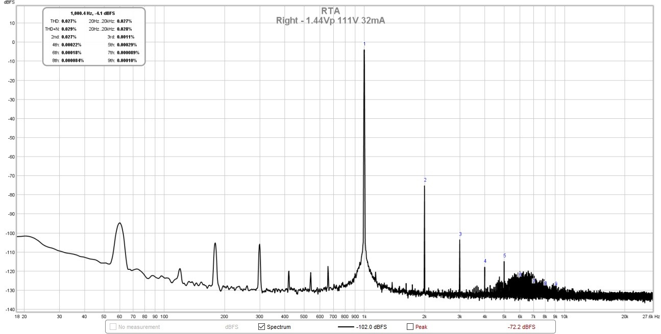

Next I played with the 2SK82 operating point by changing the Vgs. I finally settled on 97Vds, 43mA. This lowered the distortion a bit from the previous operating point of 116V, 53mA. Not a lot, and probably not noticeable in listening.
I replaced the load resistor in the right channel today with a Hammond 157G choke, so both channels now are choke loaded. I reset the bias for minimun distortion resulting in an operating point of 111V, 32mA. The distortion on this channel is higher than the left channel but still within the same order of magnitude. Again, it is appreciably lower than the resistor loaded version.
Now, I can listen for awhile and see if I can draw any conclusions about the change from resistor loading to choke loading.
