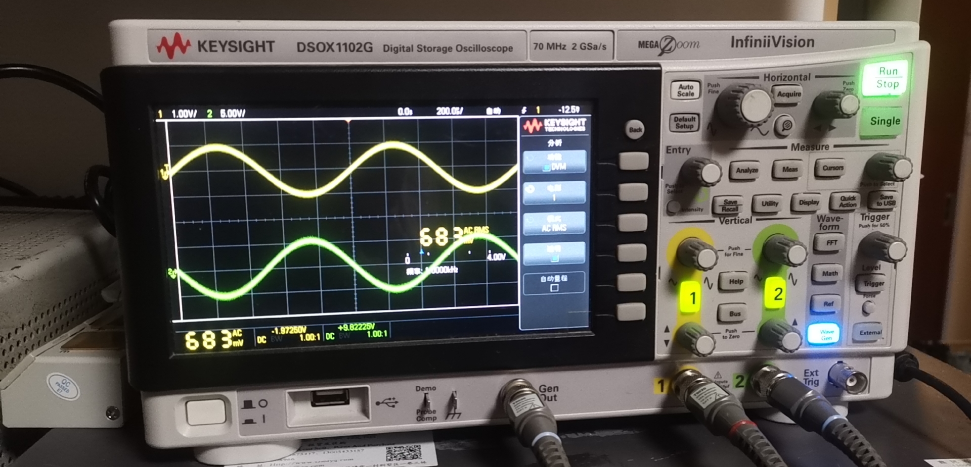

Ok found it, 20H inductor (1700R DCR), 120V B+, 2K (or 5K pot) cathode resistor bypassed by a big cap, 10uF output cap. Bias around 8mA.
THD approx. 0.05% @ 1V, swings 20V+ peak.

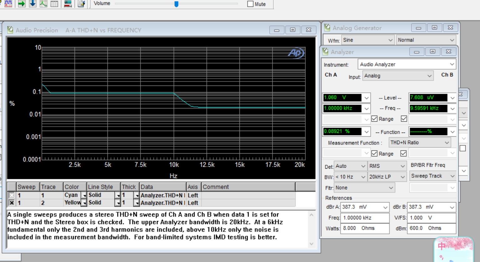

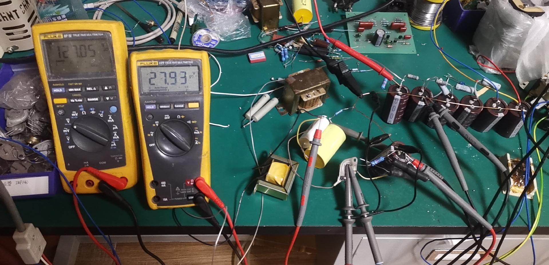

ok,just follow you and did test,gain 15db and thd a litter bit high
Bravo! Load down the output to work the load line (perhaps 2-5K resistor), a little fiddling with the bias and B+ and Bob's your uncle. 🙂
Looks promising, thank you for sharing. Do you plan to develop it further, include Michael's suggestion etc. Please keep us in the picture if you do.
Yes,I just purchased the 5K Pot to adjust it.the part should be arrived this weekend and will keep continue to do it.thanks
Thanks for the update and keeping us in the loop @Adams_Leo, I'm sure a few of us will be watching your progress with interest.
