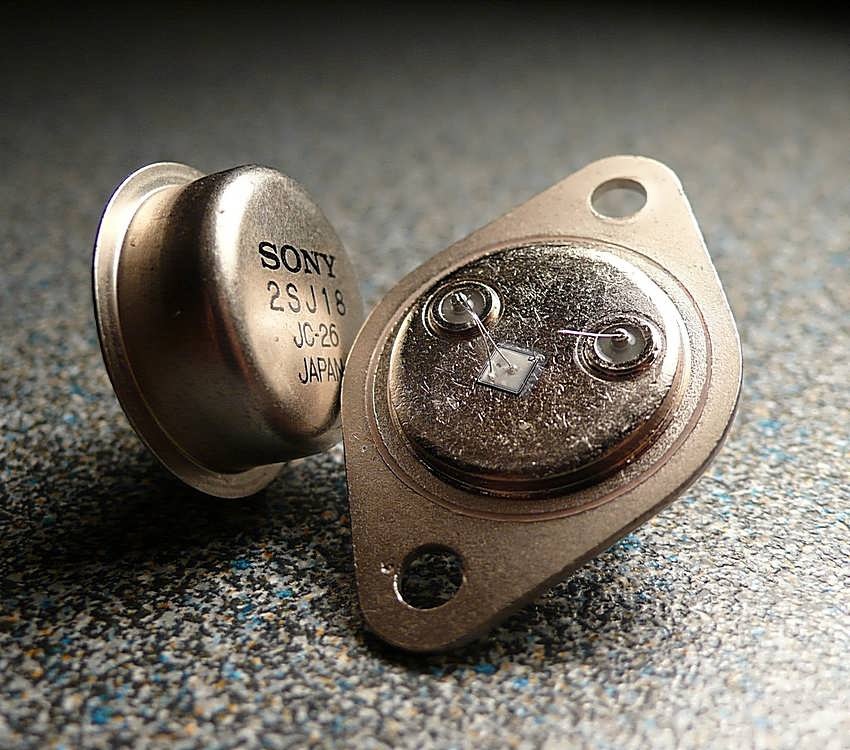

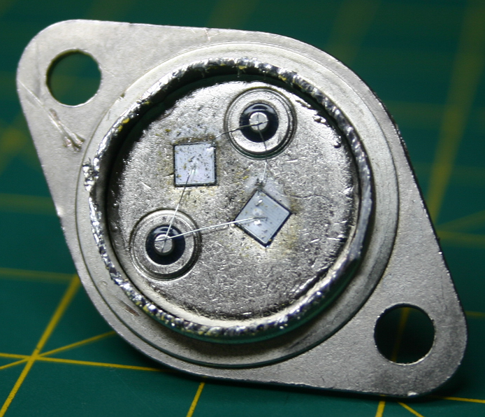

Rumor has it that the 2SK60/2SJ18 (single die) are exactly half a 2SK82/2SJ28 (twin die). The electrical data suggests the same. 2SK60 capacitances should be about half of the 2SK80 iirc.
The attached pics show the internals of a 2SK82 and a 2SJ18 (Not my doing!).
I was referencing datasheets rather than rumour, however, I suspect that there will be rather more to it than simpling saying one transistor junction in the device instead of two means half the capacitance.

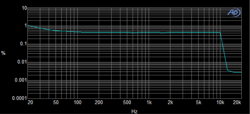

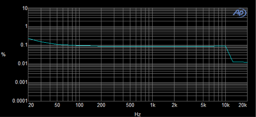

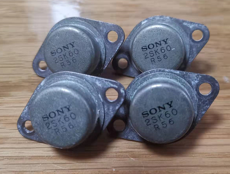

I finished some testing of the 2SK60 the rank is R56.
1. Work piont,VB+=120V,VD=112V,Vgs=26.32V,Chock Load,L=26H(DCR=0.713K),Source Resistor=4.1K
2. THD 0.0876@Vout=1.058Vrms,THD=0.431%@Vout=5.291Vrms,THD=0.862%@Vout=10.56Vrms,THD=1.291%@15.84Vrms,THD=1.71%@21.12Vrms
3. GAIN=14.4db(5.3)
The performance is really good and thanks Mike.I also have listen this preamp,the sound is my cup of tea. Fantastic!!!
attached test some data.

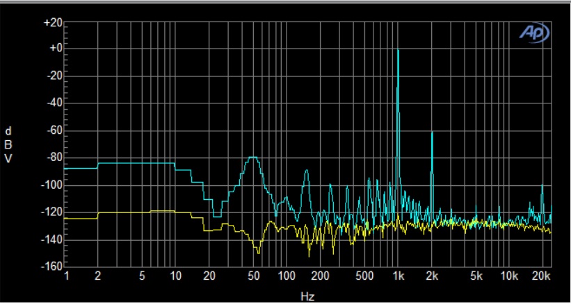

The frequency response is input 200mv rms.For the FFT picture please ignore the yellow line due to this is the channel B,but I do not hidden it.

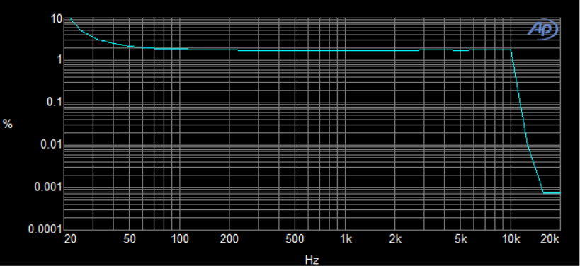

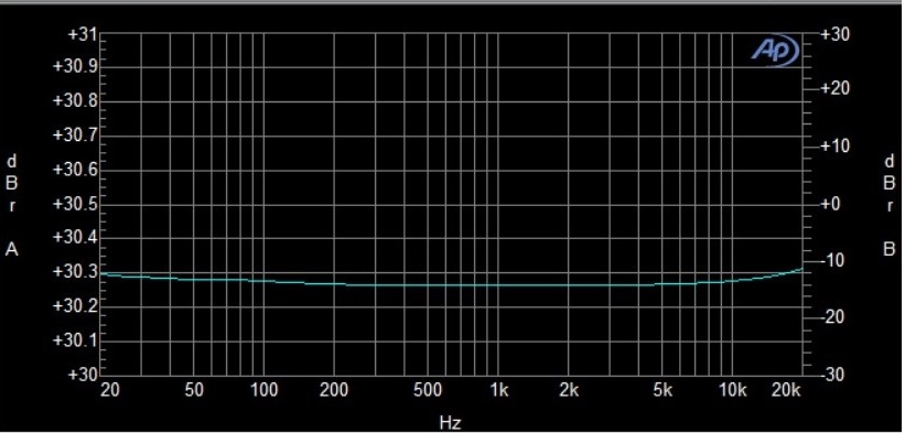

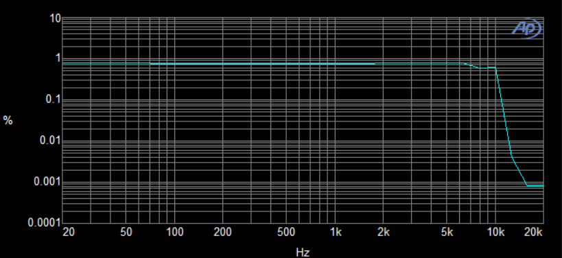

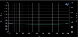

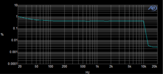

The KP926 is excellent part. I mean using to drive the follower output stage.
1. Really high output voltage swing. 32V rms output,but the THD+A only 0.766% and 40.47V rms output,THD+A at 1.984%.
2. Enough gain,very easy to get more than 8.3 times gain.
3. Very low distortion,THD+A 0.0158% @1V rms output and most of is the second harmonic.

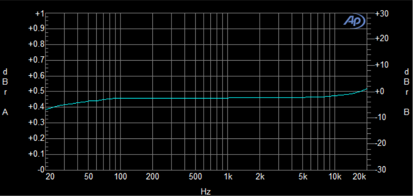

4. Ciss is high,Vladimir get from Russia datasheet show 2500pf,but if we add Mikes's org buffer is enought.the buffer output impedance only 33.3 ohm.this is enough for the widely frequency response.
attached two test curve,one is the thd+a at 32V output and another one is the frequency response.the source impedance is set a 30 Ohm.
