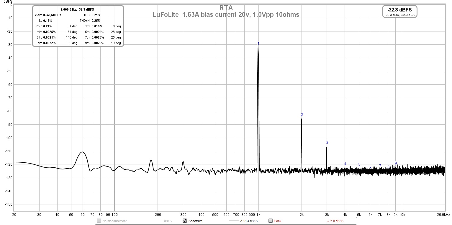

I did a quick FFT of the LuFoLite with halogen bulb today and as we can see, it resembles the output of a SE Class A amp with triode like behavior. There is only 2nd and 3rd order harmonic distortion and this is for driving a 10ohm dummy load to 1.0Vpp - a typical level for moderately loud playing on a headphone. The THD is about 0.21% and the 2nd harmonic is about 20dB higher than the 3rd harmonic. This is for 20v rail, 13v source and 12v at the lamp below the inductor with 1.63A bias current:

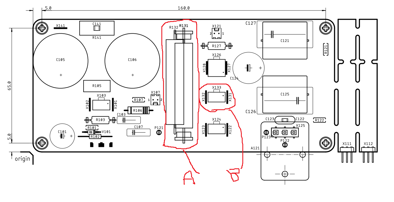

I have a question about selecting the R131, R132, X133 (X131, X132).
option A :
R131 - 3 x 3ohm 10w (dayton audio DPR10-3.0 3 Ohm 10 Watt Precision 1% Audio Grade Resistor) stack using X111,X112 stack helper board
option B :
R131 - 2 x 3ohm 10w (dayton audio DPR10-3.0 3 Ohm 10 Watt Precision 1% Audio Grade Resistor) stack using X111,X112 stack helper board
R132 - DNR-3.3 3.3 Ohm 10W Precision Audio Grade Resistor
Is proper these options?
Any other options?

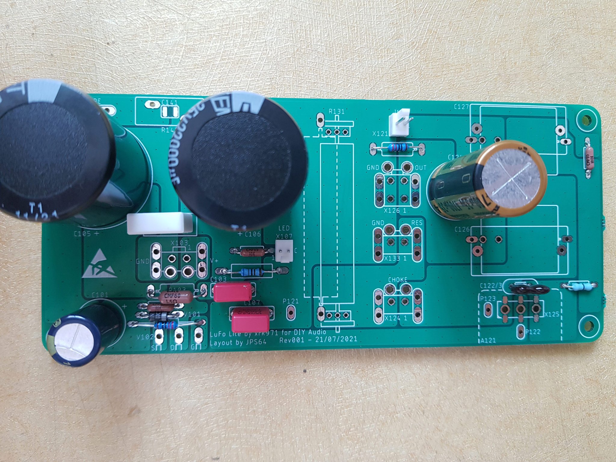

.... and... some progress.
C141 581-02013D223KAT2A is quite small .. so I will order 80-C1210C223KBR instead.
The shared Lufo amp mouser shopping carr by Vunce (#195 of Lufo amp thread) helps selecting molex connectors.
For C121, C125 instead of C216. C217, I will purchase 4 pcs Mudorf 2.2uF 450Vdc Mundorf MCap EVO Capacitor or 2.2uF 400Vdc Mundorf MCap MKP Classic Capacitor.
https://www.hificollective.co.uk/catalog/evo150-22uf-450vdc-mundorf-mcap-aluminium-p-9128.html
https://www.hificollective.co.uk/catalog/mkp240-22uf-400v-mcap-polypropylene-capacitor-p-8524.html
If you can get an opamp and buffer to have a harmonic profile like this, then it would sound similar. But the SE Class A profile is different than an opamp. Some say, sweeter, more natural. But “better” is in eyes or ears of the beholder. The distortion THD is certainly much higher than an opamp, but that’s not the point.
