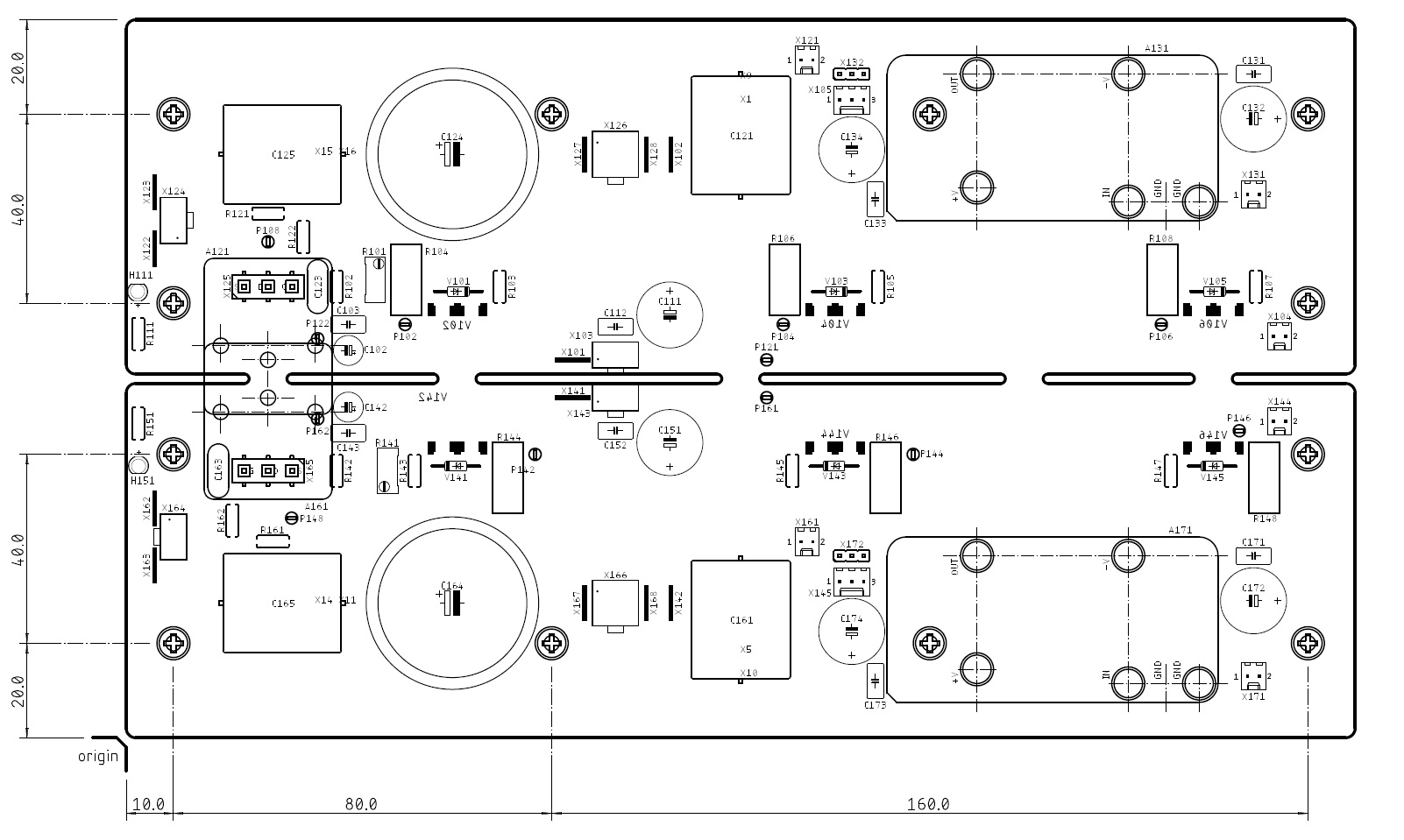

Final Manufacturing Files for LuFo
As promised, here are the complete manufacturing files for the LuFo amp with all known errors corrected. The amp has been verified by both Vunce and myself and has also been used as the basis for the SuSyLu amp (you will need 4 boards for a stereo SuSyLu). I would like to express my sincere thanks to JPS64 for providing a superb state of the art layout that is a work of art. I would also like to thank Vunce for building the first verification build of the LuFo.
The LuFo has provision for an on-board Yarra/M2X daughterboard as a front end. Choices include the Melbourne or Aksa Lender if you want to hit the 50Vpp required to produce 39w into 8ohms. You can also use an externally mounted preamp of your choice. A Pass ACP+ or Wayne's Burning Amp 2018 peamp might also work well with some mods to achieve higher voltage swing. Adventurous people might try to use the front end from the DIYA Lottery VFET amp. If you have a Yarra with Melbourne or an Aksa Lender all boxed up and ready to go then that works well too. In order to use the on-board Aksa Lender, you will need to build the new Aksa Lender double decker board designed specifically for the LuFo with its own built in DC-DC booster circuit. This will be posted separately. Alternatively, if you are not opposed to opamp based front ends, the OPA454 version will also be made available and works really well - that is the current one I am using.
The PCB follows the DIYA store UMS heatsink format - a 4U to 5U x 300mm UMS heatsink chassis should work fine. Total thermal output will be about 85W per channel. For SuSyLu, double that.
The amp is a relatively simple build with very few parts. You will need a handful of N channel TO-247 MOSFETs, and a pair of LU1014D or LD1014D JFET mounted on the IMS adapter from the GB by WG45.
For power supplies, a CRCRC using 15,000uF 50v caps (first one rated for 8A ripple current, high ESR), and 0.22R 5W resistors. Or a cap multiplier based PSU to provide the lowest ripple.
The attached files include:
- Schematic diagram
- BOM in Excel format
- PDF Stuffing diagrams (top and bottom)
- PDF PCB dimension diagram
- Gerber files
The files are free for DIY use, and are not for commercial use. For those who do not want to order their own boards, I am starting a LuFO PCB GB interest thread here.
I hope you give this amp a shot - it is very simple and sounds superb. 39w is a nice amount of power too.

Hi xrk,
I like it.
Regarding inductor, could this one be used? https://www.mouser.at/datasheet/2/177/153_159-736947.pdf (Hammond 60 mH 700 mohms)
I like it.

Hi xrk,
I like it.
The 159zc could possibly work. It’s 2A current us a bit less then nominal 3A and 0.7ohm dcr is s hit high. Probably close enough though.
Having more inductance rating (mH) is not a problem. 60mH was just suggested as a minimum and even 50mH can work. The inductance is frequency dependent and is reported as an average or at a specific frequency. Often, it is reported at 10kHz, thus the value near 50Hz where you want it to be a larger value can be in the 200mH range if it is 60mH near 10kHz. This is good. The low DCR is important - >> 1ohm doesn’t work as there will be too much dissipation in the coil from heating.
