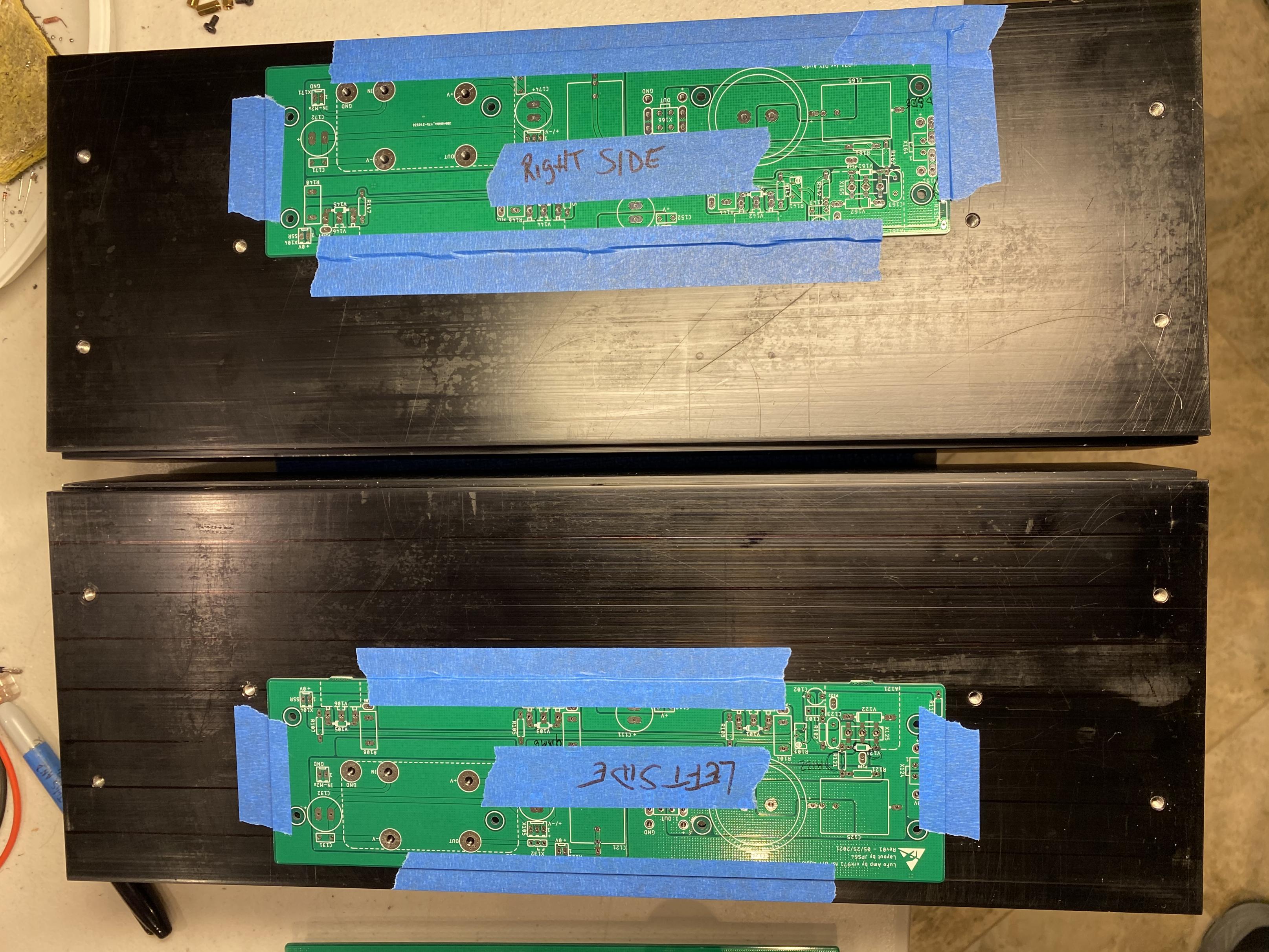

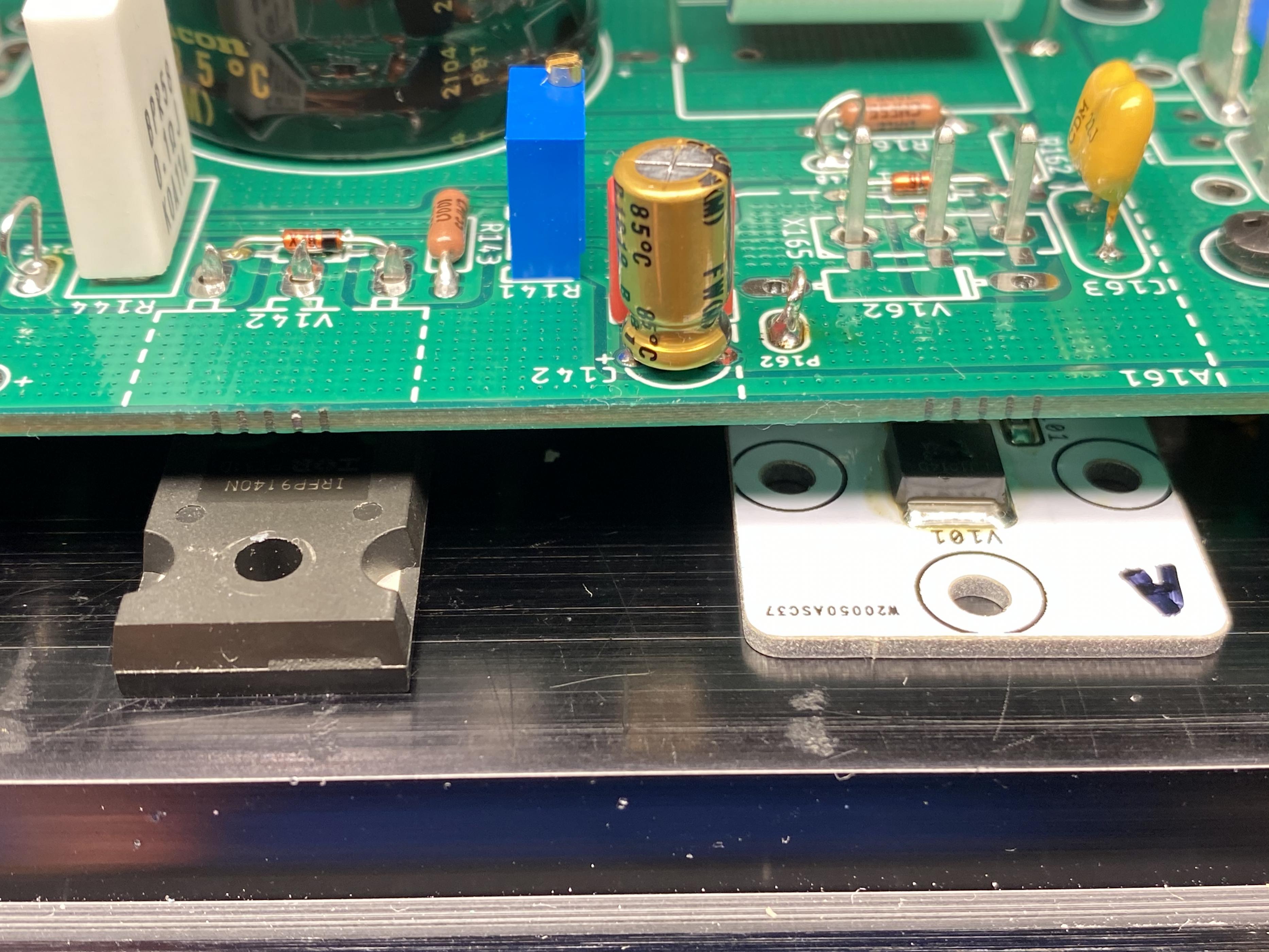

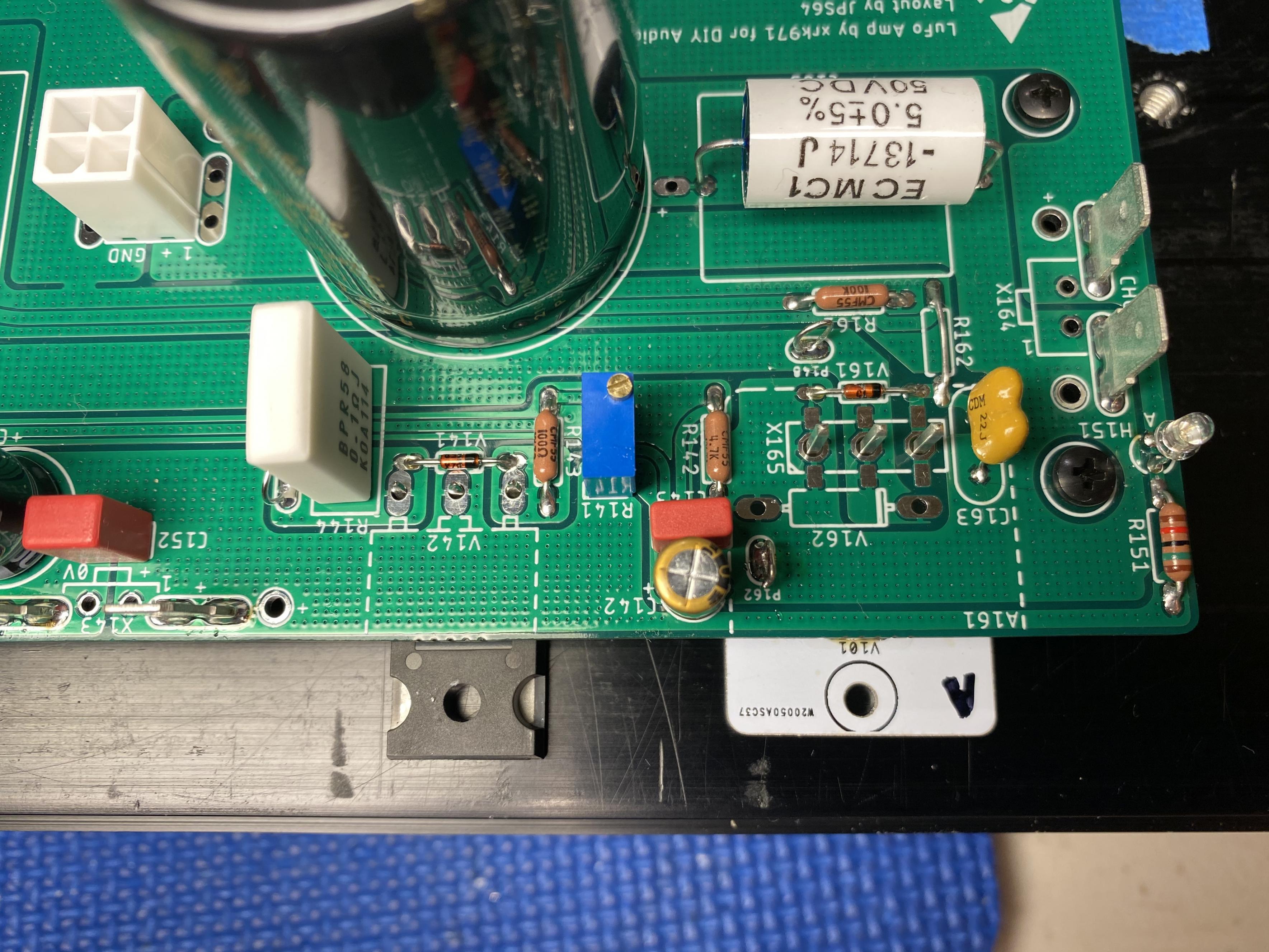

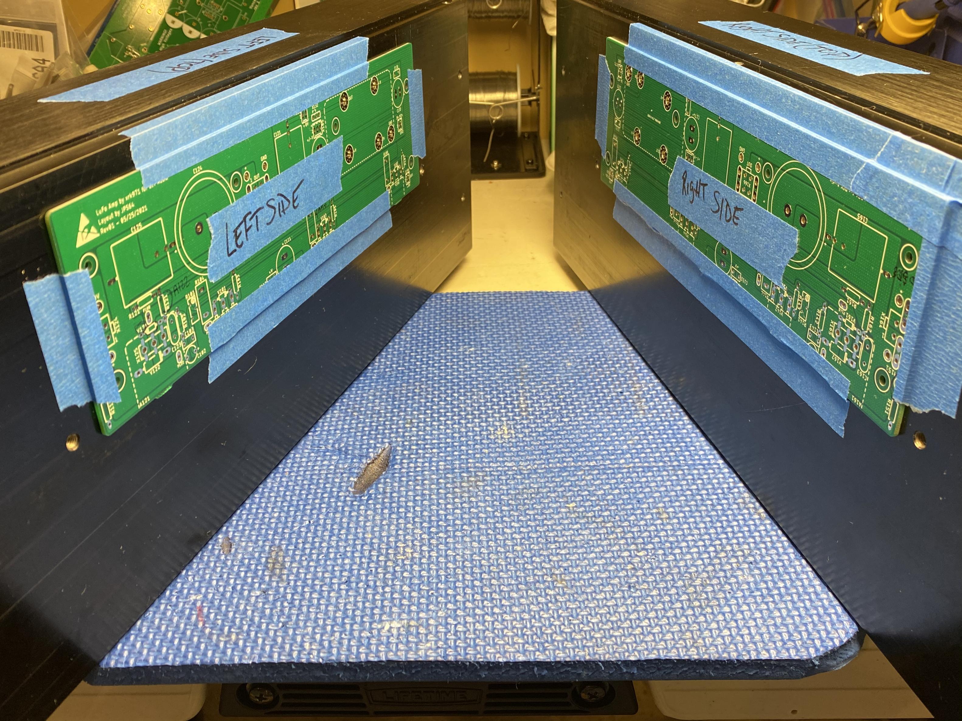

A bit of progress this evening, I dismantled the Stratos chassis and cleaned the heatsinks. The LuFo pcb’s are positioned such that the MosFets and JFET are just south of the HS center line.
The Mosfet in the picture is just for show, it’s not the correct part 😉

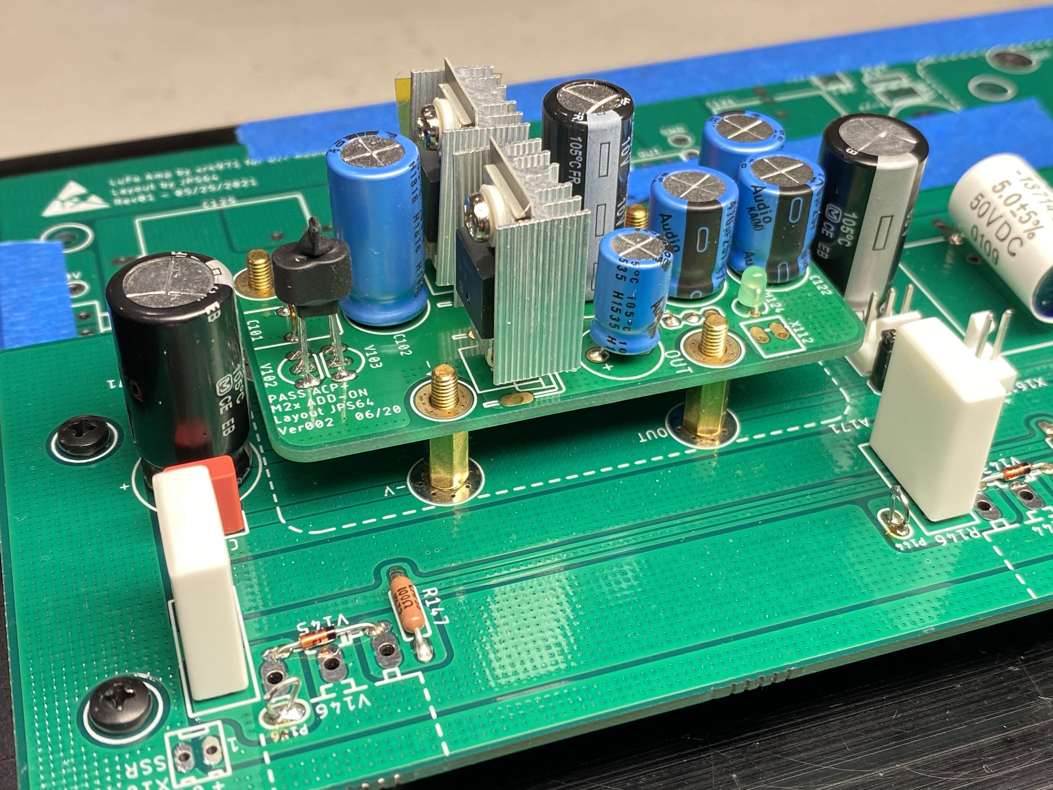

Nice work, Vunce! That looks really cool with the daughter board installed. The BOM for my OPA454 HV opamp board is here. PCBs will take a few more days.
It will be interesting to see if we can configure and ACP+ for 50Vpp output. Mark Johnson suggested using the typical Edcor transformer used for voltage gain in the M2. I think the Wayne’s Burning Amp 2018 preamp can run at +/-30v rails just fine. The resistors settings could be reduced to decrease the bias current.

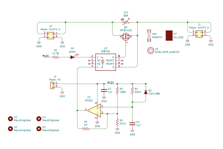

I have used a 48v variant of this same type of supply. They have an annoying fan which can be swapped with a Noctua, problem solved. They are actually very quiet based on FFT’s that so have taken. They might suffer from startup hiccup mode if you have too much rail capacitance. I think up to 10,000uF should be ok. I used to drive my TPA3255 which had dual 4700uF and it worked fine. But when I tried driving 2x 22,000uF it did not work. But, there is a simple slow start circuit that I have that can fix that. I used it on my VFET amp.
