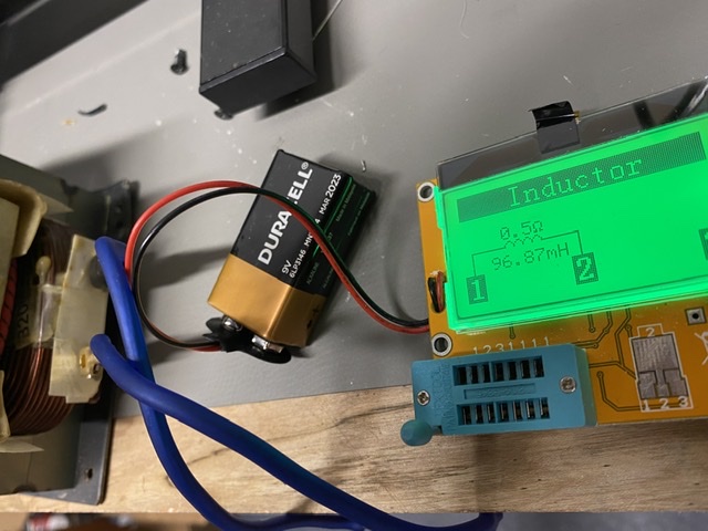

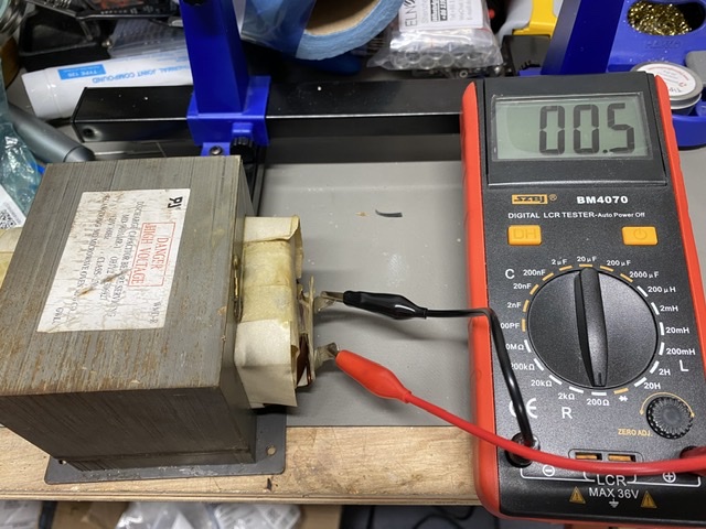

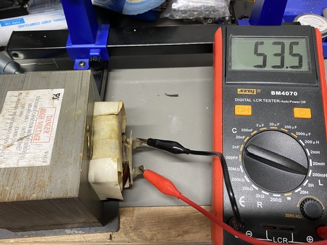

dBel beat me to the punch! I also just took a chance on one of the 903 series. This one being the AMR. With my LCR meter I’m getting 0.5 DCR and 53.5mH. Also took a reading with the old parts tester. DCR also 0.5 but maybe not the best at measuring inductance.

I would not be surprised at 100mH as the core is almost twice as thick. Thanks for confirming that the 903AMR is also viable.

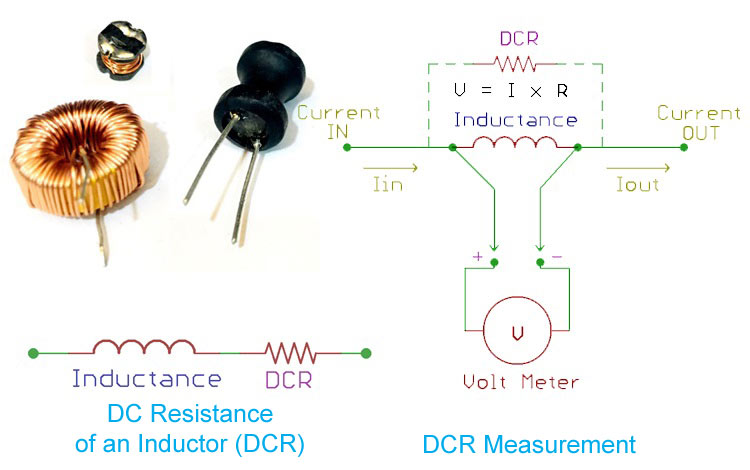

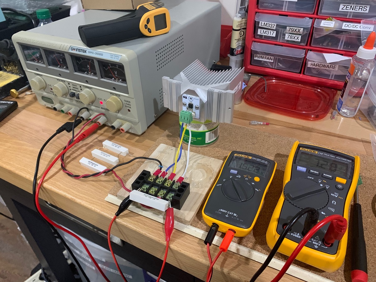

Inductor DCR Measurement
How do you check the resistance of an inductor? You can't just use your multimeter on ohms setting.
Suppose you need to measure a device like an inductor with DC resistance in the milliohm range. We had a production quality issue and needed to evaluate some inductors. The target resistance of the part was between 63 and 70 milliohms. Try to measure it with your Fluke 87V and you'll read something in the 0.5 ohm range. So how do you accurately measure it without an expensive micro-ohm measuring instrument? This is how we did it:
Make a "test fixture" from copper tape and a half business card. Add Kelvin sense leads. Solder the inductor on the fixture. Connect the Fluke 87V to the sense leads in voltage measurement mode and connect the power supply to the (copper tape) power leads with current limit set at 1 amp. The reading in millivolts drop on the sense leads is equal to milliohms of DC resistance in the part. Done.

The actual way to measure an Inductor's DCR value is by using a Kelvin sensing path across the leads and applying current across the Inductor. As the DCR of Inductor is the DC resistance of the copper wire, it will produce a voltage across the Inductor's terminal based on the Ohms law, V = I x R.
On my working LuFo I measure 3A independently from the CRC resistor - and the voltage across the inductor is 1.5v. This gives me an in-use, at operating current DCR of 0.5ohm which matches what the LCR meter gave when I measured the inductor at the mA used by the LCR meter.
good, might be coincidence, just like when you measure speaker resistance with multimeter, you get some number anyway, which is off due to inductance, but sometimes you get lucky
A bench top regulated and current limited supply is also handy to use as a source for testing an inductor. Here is my Instek GPC-3020 that I used to test the JFETs.

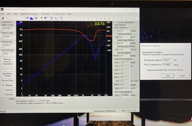

Ok, ok. So I don’t have the time to use my brain power to figure out how to build a test bed. But I did use my brain power to remember I have a DATS V2 laying around my shop! 😀
Here are the results. Almost dead on 0.6 DCR and 75mH for the 903AMR.
