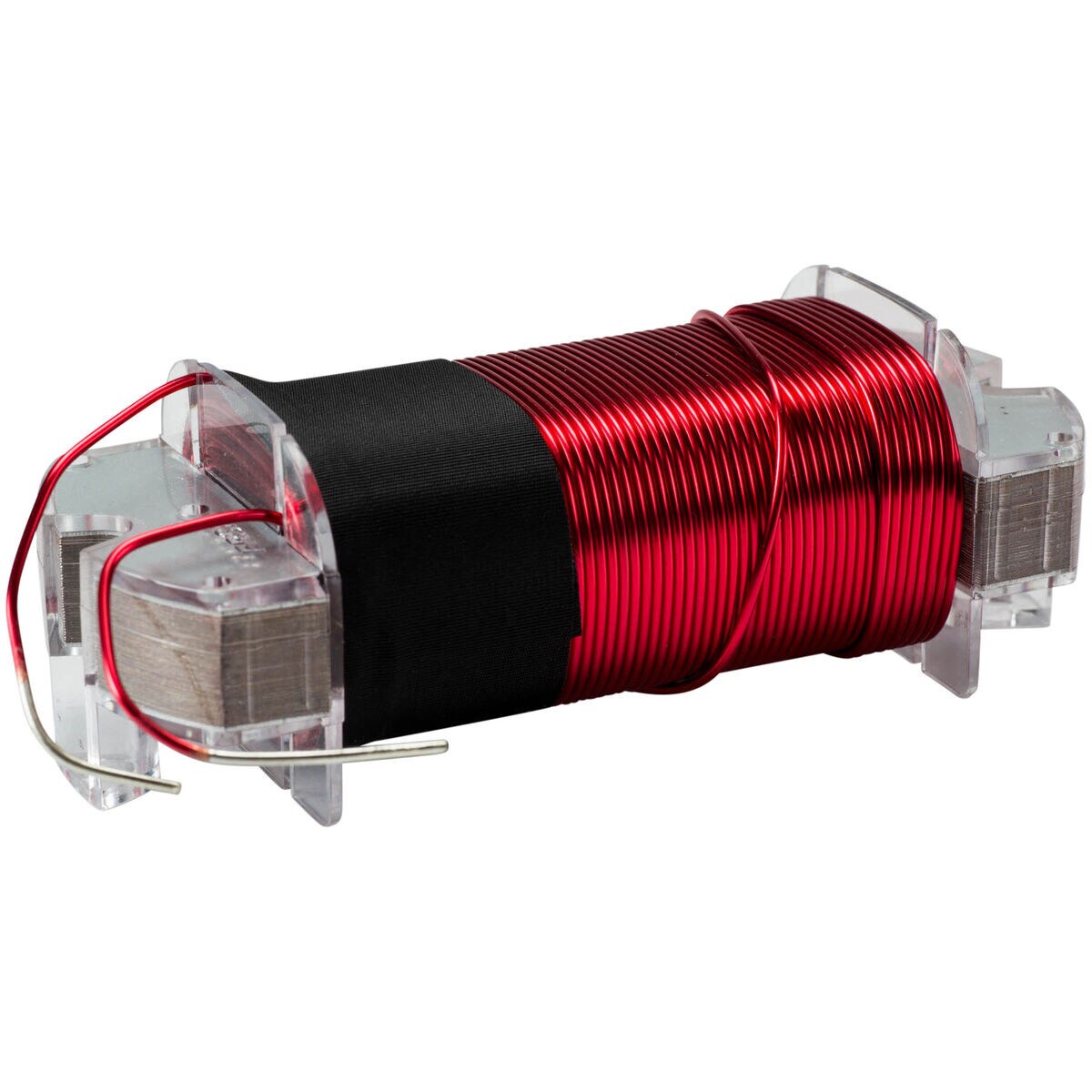

I ran some simulations with 24v supply and a 20mH 0.5ohm inductor. The results were very promising as a headphone amp driving a 32ohm load. I might have to give this a try - will need to order these iron core speaker inductors.
ERSE Super Q 20mH 16 AWG 500W Inductor Crossover Coil

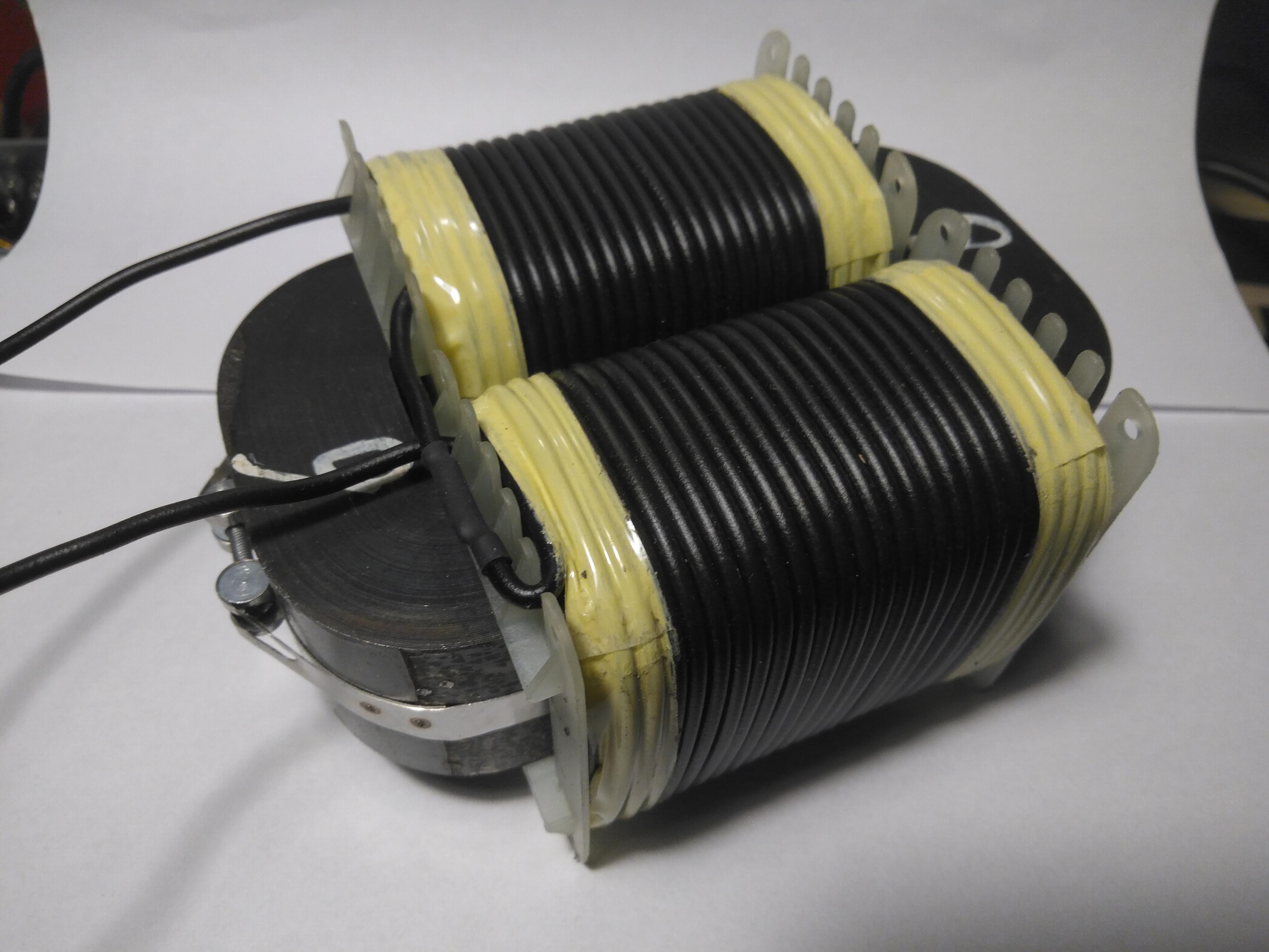

In the meantime I also had a prototype choke wound on a 300 watt c-core.
It has some 0.4 ohm DCR and 50 mH induction; this induction is measured with a (professional) induction meter at 100 Hz and 250 mV sinus.
It has quite an airgap, but behaviour must be checked in a working amp; I would not be surprised if a 600 watt core is required in the end.

That is a nice looking choke.

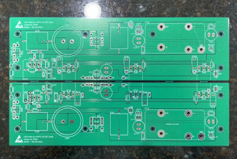

- LuFo Amp - 39w SE Class A from 28v Rail
