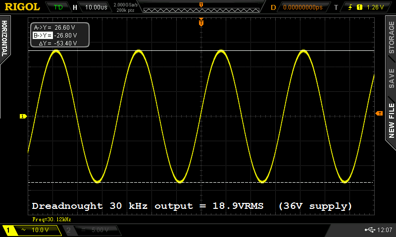

Over in ACP+ thread, Mark Johnson said that the Dreadnought FE board can do 53vpp. So there are options out there for preamps to drive the LuFo for sure. Here was the Dreadnought Oscope screen shot at 53.4Vpp:
943943d1618838868-scourge-bulwark-marauder-dreadnought-front-cards-diy-vfet-amp-dread_30khz_sine-png
Dreadnought appears similar to a Blameless architecture?

I would imagine that the harmonic profile of the Dreadnought (being similar to a Blameless topology) might have the 2nd and 3rd order distortions closer together in level, and perhaps more higher orders present. Whereas the Aksa Lender was designed to be second order dominant, with monotonically descending higher orders, and few higher orders presemt. In my HOWTO thread on distortion measurements using REW, I used the Aksa Lender as an example of what an FFT can look like driving 20Vpp into 7kohms:

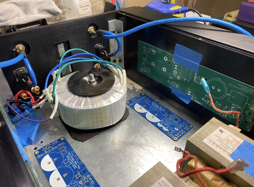

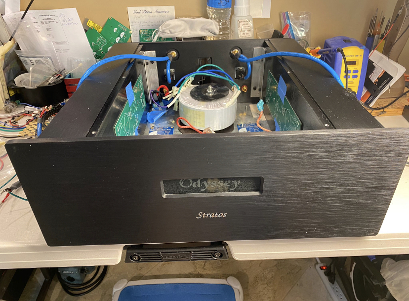

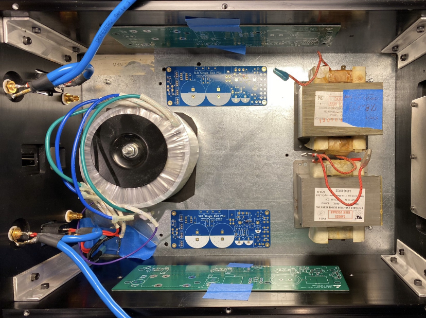

Vunce is getting a head start on building the LuFo amp verification build. He has chosen an old Odyssey Stratos amp as the donor chassis. It has the size to handle the LuFo as a dual monoblock in single chassis. It’s going to be a monster with a 500VA trafo and two 8lb MOTs. Also two single rail SLB power supply boards. Probably an SFP will be thrown in for soft start duties as well. I suspect upwards of 70lbs when completed. 😀 Watch your back, Vunce!

Hi WT,
I’ll send you the LuFo PCBs as soon as it gets here. Shouldn’t be more than another day or two. That PSU of yours should be fine - I assume it is a linear supply given the massiveness?

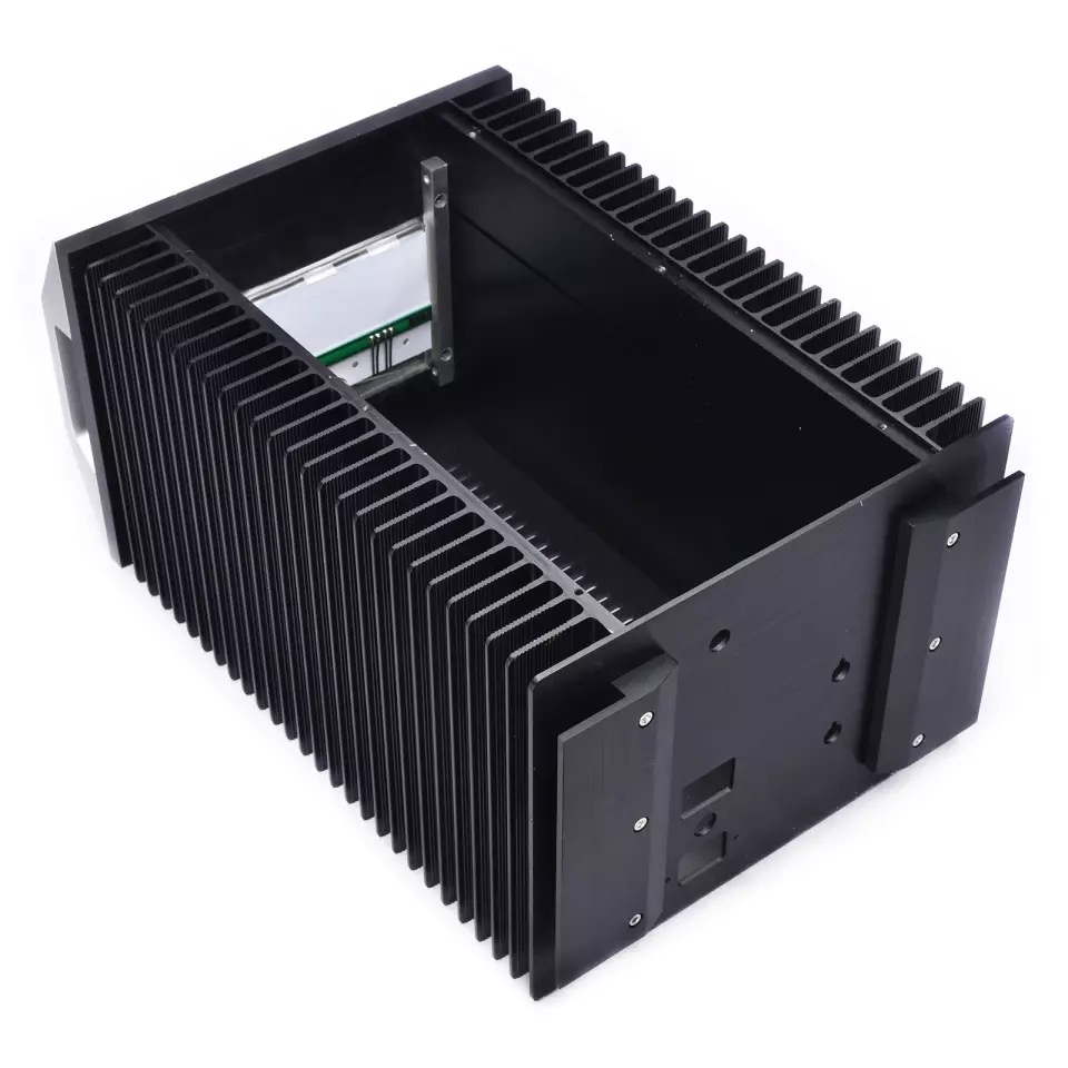

On my end, I will be building mine up as a pair of monoblocks. This is what I have in mind and about to place an order for this chassis: 160 mm W x 192mm H x 348mm D internal dimensions, 10kg (each).

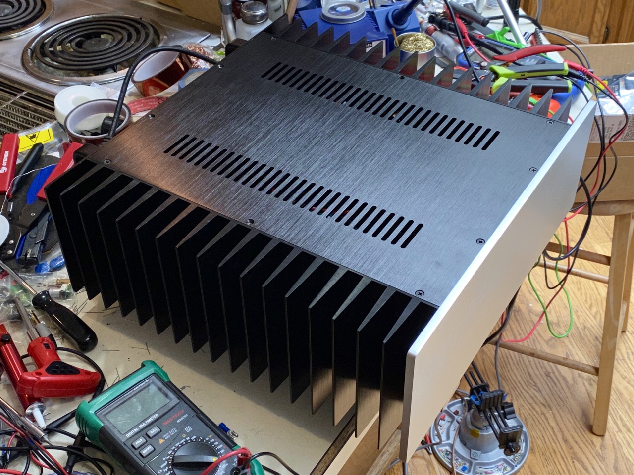

I have a duplicate of this chassis that may be suitable for some pretty decent power. It is about 3.5U tall, 400mm deep and has extra large fins. Internal space is at a premium for the serious iron needed for this project, but I think I can make it fit with a 600VA Antek transformer and a pair of MOT. Probably insufficient room for the Hammond 195T5, though.

Hi TA,
That’s a nice chassis. Fitting a toroidal, two MOTs and a pair of SLBs would indeed be tight. What are the internal dimensions? Maybe have a separate chassis for the trafo and two SLBs like you did on the VFET amp?

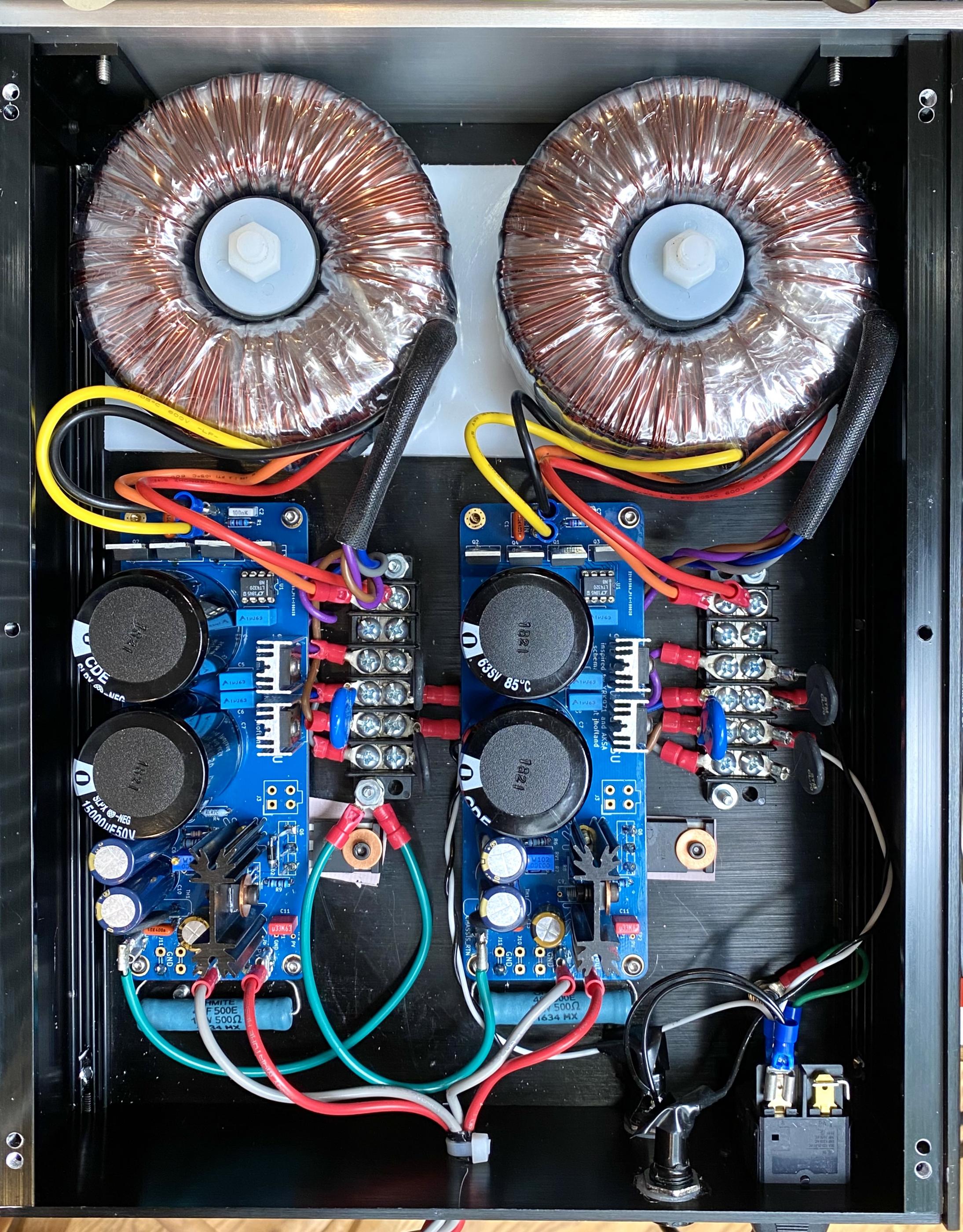

Really nice work you did on the standalone dual SLB PSU chassis for the VFET, btw. For the LuFo, you could use a single 500VA 25v toroidal can use each secondary for a separate SLB.
958503d1623249327-diy-sony-vfet-builders-thread-img_1106-jpg
