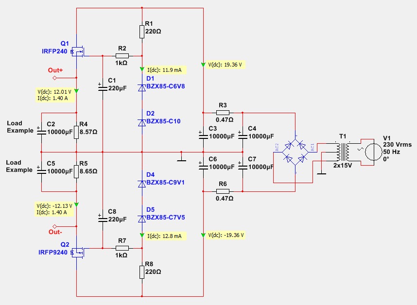

Here is the improved Power Supply.
It gives +/-12 Volt.
I have CRC filter after the rectifying diodes.
And zeners to set the output level
The output is MOSFETs IRFP240/9240.
Transformer should be 2x15VAC, 150VA or 200VA Toroid.

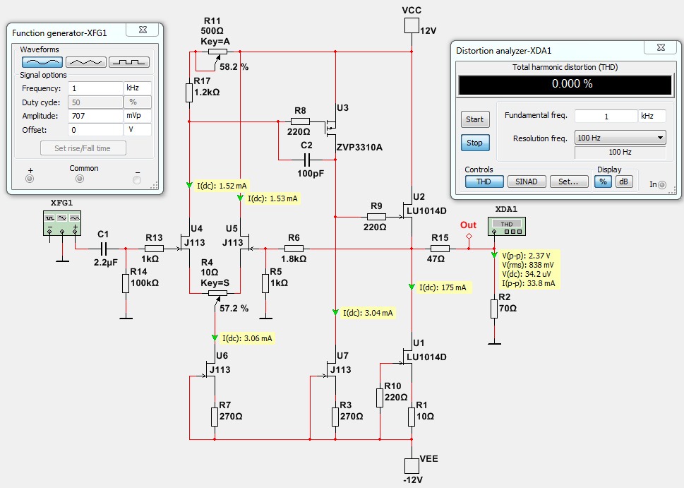

How much need to be changed to drive headphones 70 ohm?
I would first lower the current bias in output. That is done by changing R1 and R15 to a higher value.
Let's say we target for 100mA instead of 1.40A.
I would then change the gain of the circuit. Lower R6 to 2.2k or so.
That's it.
Maybe add a resistor out from the output. 47 Ohm or 100 Ohm I guess.
Another thing is we might need some slowstart of the amplifier.
It would take some minutes before the output is stable.
This Class A will certainly have a warm up process.
Can be a relay.

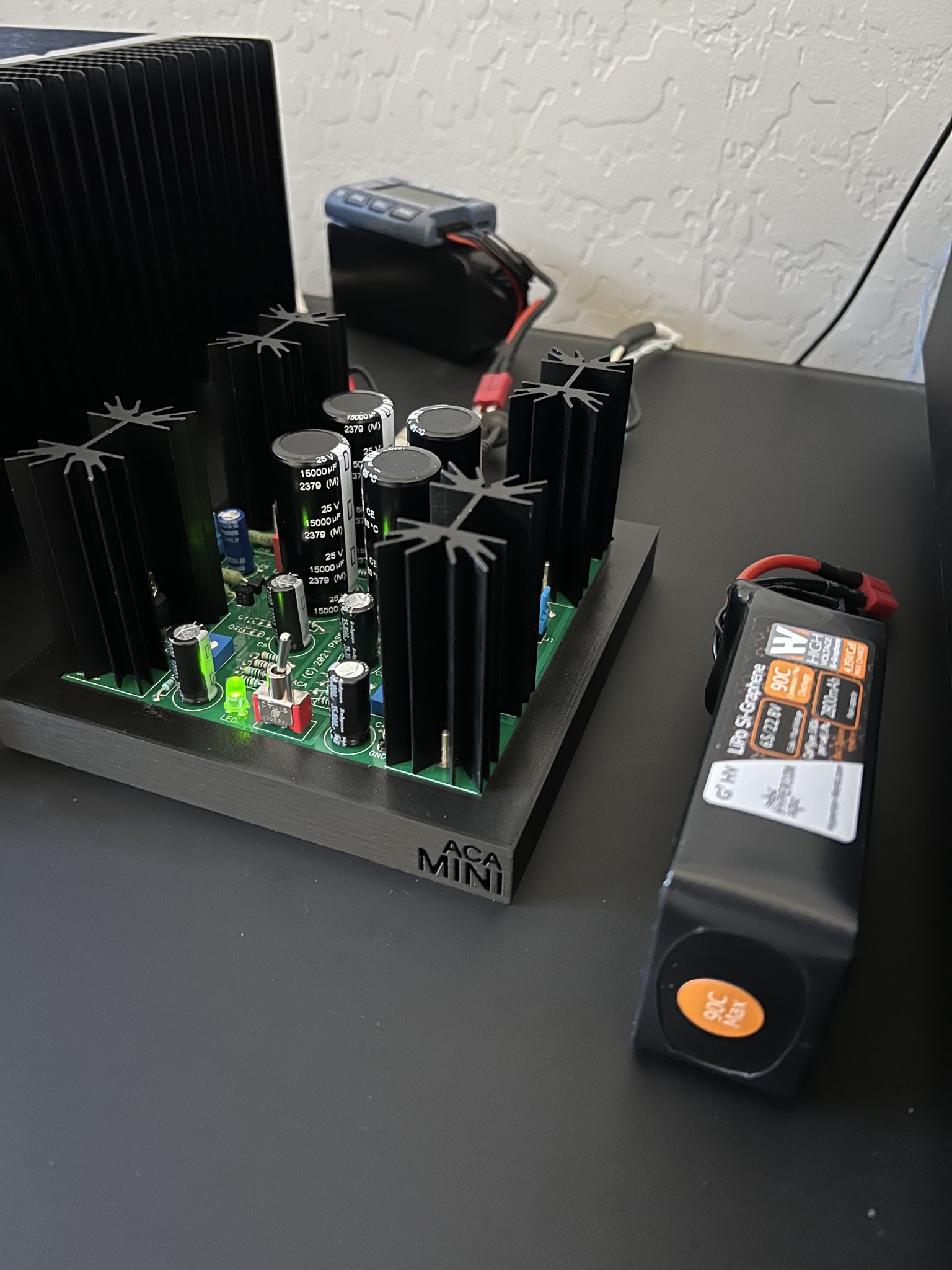

Yeah.... those big guns are mounted inside the metal enclosures that ring link church bells. Plus, there's a fair bit of hook-up wiring, extra solder joints / terminal block connectors...
But that little ACA Mini... no wonder it sounds lovely. No hook-up wiring (apart from a short LiPO battery wiring run), connectors soldered directly to the PCB... and the best thing... you used heavy plastics to mount the PCB. That makes a huge difference.

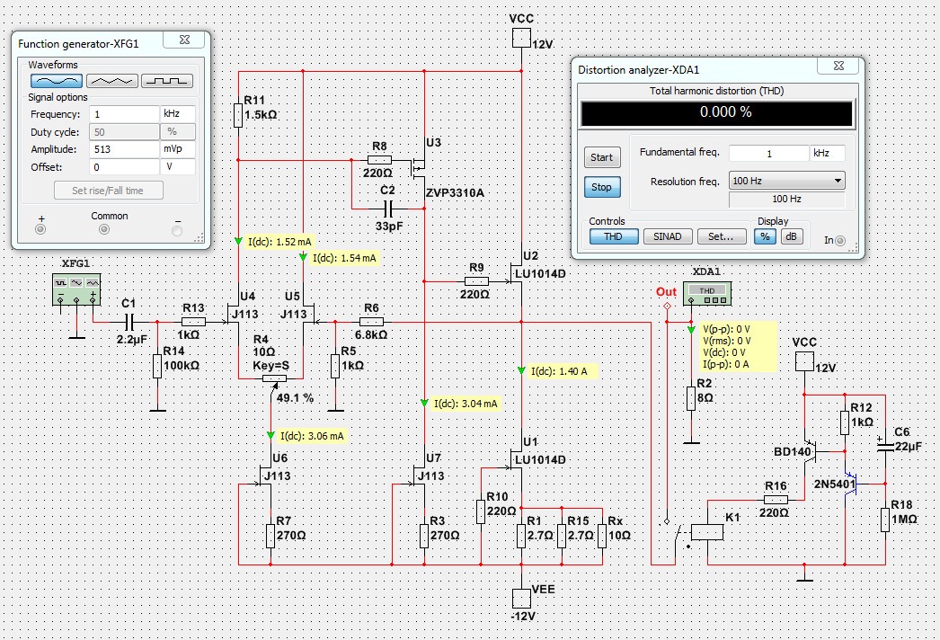

Here is Nelson Pass liked variation with Relay Delayed Start.
When I test it in SPICE the delay is now 22 sec before the speaker is connected.
It is to protect loudspeakers.
The delay can be adjusted by changing a capacitor C6.
Otherwise I have not changed this All FET variation.
It is a good little amplifier that should be okay to drive 8 Ohm or 6 Ohm speakers.
Those JFET has that good sound that Nelson Pass has demonstrated in his work.

"The problem with the Lu1014 is that I have not had good success making it behave itself outside of a cascoded situation, and stopped trying after a while.
But seeing as I have about 7000 of them, maybe I should take another look."
Real life problems (or shall we say challenges) that does not exist in Spice.
But that's what makes it interesting, even after 5 years.
