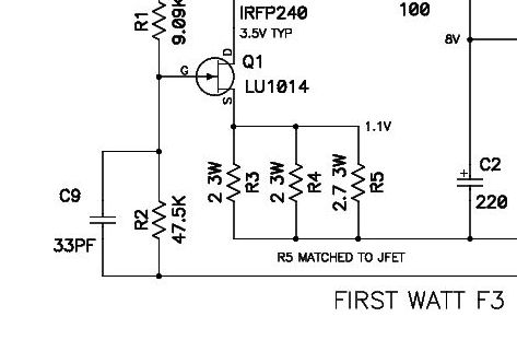

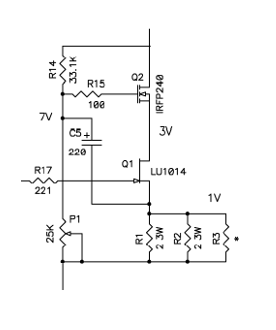

In my schematic the LU1014D is biased 1.39A.
That is when I use a 1.2 Ohm resistor as Source resistor.
As you say there can be a spred.
For other LU1014D devices there can be another resistor that is needed to get the desired 1.4A.
The target should be 1.4 Ampere
That seems true.
We can go a bit while changing the source resistor.
But if no resistor fits, we have a problem.
Another option is to select the resistor that comes closest. And go for it.
It is no big deal if we get 1.2A or even 1.5 Ampere.
But if this is impossible we must take another road.
Maybe some clever mind can find a solution.
An option.
Mount a resistor and put this across and adjust for 1.4 A.

No, modulated cascode of LU1014D is for another type of use.
Besides, 6 Watt is enough. Ask Nelson Pass.
For example he has designed ACA Mini - with very little Watt.
Another thing is that +/-12 Supply can not be more than 6 Watt ....
Hmm, what exactly do you mean by that? What would be the technical/conceptual reason why the modulated cascode would not work?
That may be true for some applications, but not for others. For example, if I want to listen loud with proper dynamics (no compression, no clipping) with a "normal" loudspeaker (say 8 Ohm, 92 dB/V/m), 6 Watt will not cut it.
