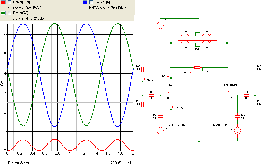

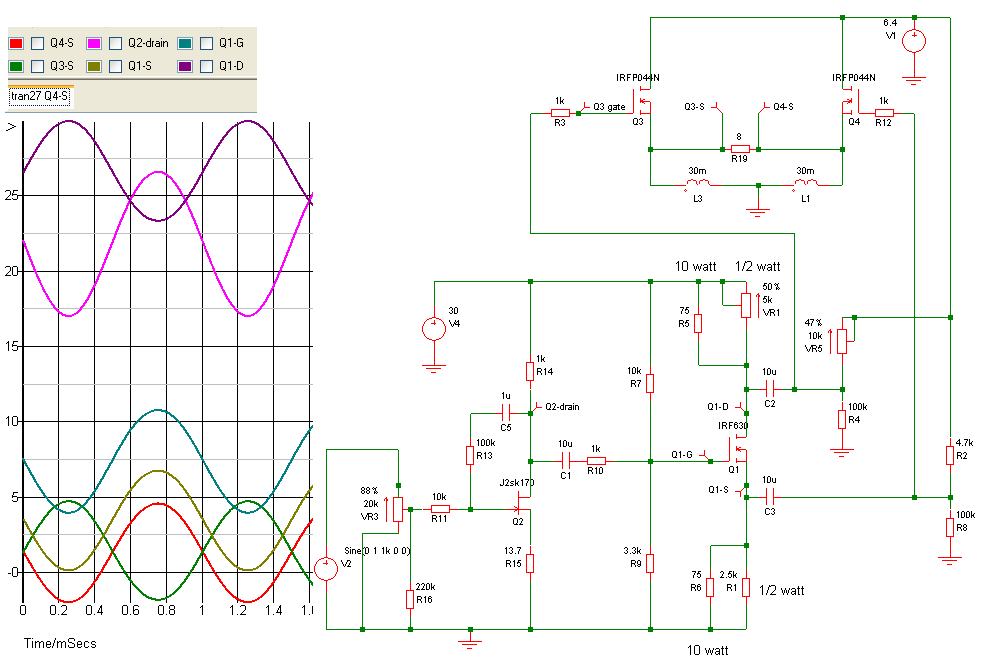

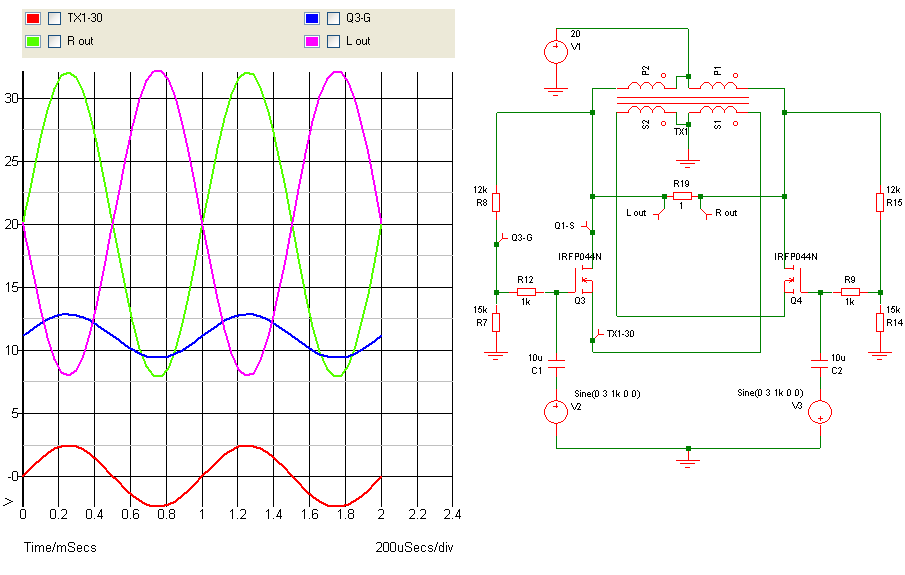

I've been simulating and bread boarding this amplifier. I've learned a lot about the power curve probe in SIMetrix:
Power mosfets want a lot of current. I implemented the design mods to flesh out a reasonable looking power sine-wave and discovered why Class A amplifiers are so inefficient.
But, when adding the extra current, I don't necessarily get more power to the driver. Instead, it gets gobbled up by the transistor!
The end results are astounding. I've never fabricated such a nice sounding amplifier. It has that plush, cozy sound in addition to crisp, delicate highs.
Man... Thanks so very much, Nelson, for turning me on to sims. It has helped me immeasurably!

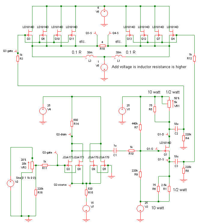

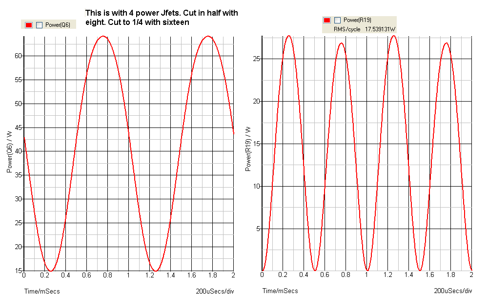

Here's my latest creation. It's all jfet and has beautiful power curves on all transistors. I show eight jfets in the power output, but you could have sixteen if you want to really keep the wattage on each device standard. Currently, as depicted, there is about twenty watts on each device.
