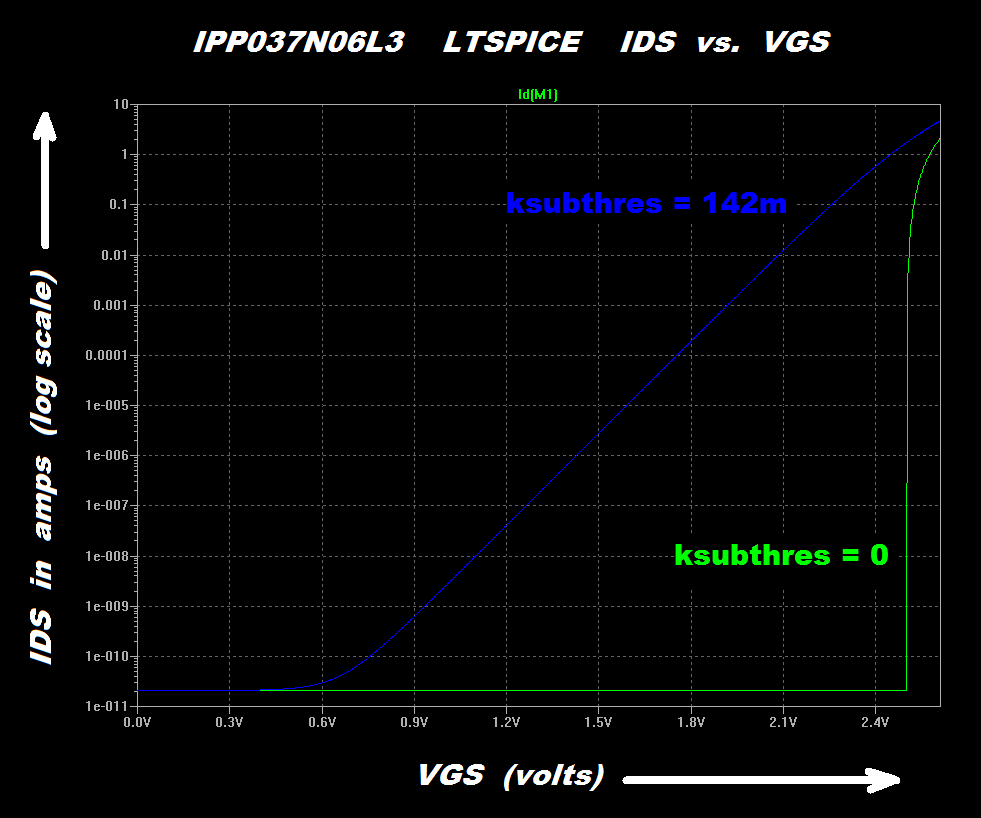

I am a former developer of integrated circuits. In particular manufactured in CMOS technology. I had to develop micro-power generators and stabilizers. I know that most of the models of MOS transistors lie heavily at small (relative to nominal) currents. For digital (switch) schemes is not terrible. Characteristics of MOS transistors Immersed two voltage region on the gate . This is a common area (approximately square law) and subthreshold (exponential law).
The exponential law Id = i0 * exp (Vgs / (n * vt), n> 1 ~ (1.5-5)
==> Gm=Id/(n * vt), vt=26mV.
LTspice in VDMOS model it is possible to use the sub-threshold region.

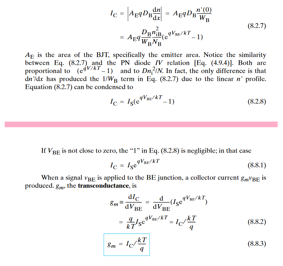

All bipolar transistors have the same transconductance: gm = Ic / (kT/q) . Here's the relevant part of Chenming Hu's lecture notes @ UC Berkeley.
Of course, an extremely skeptical person might want to disregard Chenming Hu (and Paul Brokaw, and Barrie Gilbert, and Paul Gray, and Richard Jaeger, ... ) and go measure this for himself. I offer my blessings and good wishes for your project, but I won't donate any money or any man-hours to help you execute it.

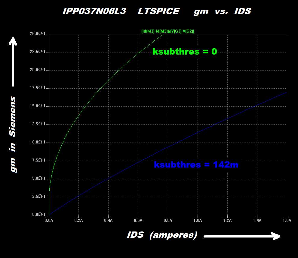

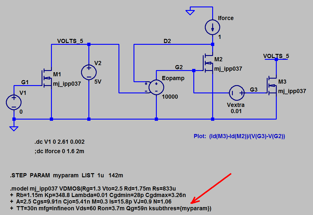

For a VDMOS model in LTSpice, add the ksubthres parameter. IIRC ksubthres is roughly the Vgs per decade Id in the subthreshold region. So if you have a MOSFET with a common subthreshold curve of 250mVgs per decade, start with ksubthres=250mV and adjust it to match the curve.

As anyone might expect, when you introduce a new degree of freedom (a new model parameter), the fitted curve doesn't get any worse. Instead it gets better.
I've plotted the LTSPICE results before (green) and after (blue) adding the new model parameter ksubthres=142m into the VDMOS model of the IPP037N06L3. Compare these plots to Figures 1 and 2 of post #1 in this thread. The curve-fit is improved. As expected. Then the obvious next step is to purchase some more units of the same transistor, hopefully from different manufacturing lots with different date codes, and find the "best" device, the "worst" device, and the "typical" device. Then fit model parameters for all three, allowing simulation with best transistors, worst transistors, and typical transistors.
Armed with a curve tracer and a few samples of a transistor, diyAudio members can perform these tasks themselves. Measure, simulate, tweak model parameters, simulate again, rinse and repeat. Straightforward.
