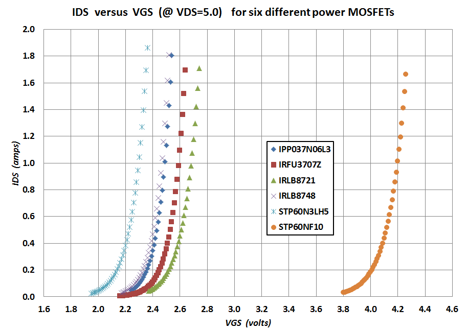

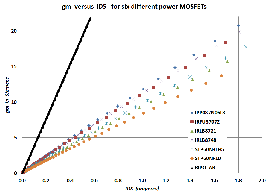

I purchased several other modern power MOSFETs whose datasheets indicated, they might have very high gm. And I measured them all using the Locky_Z curve tracer. The drain current measurements are shown in Figure 2, and the transconductance plots (gm = dIds/dVgs) are shown in Figure 3.
Again we see that bipolar (black curve in Figure 3) kicks butt compared to MOSFETs; its gm is far higher.
So, if you're interested in building a voltage regulator with a very low open loop output impedance (= 1/gm of the series pass transistor), choose a bipolar transistor rather than a MOSFET. Maybe someday, someone will build and sell MOSFETs whose measured gm exceeds bipolars. Maybe. Someday. But as far as I can tell, not today.

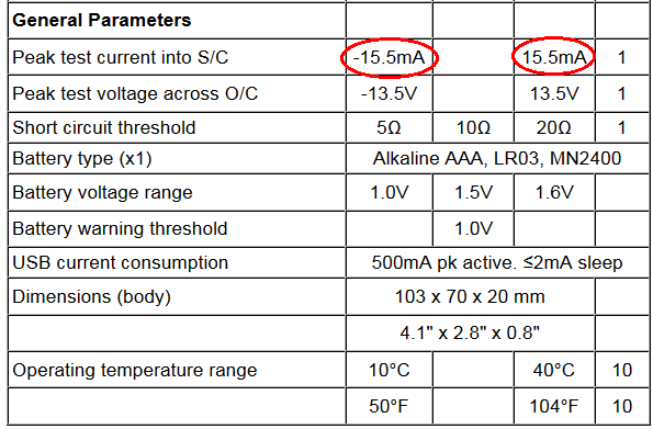

Buy an Intelligent Curve Tracer and find out! $229 on eBay. The curves shown in post #1 of this thread, are the very first ones I measured after power-on. Already I've gotten excellent value for money. BTW I also bought the competitor curve tracer from Syscomp, for more money, but this one is decidedly superior IMHO. I also own an old Tek 576 war horse, but it doesn't digitize the measured data and hand you a nice .CSV file.
I think my Peak Atlas DCA Pro can do this but it requires a Windows computer. I use a Mac. On my To Do list is to get a copy of Windows and run it with VMFusion. But it will likely take me awhile. Annoyingly I just sent an order to Mouser - I could have tacked a sample of each into that order.
That's one of the few I didn't purchase. My reason was, that Atlas DCA Pro is battery powered and so it can only source or sink 15 milliamps into the Device Under Test. Syscomp can go up to 1 ampere and Locky_Z can go up to 3 amperes. Here is a table from the DCA Pro web page.

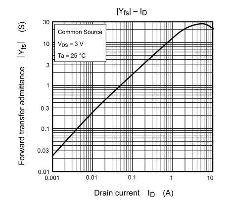

From studying many power MOSFET datasheets the highest gm I've found is only about 10% of a bipolar's at the same current - say at best 4S @ 1A. Toshiba makes the FETs with the highest gm, some of their small signal parts come as close as 50% of a bipolar's gm. Take the SSM3K123TU whose plot I've included here - at lowish currents (under 100mA) its doing about half of what a bipolar does.
@SGK - that BUK FET looks pretty good (but not as good as the Toshiba here), from eyeballing the datasheet the gm is about 8S @ 1A but notice its measured at 15V, in a regulator you'll probably have lower drop and hence lower gm.

The curves in Figure 3 of post#1 show six MOSFETs whose gm is about 30% of the gm of a bipolar -- measured, not datasheet drawing. I recommend measuring this if at all possible; especially if you're using a high current transistor at 0.25 amps, I think you have many reasons to be skeptical of datasheet curves at low currents.

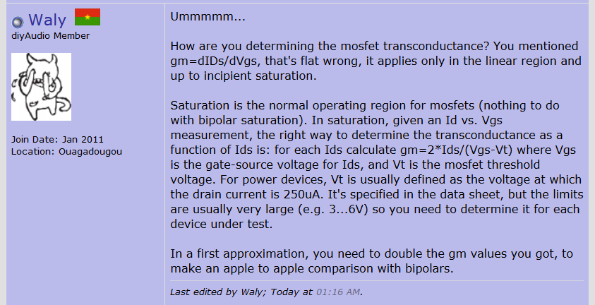

Ummmmm...
How are you determining the mosfet transconductance? You mentioned gm=dIDs/dVgs, that's flat wrong, it applies only in the linear region and up to incipient saturation.
Saturation is the normal operating region for mosfets (nothing to do with bipolar saturation). In saturation, given an Id vs. Vgs measurement, the right way to determine the transconductance as a function of Ids is: for each Ids calculate gm=2*Ids/(Vgs-Vt) where Vgs is the gate-source voltage for Ids, and Vt is the mosfet threshold voltage. For power devices, Vt is usually defined as the voltage at which the drain current is 250uA. It's specified in the data sheet, but the limits are usually very large (e.g. 3...6V) so you need to determine it for each device under test.
In a first approximation, you need to double the gm values you got, to make an apple to apple comparison with bipolars.

Thank you for that piece of wisdom. I have saved it for posterity in the image file below. Even after you get banned, or drop out, or just lose interest, it's preserved here forever more. And I will cherish it. Thank you.You mentioned gm=dIDs/dVgs, that's flat wrong.
Are these pulse or dc measurements?
Anybody who has done both, themselves, personally, can see just by observing the shape of the curves, that these measurements are performed with low duty cycle pulses.
Sure. I'm simply reporting some DATA, nothing more and nothing less. This is what you get from LTSPICE, this is what you get from measurement, this is what you get from the hybrid pi model. If someone wants to "spin" the data a certain way, let em. Just remember that data and spin are two different things.It's not out of the question that the models fit the high current performance but need for charge conservation reasons to smoothly go to zero at the origin just so SPICE does not break.
