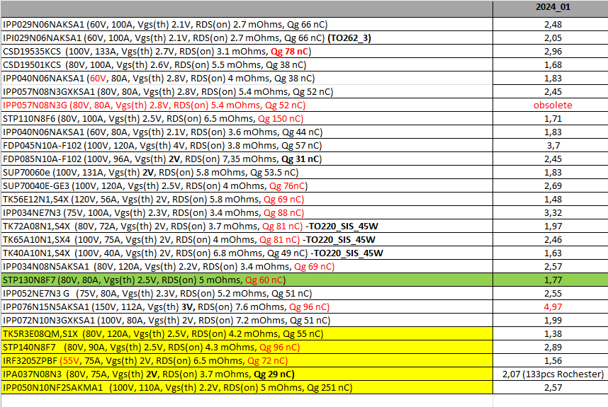

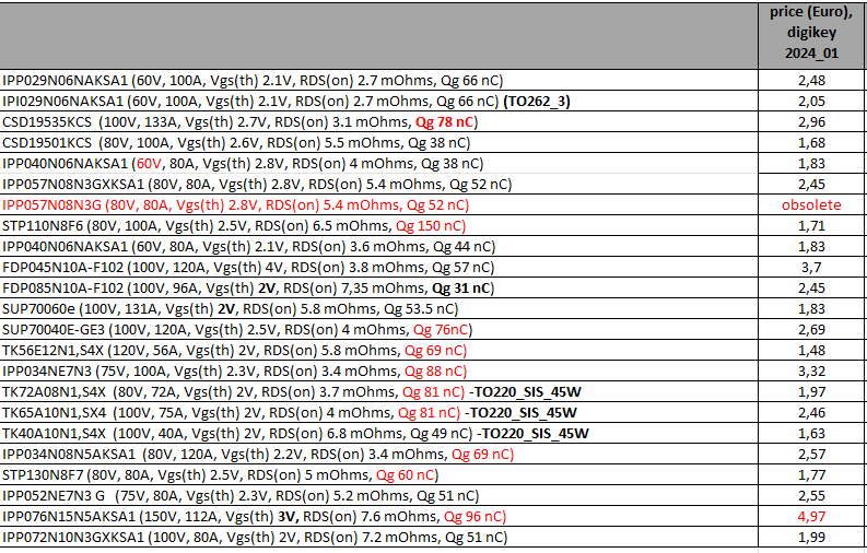

Hi
i collect all THT MOSFET and I look at the datasheets and write it down, so it should be easier to choose for First watt amps (60Vds) r for other reason another MOSFET.
if you find some errors please give me feedback
chris
