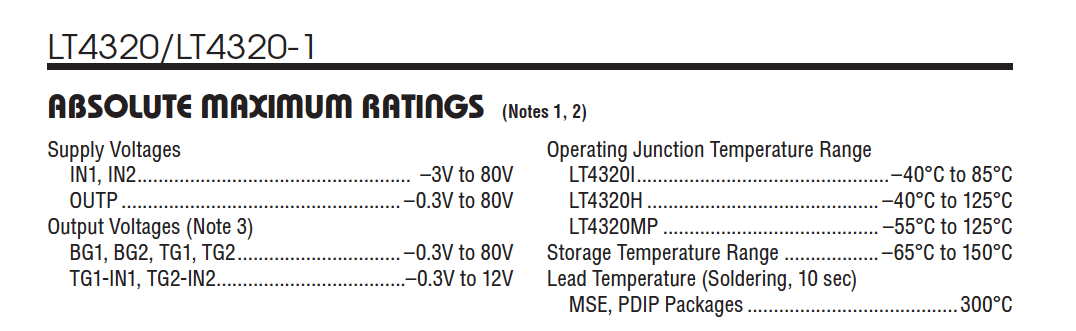

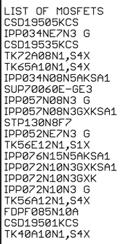

Which would be a better THT Mosfet for 50VAC or 70VDC,
CSD19531KCS
or
CSD19503KCS
I am thinking the first one is the better one, or any other suggestions?
I would like to use the first one, CSD19531KCS, as it is rated for 100v, but neither Mouser to Digikey have them in stock.
Ti has the CSD19503KCS in stock, but it is rated for 80v, would that still be fine for 50VAC on the LT4320 rectified to 70vDC?
80V ratings is greater with a good margin than what LT4320 is rated for its absolute maximum at 72V, so I guess the question should be the LT4320 is suited for use with 50VAC supply or not. Apparently, LT4320 will much more likely be dead sooner than do the MOSFETs 🙂, if u-no-wut ever happens.I would like to use the first one, CSD19531KCS, as it is rated for 100v, but neither Mouser to Digikey have them in stock.
I'd be careful about what that 50VAC really means. Mains supply can have 10% fluctuation, power transformers usually have a load regulation anywhere from 3%-10%, which means its out put voltage at light or no load is higher than would be at its rated load.
However, if that 50VAC is the maximum possible voltage the LT4320 ever can see, it should be ok.
Thank you for the correction! I have long been mistaking the 72V in the feature highlight for the maximum rating.

Hello, I’ve purchased TK34E10N1,S1X for a VSQC amp build. Planning on using 2 x transformers in dual mono setup with either 30vAC or 35vAC dual secondaries. Would these Mosfets be OK for the job?
hi, those mosfets are ok, albeit have a slightly higher Rdson. just monitor the temperature of mosfet in your intended application,. if they dont heat up too much, you are good to go. rest of the mosfet parameters are good for lt4320 rectifierHello, I’ve purchased TK34E10N1,S1X for a VSQC amp build. Planning on using 2 x transformers in dual mono setup with either 30vAC or 35vAC dual secondaries. Would these Mosfets be OK for the job?
