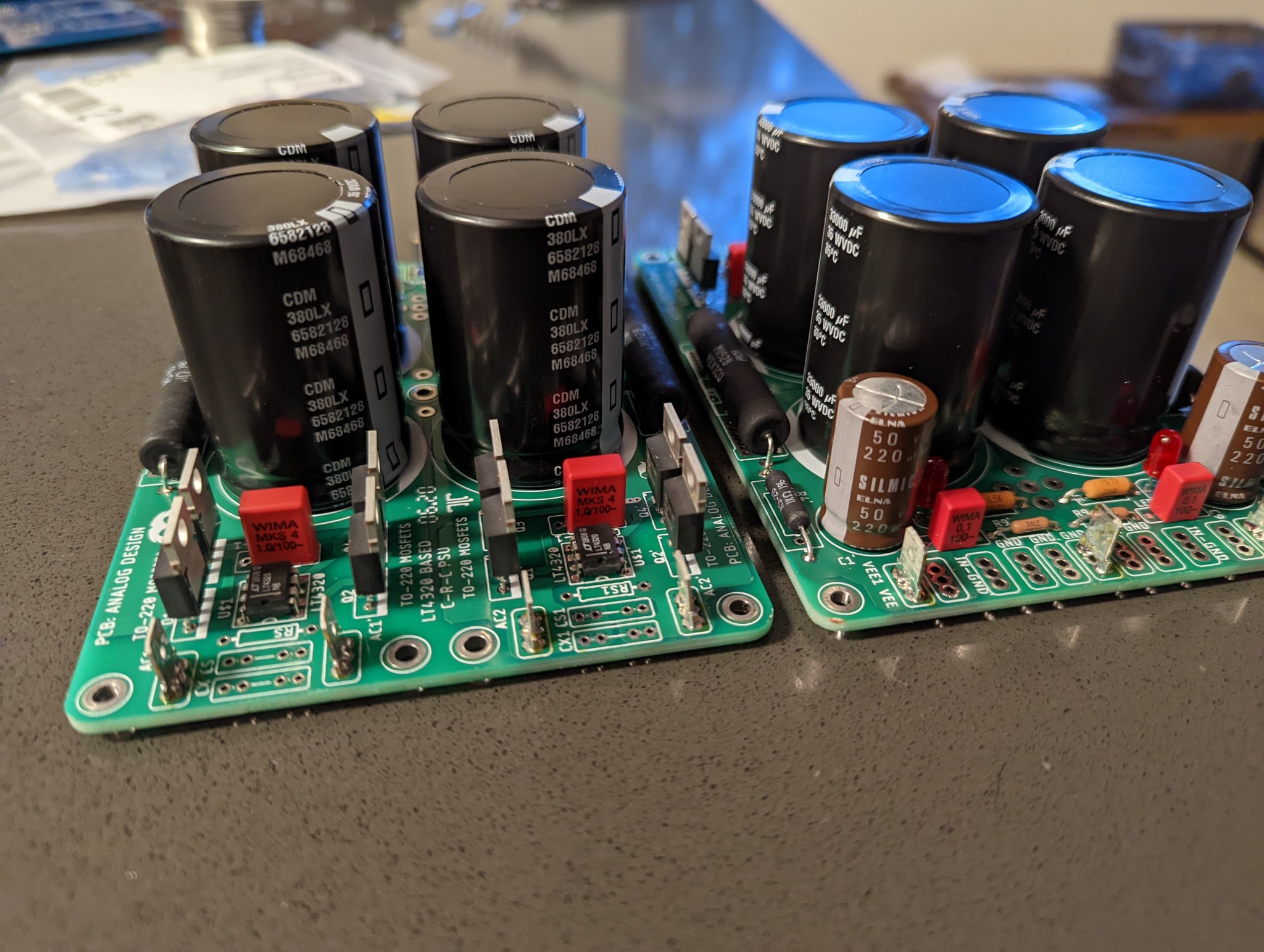

you can use upto 50-0 VAC per lt4320 bridge MAX.
My plan was to use 50 VAC, (rectified to ~70VDC), but that is the max VDC rating, 9v to 72v being it's "operating voltage".
I was wondering how safe it would be operating at the edge of the recommend voltage, but I noticed the data sheet shows OutP to be Absolute max rating of 80v.
Would that be to account for using at the limit of 50 VAC and still having a margin of safety?
Which would be a better THT Mosfet for 50VAC or 70VDC,

I am thinking the first one is the better one, or any other suggestions?

Does the VA of the transformer factor into the choice of MOSFET?
If so, I am using a 500va double secondary 50V.
yes first one is better as it is higher voltage device.Which would be a better THT Mosfet for 50VAC or 70VDC,
CSD19531KCS
or
CSD19503KCS
I think VA doesnt matter as the downstream Cap bank. tvicol had mentioned about diode current capacity of 10A or more depending on capacitor size.Does the VA of the transformer factor into the choice of MOSFET?
here is a link to his post.
https://www.diyaudio.com/community/threads/lt4320-based-active-rectifier.336572/post-6722377
Populated boards. 🙂

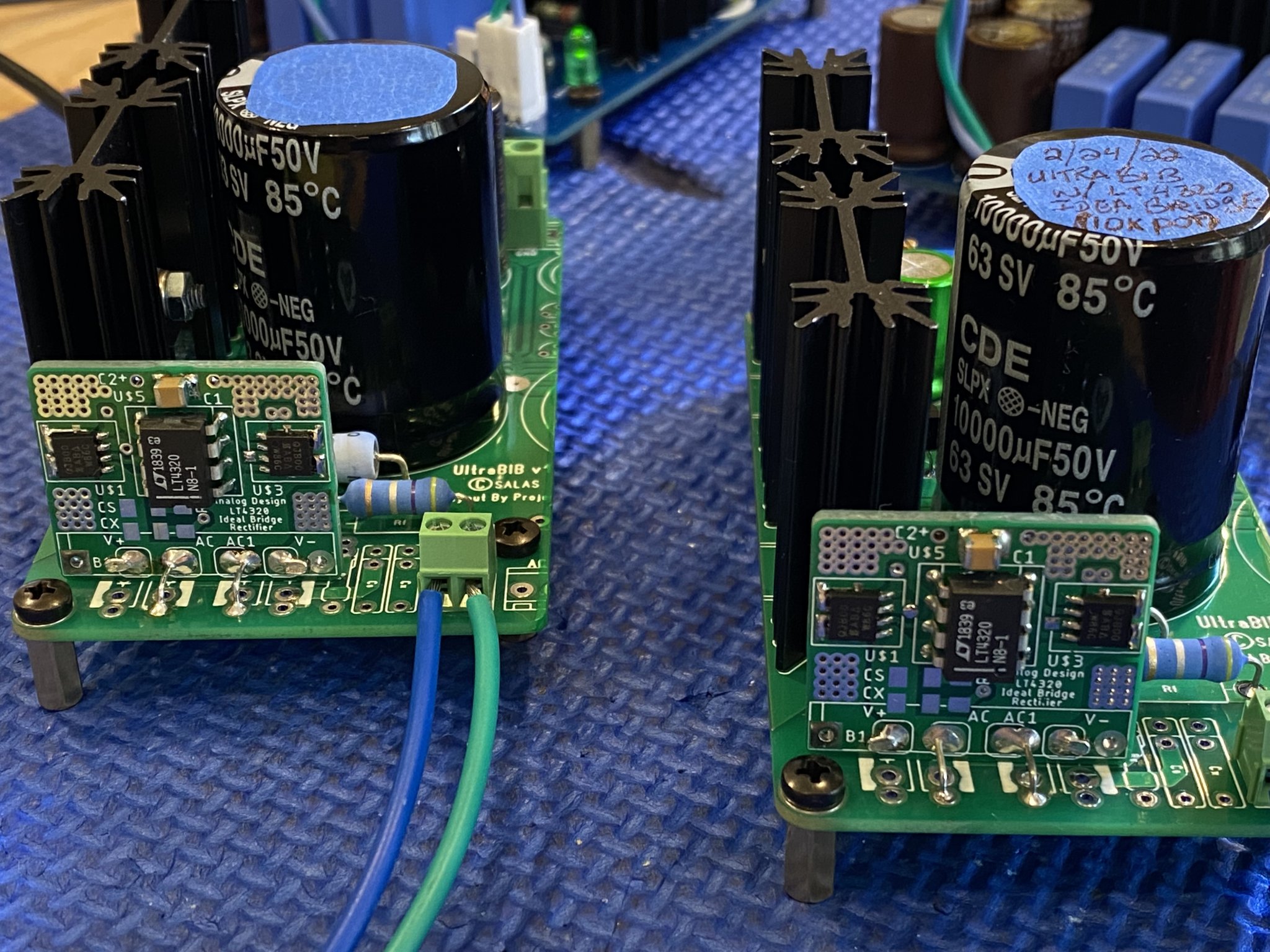

This may be a silly question, but what is "In-GND" and how does that compare to "GND?" Is it signal ground vs chassis ground?
If so, I'm wondering if it's advisable to use attach it, or just leave it disconnected?

My other query is how to add a 'soft start' such that the bridge ramps up to full voltage over a period of, say, 5 seconds (maybe determined by extenrnal resistor/capacitor) to minimise turn-on stress for downstream components?

5 seconds is very long. Why not use a CL-60 inline with AC like done for many of the pass labs PSU?I'm also very interested and have seen boards on PCB way too, designed/uploaded by someone from Ukraine.
Another option to use a dedicated soft start like Diyaudiostore soft start boards..
