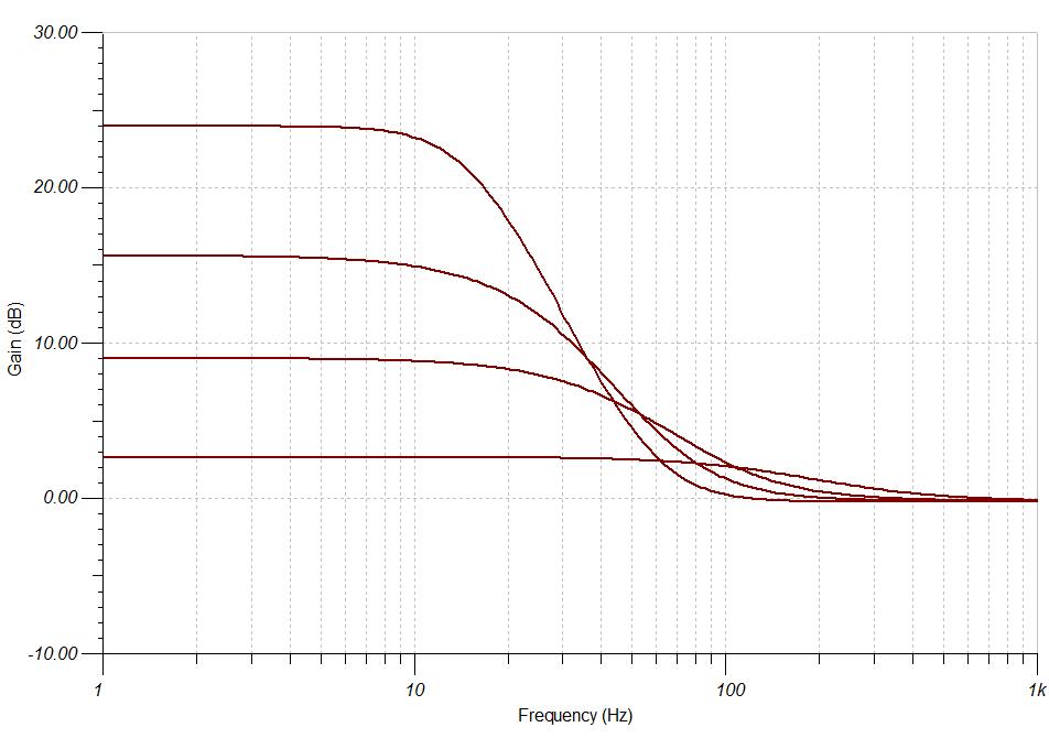

The attachment shows an example of the boost reduction that the circuit can achieve with increasing input level, so as to keep the max output level from exceeding a threshold. The "flattest" curve corresponds to the highest input level, while the curve with the highest low frequency gain corresponds to the lowest input level.
It's not perfect in that it also slightly alters the filter shape, but it's only by about 2dB or less at the upper knee in the response, and is IMO low enough to not worry about.

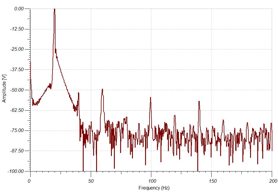

Attached is an example of the distortion spectrum under very strong boost limiting conditions for a 20Hz tone burst. Distortion components are -50 or better (fundamental is slightly off scale and is about +2dB). Note, this is SPICE modeling using TINA, not a "real world" circuit.
Edit: I should add that when I obtain the same spectrum on the stimulus (input signal) I get similar distortion numbers, so it looks like the circuit does not add much distortion.

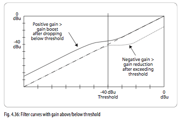

Sounds like what can be done with the dynamic EQ in the Behringer Ultradrive Pro DCX2496.
"The DYNAMIC EQ influences a specific frequency range of the signal, depending on the volume level. It can either boost or cut this frequency range, depending on the gain setting made by the user. If the gain control is set to lower the respective frequency range in level, and if a preset THRESHOLD is exceeded, the EQ modifies the sound by reducing the gain of the frequency range. The amount of gain reduction applied is defined by the RATIO value. When the signal drops below threshold again, the frequency range is “smoothed out” again, i.e. the DYNAMIC EQ stops processing the signal."
Unlike the Bag End device which is fixed for a single application, the DCX2496 can be adjusted for any desired boost/cut frequencies and thresholds.

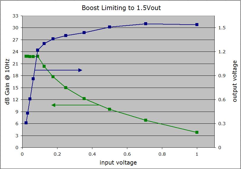

Attached is another plot that shows what is going on with my "boost limiting" circuit. The input was a dynamic burst at 10Hz, with various input levels.
The plot shows the peak output voltage and the corresponding gain (Vout/Vin) for the 10Hz signal, in decibels. At the lowest input voltage, the full gain is available. As input voltage increases so that the output rises to 1.5V the gain is dialed back so that the peak output voltage does not exceed the 1.5V limit/threshold. The 1.5V value is just an arbitrary value I picked and is adjustable via a pot. This kind of response to varying input levels is useful for not driving the amp into clipping, which would result in lots of audible harmonics and other distortion.
Will follow up with a plot of the variable gain versus frequency later...
-Charlie

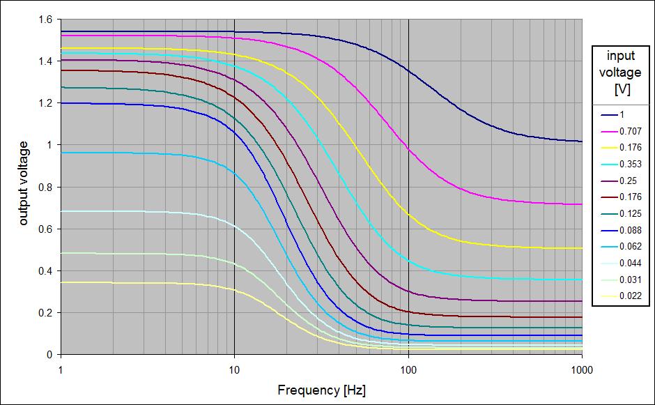

Attached is a plot of the output voltage as a function of frequency for a variety of input levels. As before, this data was obtained on a 10Hz burst input signal, the max level of which was varied. This more clearly shows the change in boost.

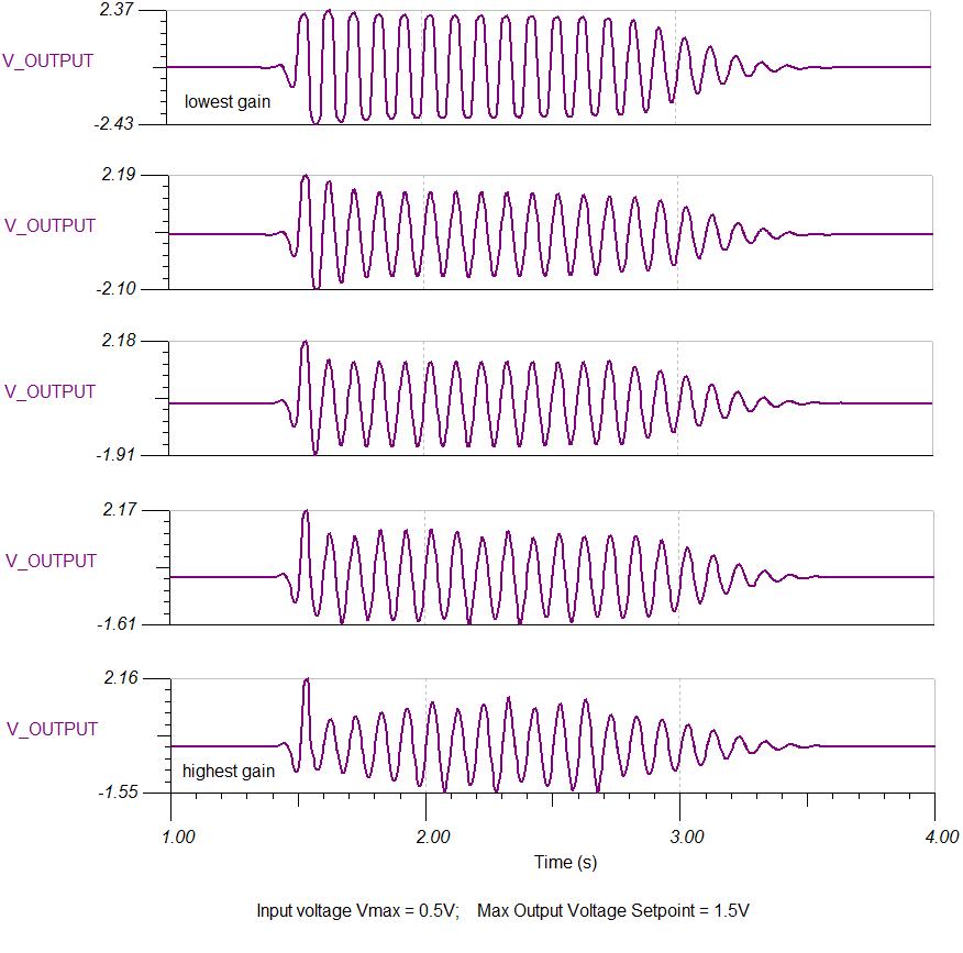

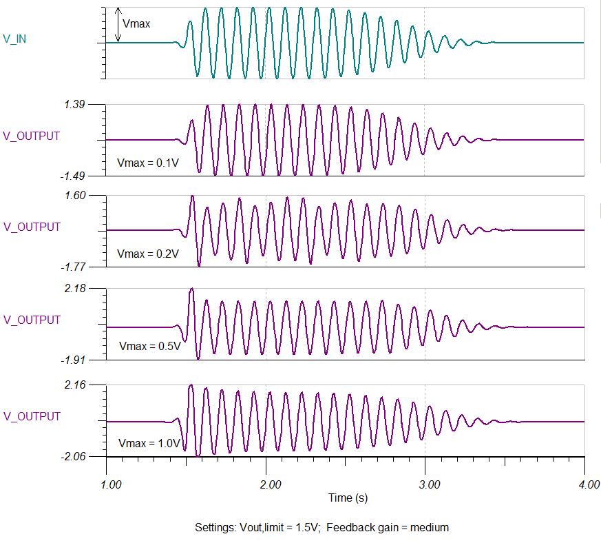

Attached are a couple of examples of the output of the circuit, given a single frequency (10 Hz) "burst" input.
The first attachment shows the response to increasing input level, with a max output level set to 1.5V. Even up to 1V input, when the gain at 10Hz has been reduced from 24dB to about 4dB, the signal shape is still pretty clean. Not shown is the distortion levels, which are about 1% dominated by 3rd order. There is some evidence of pumping for the Vmax=0.2V input level, but this amounts to only about 2-3dB difference in level.
The second attachment shows a range of feedback gain settings for an input level of 0.5V. At the lowest gain setting, the boost limiter is barely working and the limiting is coming from the diode shunt limiter on the output, causing distortion to be about 14%. As gain in increased (moving down the figure), the distortion levels are 0.5%, 1.25%, 3%, and 5% respectively. Pumping is visually evident in the bottom trace. At the same time, there is a tradeoff in the limiting action - the levels increasingly falling within the 1.5V output voltage setpoint. While the trace second from the top has the lowest distortion, output amplitude is greater than 1.5V but less than the level at which the diode limiter is clipping the output. The gain could be increased or the output voltage setpoint could be reduced slightly.
One note - these results are for 10Hz, which shows the pumping effects the most. Higher frequencies have slightly different behavior but I have not had the time to fully investigate it yet.
-Charlie

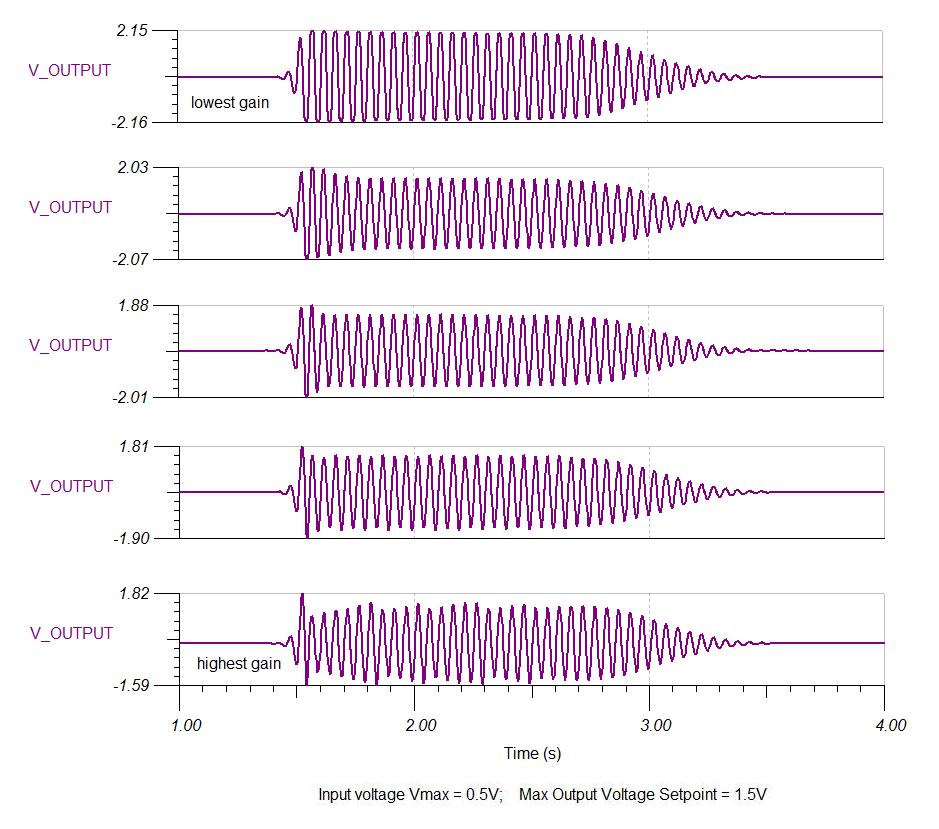

The attached plots show another set of tests I ran, very much like those shown above except that they were done with a 20Hz burst.
The distortion levels for the feedback gain are (from top to bottom) 10%, 0.65%, 0.44%, 1%, 1.1%. This is a very different profile than above. Even when pumping can be seen, the distortion is not high and only the amplitude is being modulated. It's important to realize that the amplitude modulation is not the same for all frequencies, because it is the low frequency boost that is being modulated by the circuit. The high frequency amplitude remains unchanged.
-Charlie
